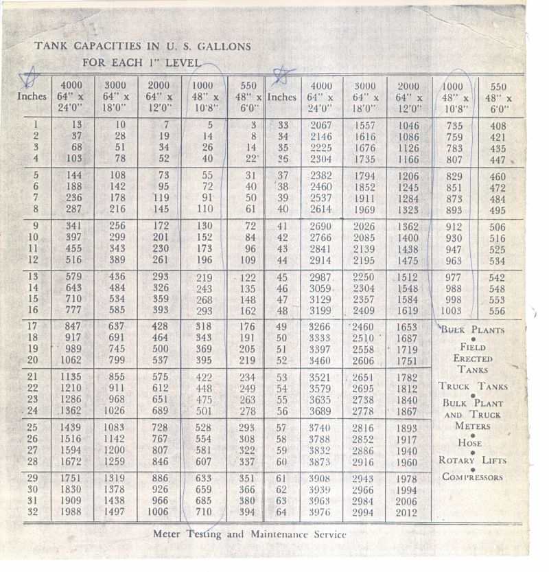

Have a buried 1,000 gallon horizontal fuel oil tank that's 48 inches in diameter.
Looking for a capacity chart so I can determine how much oil is in the tank when I measure it's depth.

Your oil dealer might have a chart too. That is where I got mine back when I had an underground tank. It just has the inches with # of gallons at each level. The cylinder thing would probably work too. As far as I know these big underground tanks are pretty much cylindrical in shape (as opposed to above ground tanks which are often not).
   / Fuel Oil Tank Capacity Chart ? #4
simple answer since I don't know where my chart is.... if you have a half tank, 500 gallons.... after that, you need the chart, because as you get closer to the bottom, the amount of oil diminishes because the sides taper in. I will check tonight to see if I can find my chart.

Attached is a chart.

If it's 48" in diameter and you insert a measuring stick into the tank and the mark the oil leaves on the stick is 12" up the stick you have roughly 250 gallons in the tank, right? If the mark is 9" up the stick, you have roughly 188 gallons.
   / Fuel Oil Tank Capacity Chart ? #7
</font><font color="blue" class="small">( If it's 48" in diameter and you insert a measuring stick into the tank and the mark the oil leaves on the stick is 12" up the stick you have roughly 250 gallons in the tank, right? If the mark is 9" up the stick, you have roughly 188 gallons. )</font>
Nope. Take a look at the chart I attached in my previous response. That chart came from my oil company who installed my 1000 gallon tank. The standard 1000 gallon underground tank is 48"x 10'8".
12" of oil in the tank gives you 196 gallons. 9" will give you 130 gallons. You will need 14"-15" of oil for 250 gallons. I have personally verified that the chart is accurate.

If the tank was a square, you would be correct. The only time that your theory would be correct is at the 50% mark. The sloped sides are what make the difference. I have been looking for my chart for a couple of hours now. I am glad that one was posted, because I believe that mine is permanently misplaced. When I was in the business, we had them all over the office. Now I have none..... /forums/images/graemlins/frown.gif /forums/images/graemlins/frown.gif
