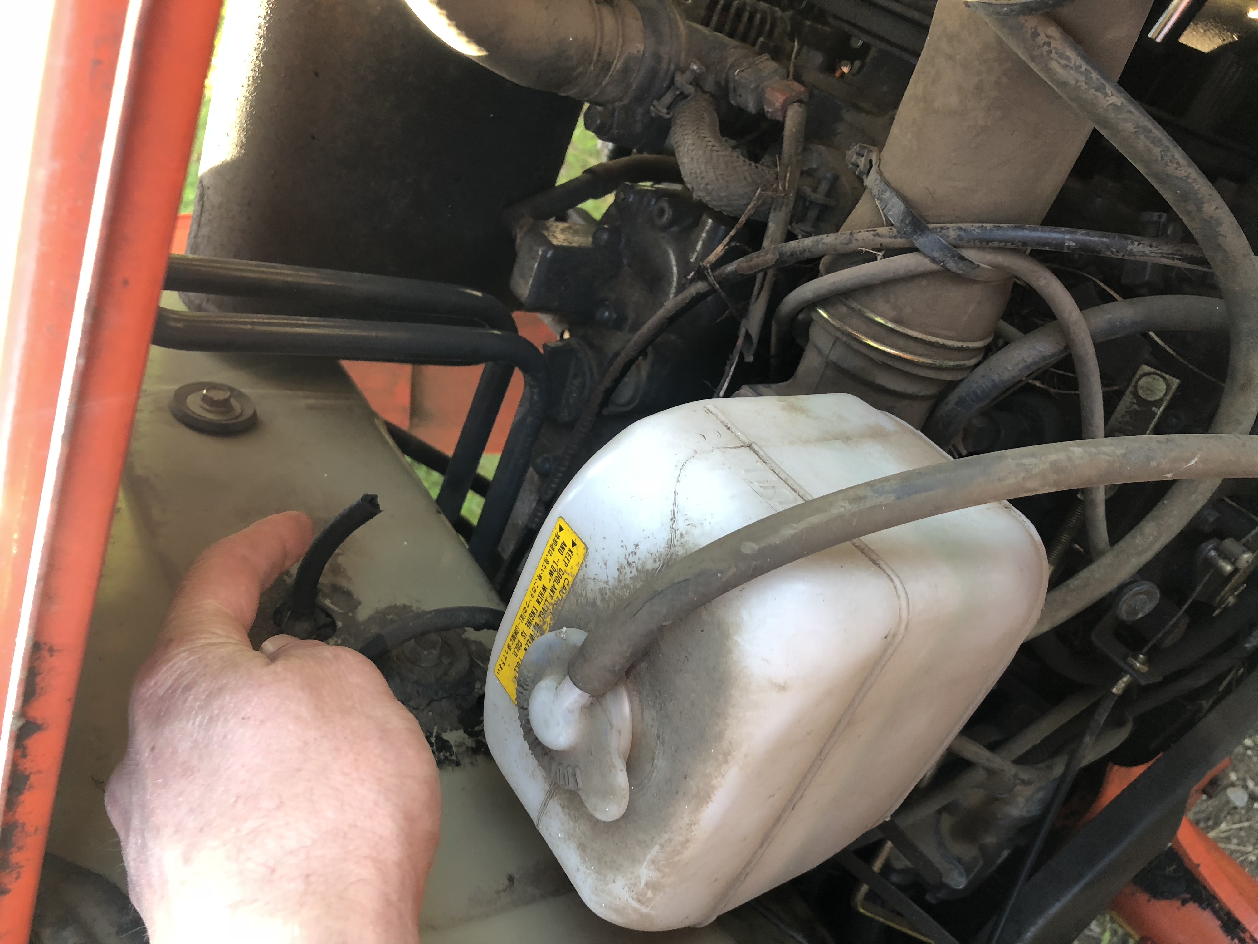

I found a rats nest in my kubota, I was wondering what these fuel lines are for?

Should be a vent line for bleeding the fuel filter, one for collecting injector leakage and usually one for bleeder screw on the injection pump.
