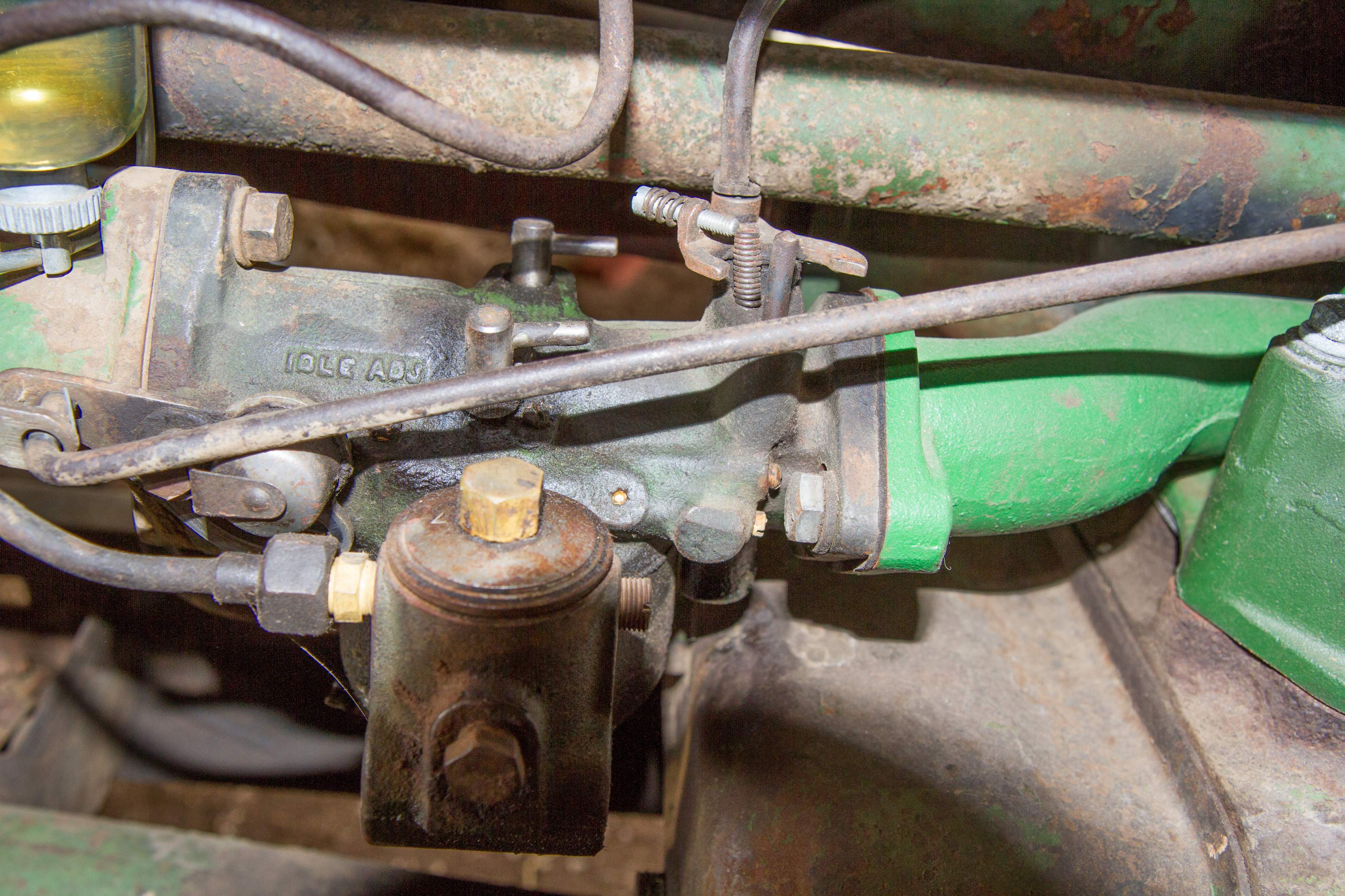

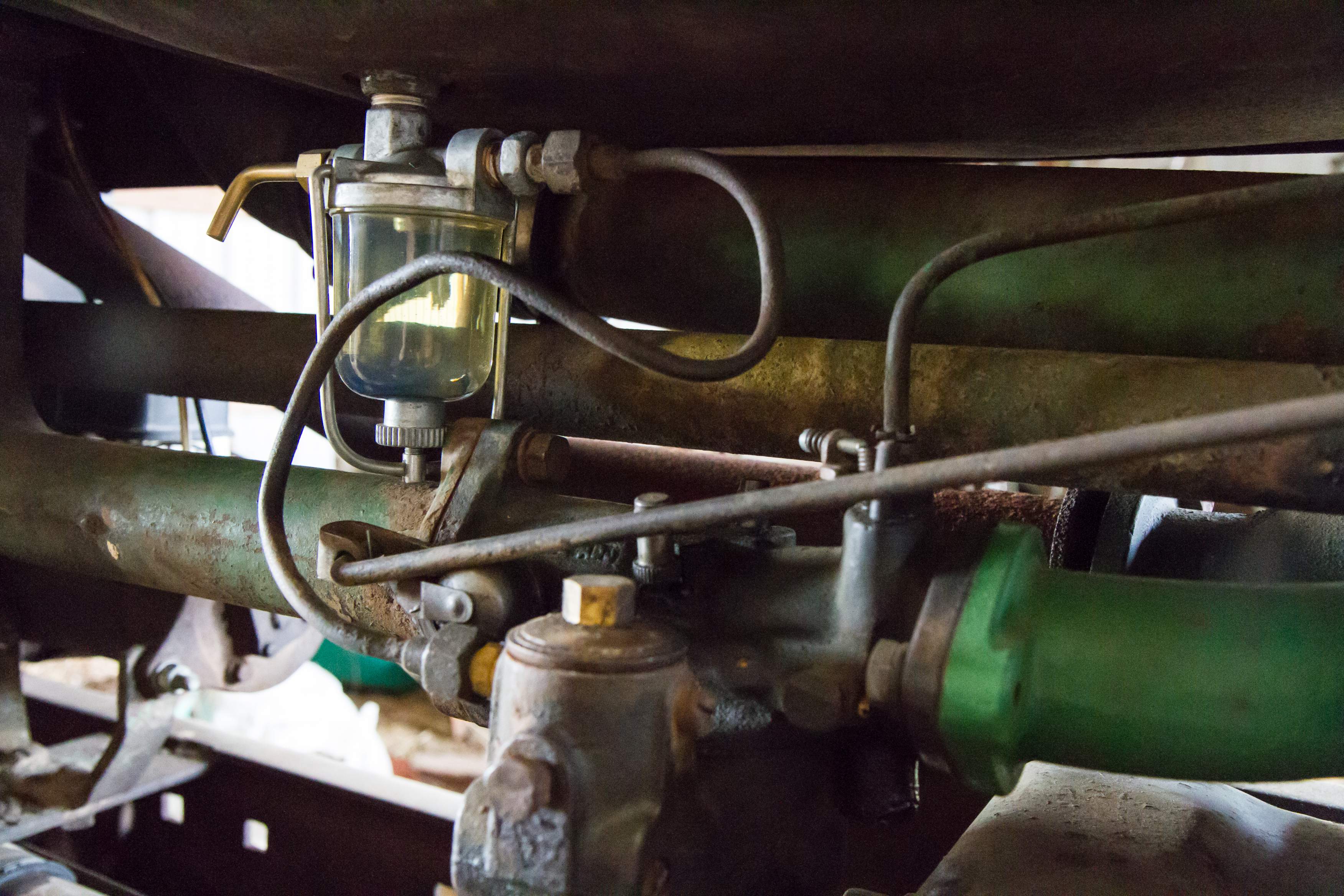

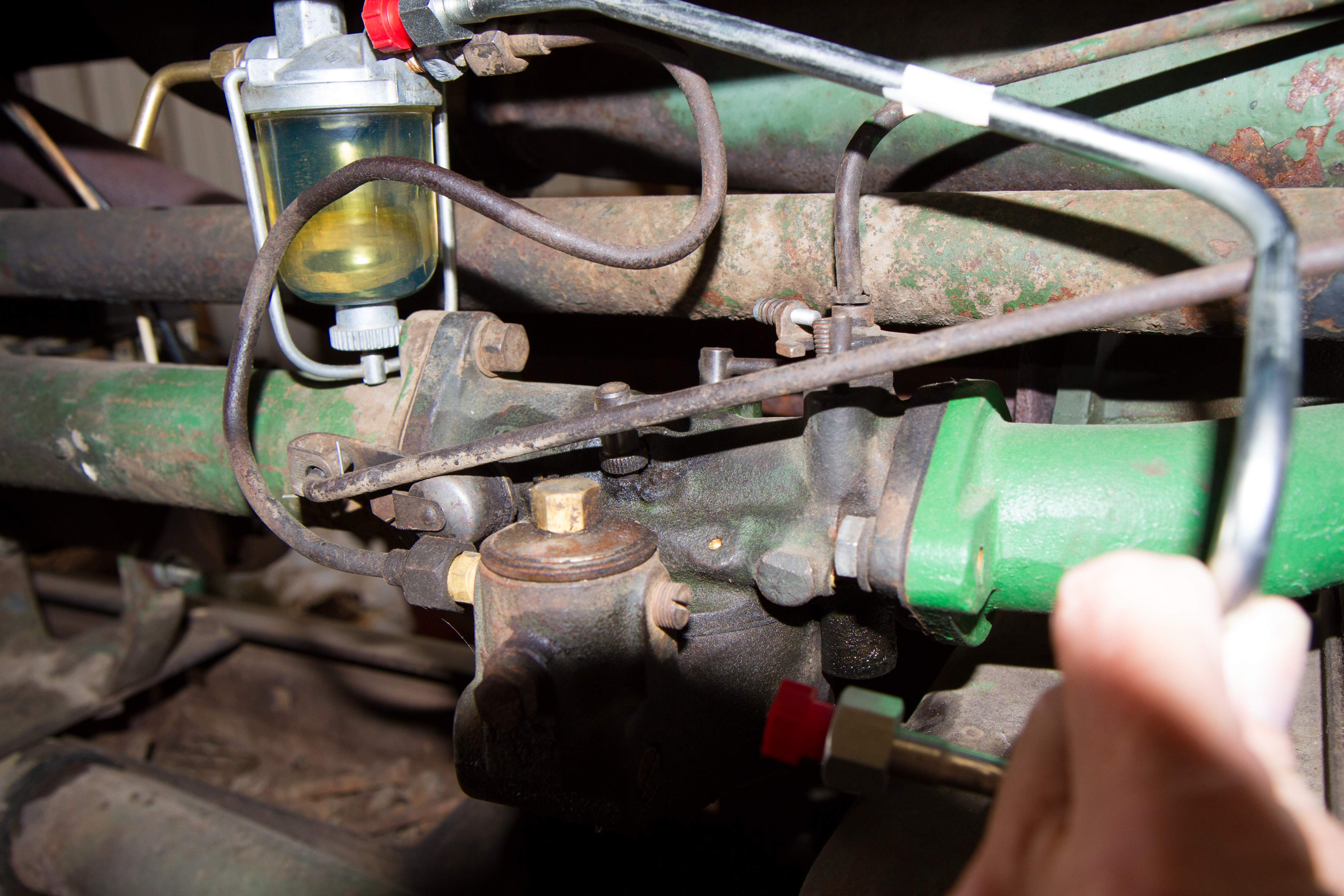

This is the B that my Father-in-law bought in 1949 when he started farming. My wife and I would like to get it running and then painted up nice so that we could run it in local parades. The problem is that it will start first try and then dies out. Part of that problem,I think, is that the fuel line from the fuel bowl to the carb is home-made and has too many curves in it for a gravity flow system. I purchased a new fuel line on-line from Steiner's and it is about two or more inches too long as you can see from the attached photos.
My questions are:
1. Is this the right fuel bowl?
2. Is this the right carb?
3. On the right hand side of the carb is a fitting, if I bend or fabricate a new fuel line, can I attach it to the right hand fitting?
Of course, if anyone reading this sees anything else that is incorrect, please chime in.
Much thanks for anyone who can help with this situation.

Beenthere: Yes I have looked at jdparts.com. In catalog PC330 it shows the fuel bowl oriented 180 degrees differently than the orientation of the one mounted on my tractor. I will rotate mine and see if the new fuel line will mount that way.

Idle should be about 1 1/2 turns out and the load about 1 turn out.
float level should be about 1/2" from the bowl to the top of the float when you tip the whole thing upside down.
Open the drain on the bottom of the bowl to check for good gas flow after it dies.
There is a brass filter screen under that brass bolt where the fuel line goes in
Carb should be a #67 or 73 for the serial number others will certainly let it run ok
It may have a rebuild kit in it but it doesn't look like any of the brass screws have been removed recently, only way to clean the passages is to get a wire through them.
