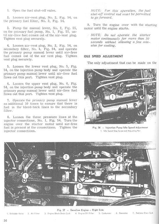

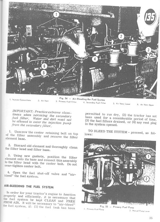

Well, that 245 has the 3-cyl Perkins diesel like my 1964 MF135. So I guess the same procedure applies
Hope this helps. Good luck.

I think that might do it but can't read the print. Is there anyway to e-mail the pics and I think I can increase the size?
Thanks for the answer, the system looks close to mine but I don't see but one filter under the pump. I tried bleeding and got some air out but still have to locate the injectors.
Thanks again

I clicked on the link he had and the picture came up and I was able to click on it again to enlarge, try that.
