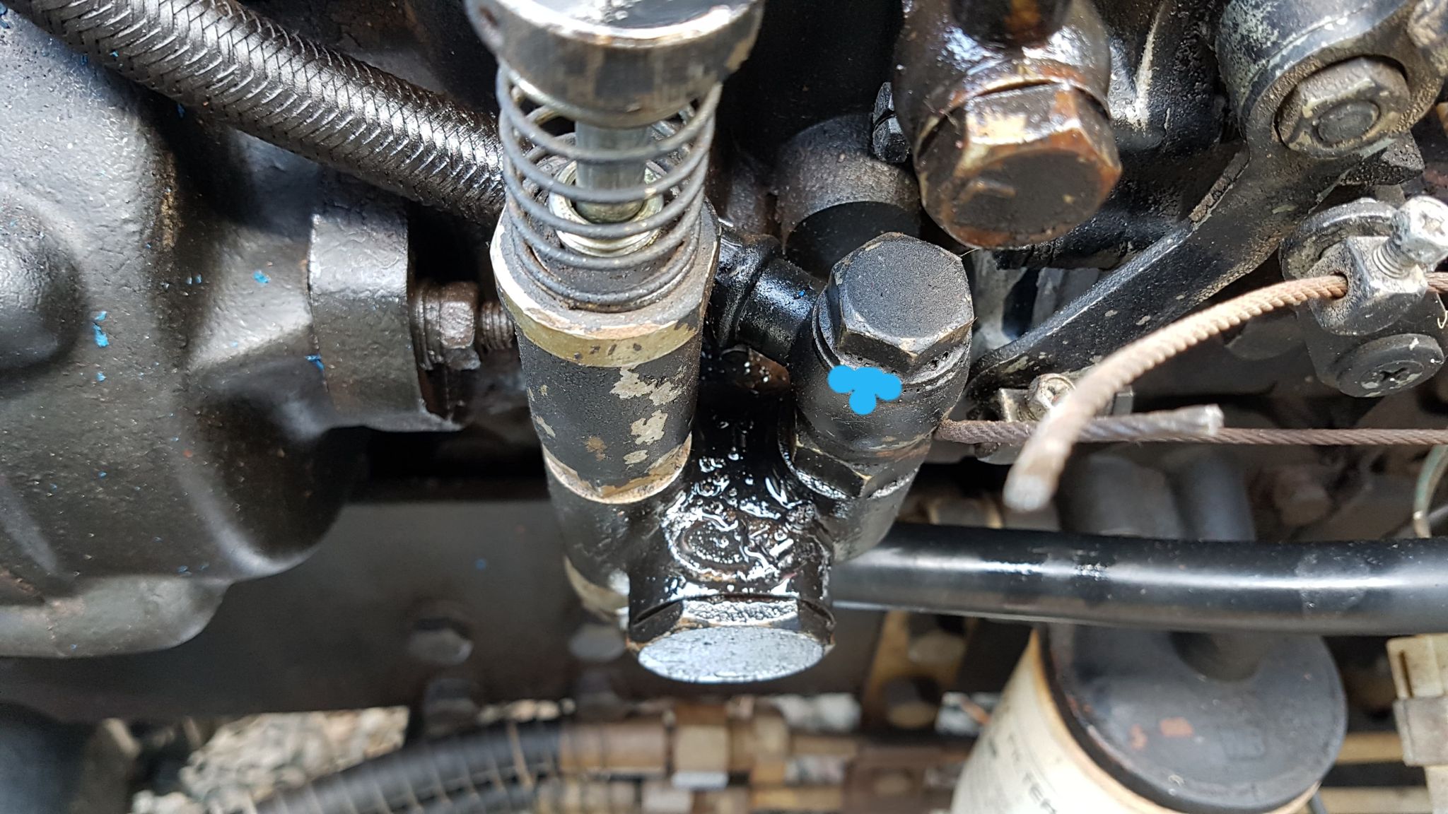

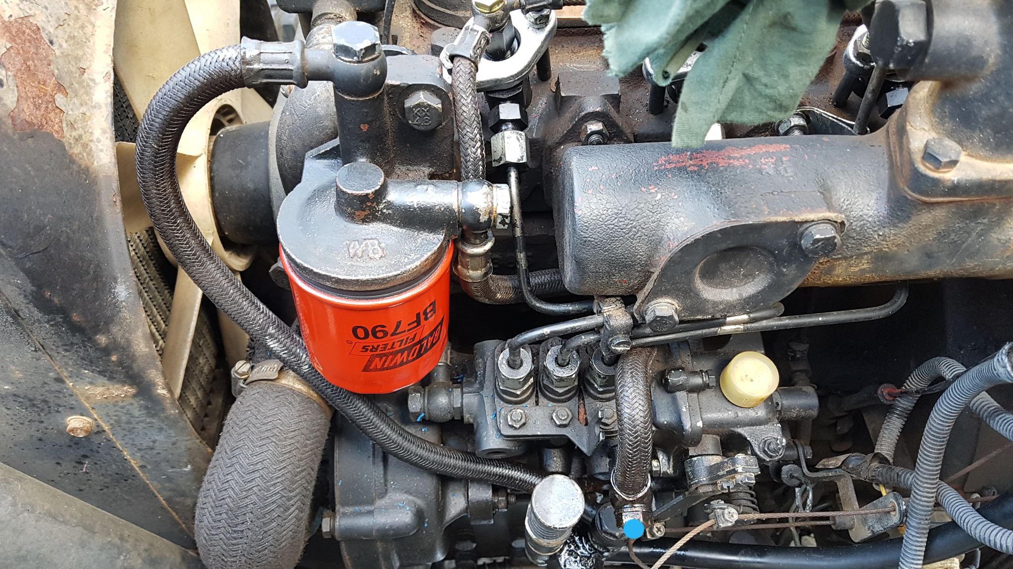

Hi everyone,
I went to bleed my new injectors and have found 2 fuel lines leaking where the crimp is on the banjo bolt fittings. 1 line is from the injector pump to the fuel filter and 2nd line is from fuel filter back to injector pump
I've read some threads on this forum and have seen other's say that they have carefully cut the old metal crimp off and then used some stainless steel band clamps/hose clamps to re-attach the fuel line to the banjo fitting.
Is this something I can do on my Jinma 254?
I've attached some images showing where the leaks are.

Most certainly. And in fact, you don't even have to remove the ferrules. Just slit them along the length in four places, like 12 o'clock, 3 o'clock, 6 o'clock, and 9 o'clock and securely tighten down a quality hose clamp over the ferrule. Done.
   / Fuel line leak #3
Yup, Bob is right. These are low pressure lines. This is what I did when I replaced the mechanical lift pump with an electric pump. The ferrule is the permanent clamp that holds the rubber hose on. Cut that (or remove it) and it releases the hose for easy replacement.
   / Fuel line leak #4
A bucket of "Likes" to you Piper. I should have mentioned that you can use a hacksaw or Dremel tool to slit the ferrules. Make sure no metal particles get into the fuel system. It can never be clean enough.
