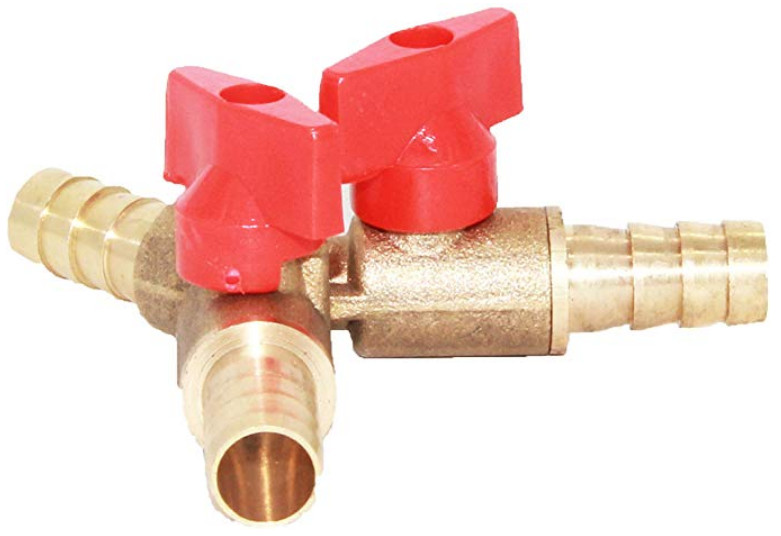

I know it's an older thread but just in case someone is having the same problem, mine did the exact same thing. I ended up using Hot Shot's Secret Diesel Fuel Additive in my fuel. That and putting a tee and valve in the fuel line between the fuel filter bowl and the tank I got a brass tee that included the valves. The reason for the tee was for when the tractor came to a stop a half mile from home, I can turn the fuel off, and blow the fuel between the filter and tank back into the tank. It dislodges the algae clogging the fuel line at the bottom of the tank and the fuel will run freely again. Eventually the Hot Shot's additive kills the algae and it becomes hardens up into little pieces that will make it through the hose into the bowl. Keep a few filters on hand for the next couple of weeks for the dead algae that comes out of the tank. Worked for me last summer.
Here is the 5/16" tee I used:
