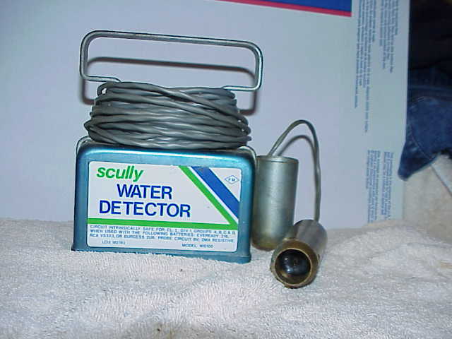

Does the filter have a water drain at the bottom? I know that the NAPA filter does. If I remember correctly, it is a 3/8" pipe plug type of affair. I guess that you could change it over to a radiator type of drain plug if you were so inclined. I don't have water in my tank, so I don't need that. Here is how I check for water electronically. I drop the probe into the tank and if there is any water at the bottom, it will sound an alarm. Not bad for a device that is so old that I can't even remember when I got it. /forums/images/graemlins/grin.gif
