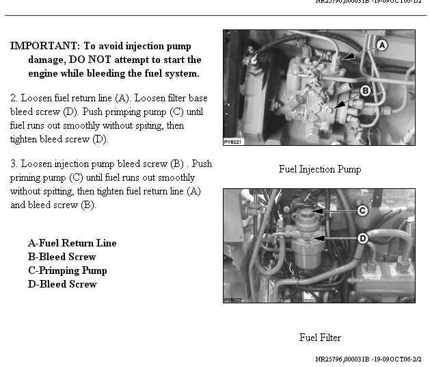

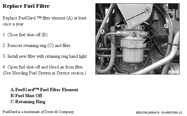

Aug 14, 2010 / Fuel Filter ? #1 R redka Silver Member Joined Feb 27, 2008 Messages 204 Location Middle GA On my JD 5403, I have not changed the fuel filter yet, but when I do is it necessary to loosen and bleed air from fuel lines? Where to bleed it at? Or can I just change the filter, crank up and go? Thanks.
Aug 15, 2010 / Fuel Filter ? #2 9 9973720wb19 Platinum Member Joined Jan 1, 2010 Messages 811 Location East Coast Tractor Many I have a 3720 and the fuel lines will self bleed when you crank the engine after changing the filter.

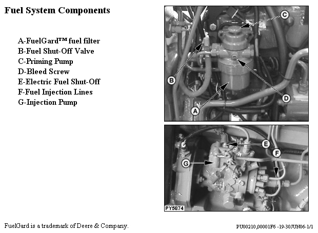

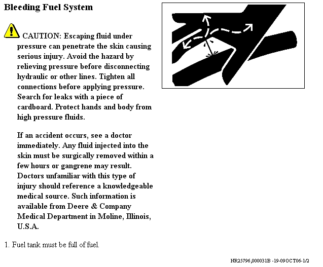

Aug 15, 2010 / Fuel Filter ? #3 JD755 Platinum Member Joined Aug 16, 2009 Messages 919 Location Kansas Tractor John Deere 755 purchased new in 1993 The 5403 operator manual does show a requirement for bleeding the lines. http://manuals.deere.com/omview/OMRE268160_19/?tM=GC Attachments 5403 fuel filter.jpg 125.9 KB · Views: 145 5403 bleed.jpg 170 KB · Views: 139 5403 fuel.jpg 134.4 KB · Views: 122 5403 fuel 1.jpg 134.1 KB · Views: 138
