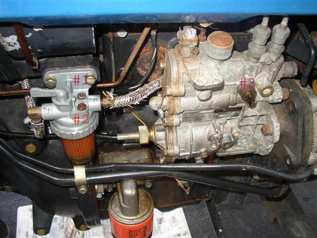

I replaced the fuel filter and that was extremely dirty. I have about 20 hours on the tractor since I purchased it last fall. 900 hrs total.
No problem removing the filter and putting in the new one. I filled the bowl up with diesel fuel and tightened the top. Ran the tractor for 20 seconds and it died.
Opened up the first bleeder (closest to the fuel tank) and waited until just fuel came out. Tightened it up. Opened up the 2nd farther out from the fuel tank and waited till just fuel came out.. tightened it up.
3rd one.... I believe this is the correct one since fuel did run out. Opened up and after a bit tightened it.
It just won't start, I'm not sure if I flooded it... can you flood a diesel?
Here is a photo with each labeled 1 2 and 3.

Don't think so.
Try opening the fitting at each injector while cranking. You're on the right track - just need to get rid of the air above #3.

I assume the injectors (2 of them) are at the top with the metal hose running between? I'll try that tomorrow.

Sounds like you need to go all the way to the injectors with your bleeding. Crank for a while and then bleed.

Still no luck after bleeding the 2 injectors. Tried it both while cranking the engine and with the engine off. All bleed screws including the 2 injectors flow fuel fine with no air bubbles. Tank is full, battery is dying so I'm charging that right now.
Any more ideas?

Tried starting fluid in the air intake with no luck. It sounded like it would start and then goes back to nothing... just cranking.
