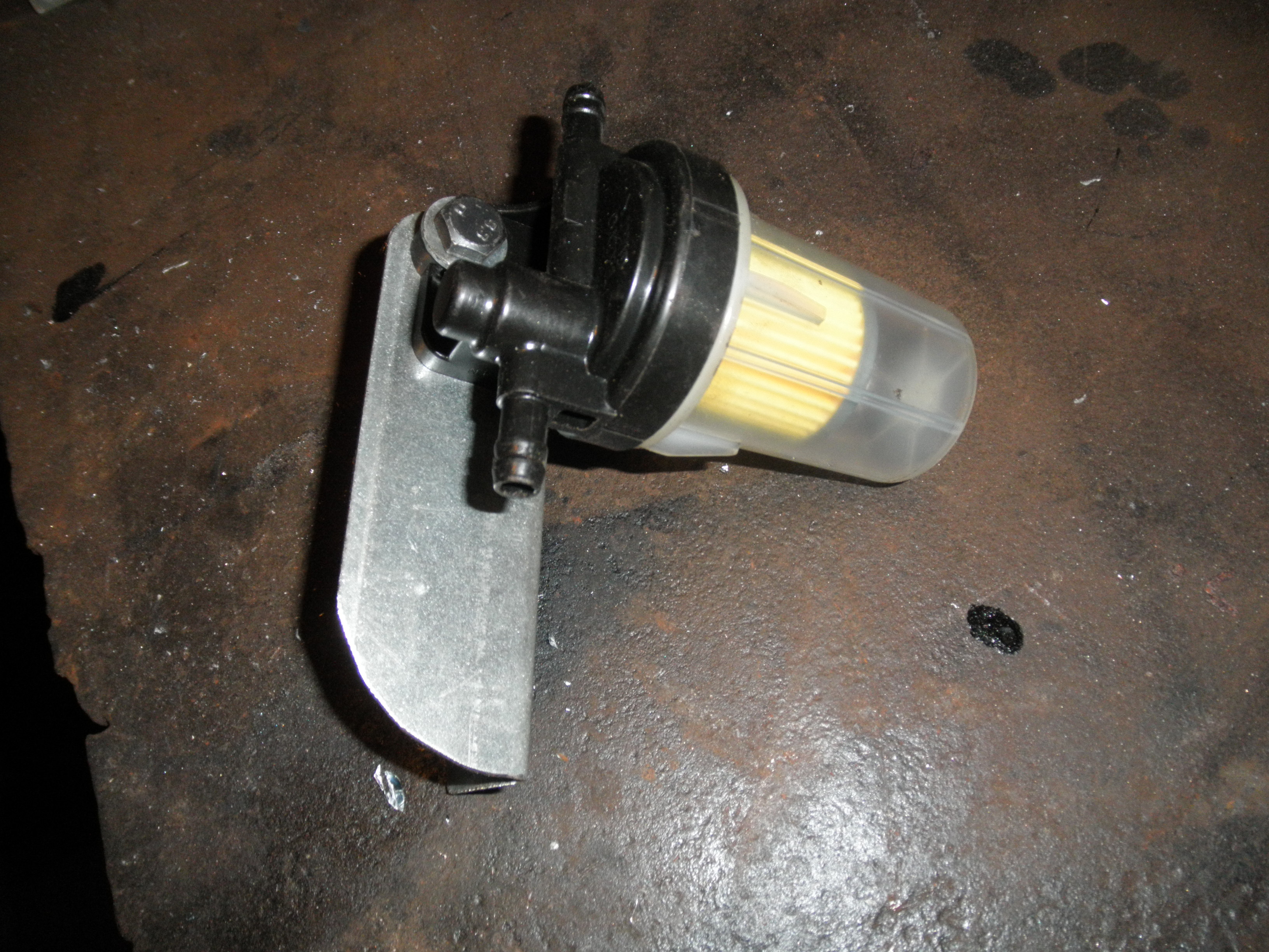

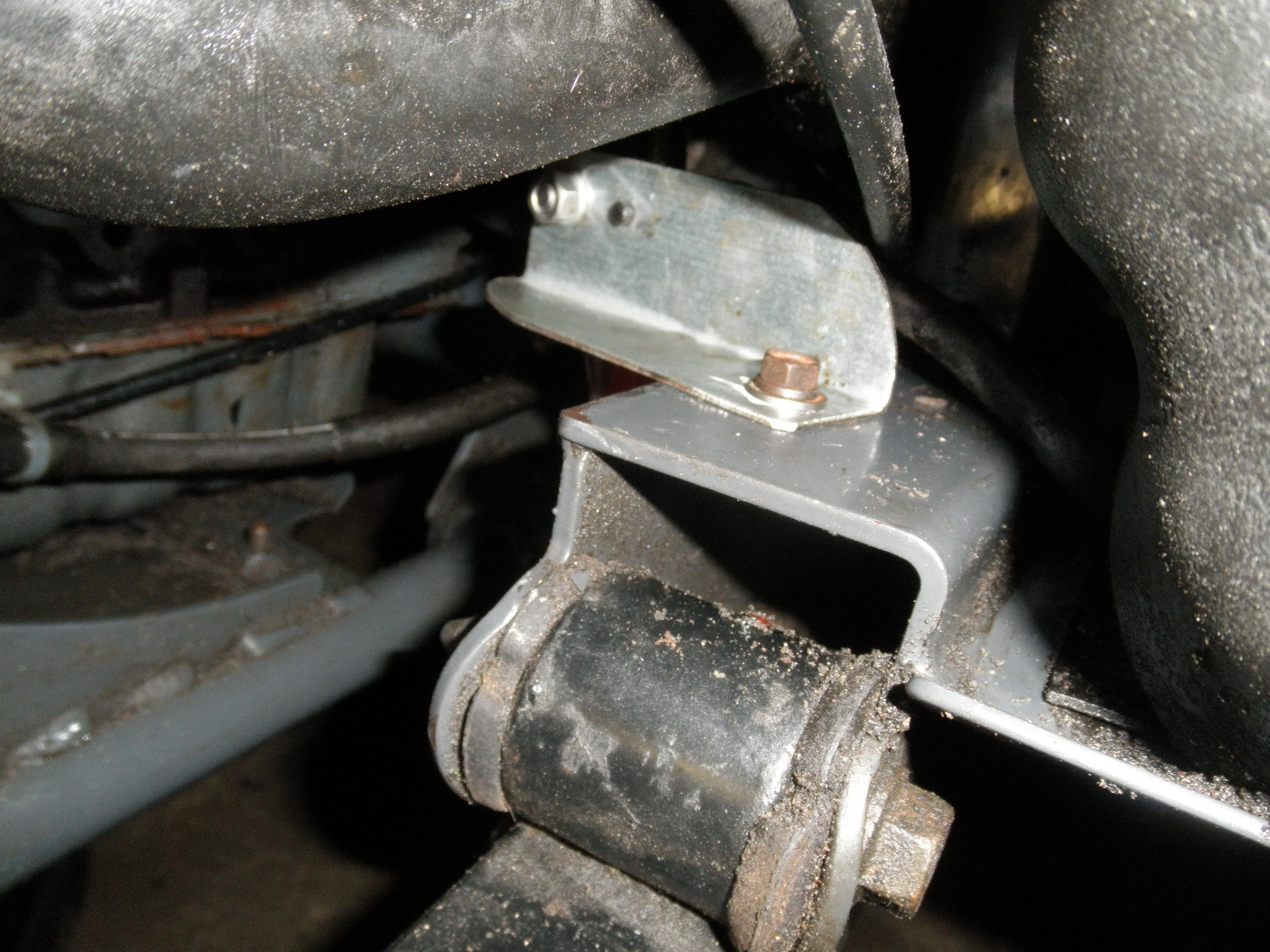

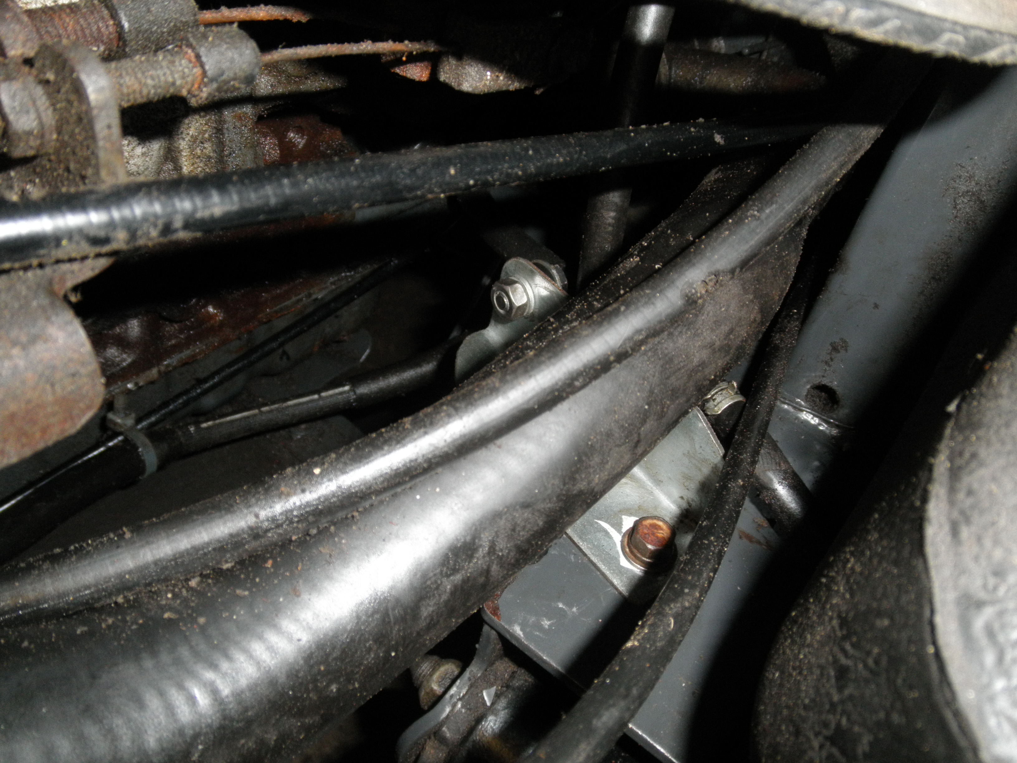

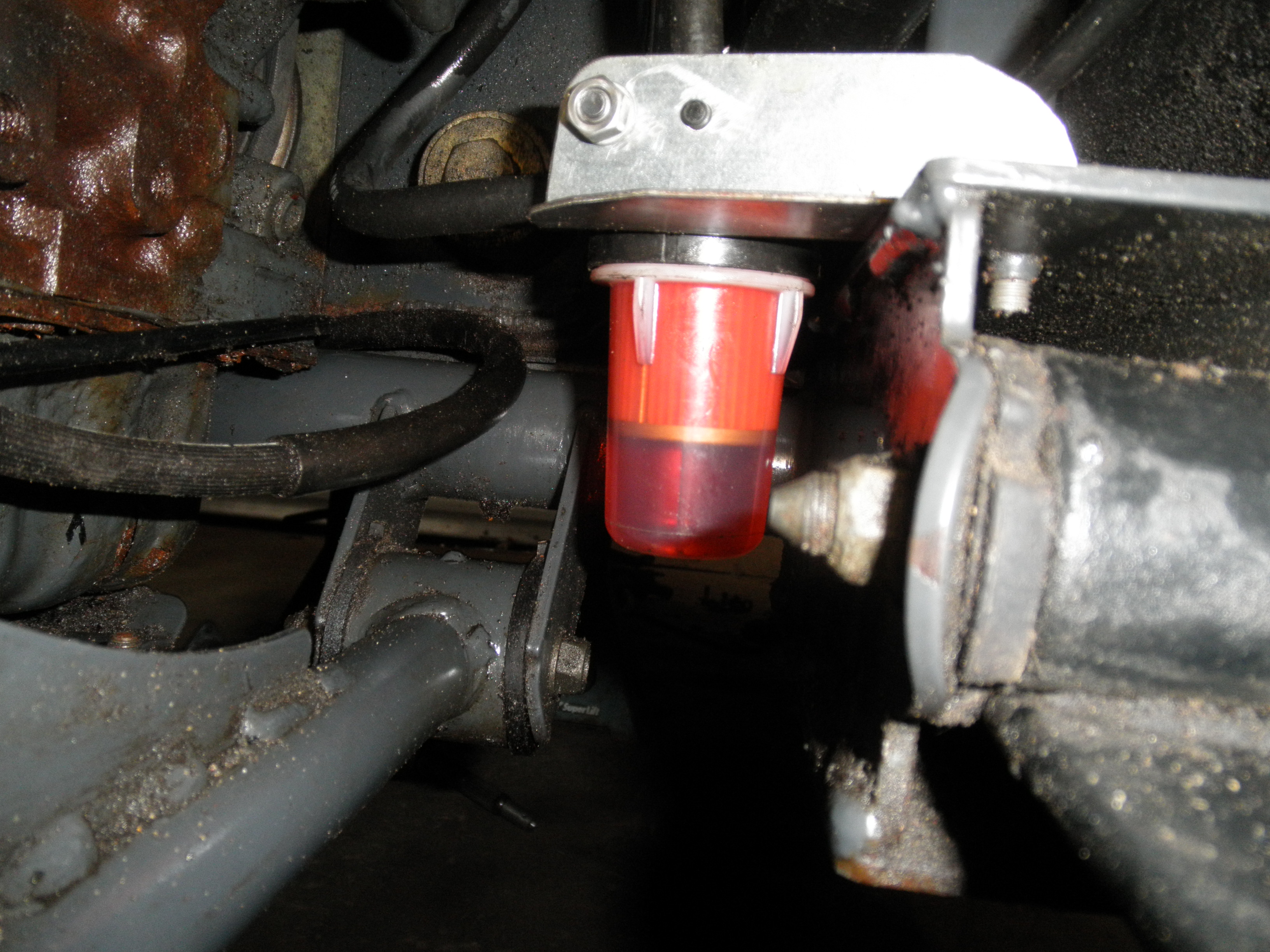

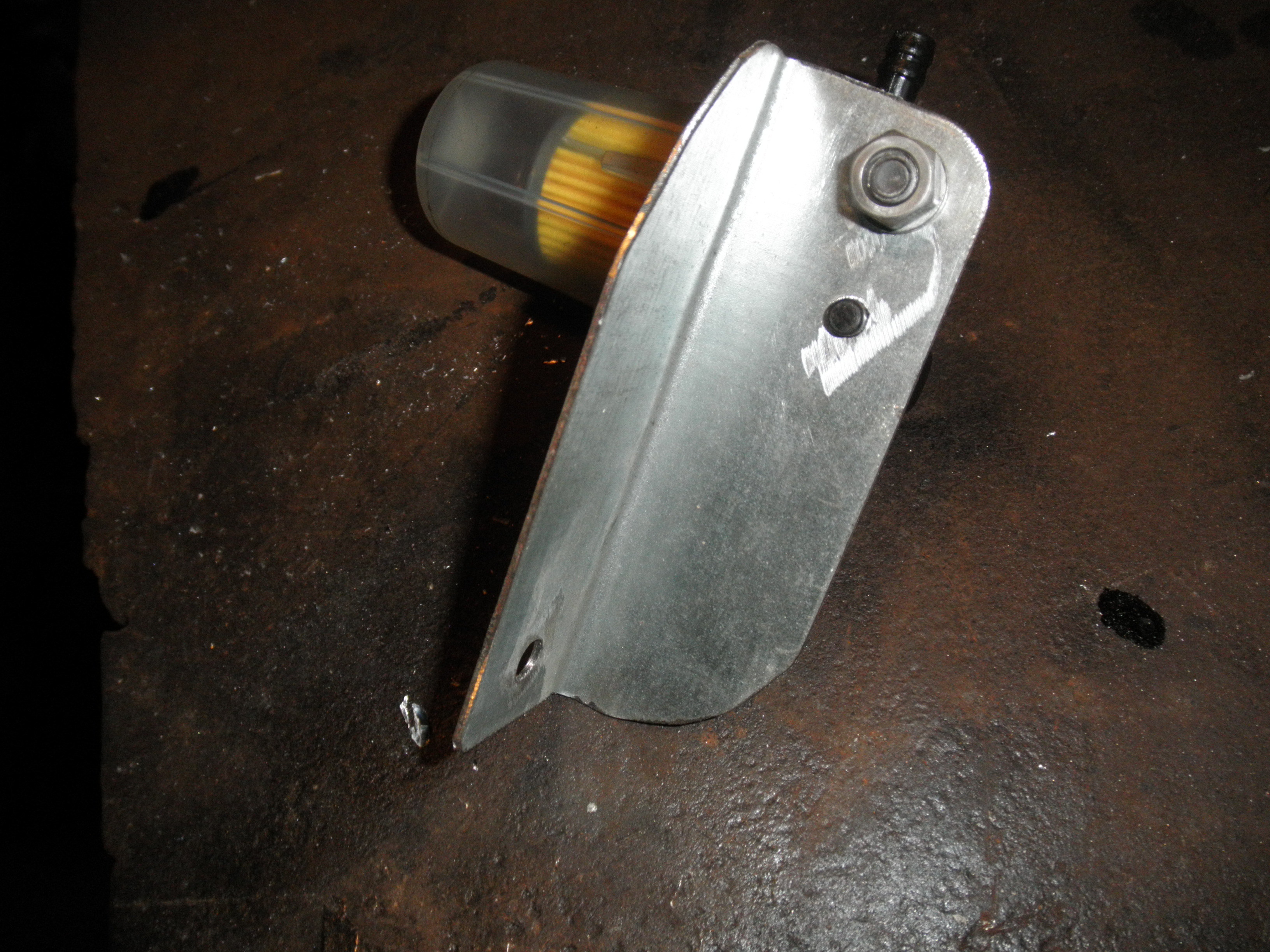

I installed a bowl type filter on the RTV since I didn't care for the in-line filter. I made the bracket from thin angle rounding off the corners. I used a 6A320-58862 filter. I mounted it to the rear tapped hole on the frame. The filter has a third hose fitting in the center which I ran up to the top of the fuel tank, there is a capped off fitting to which I attached it to.
