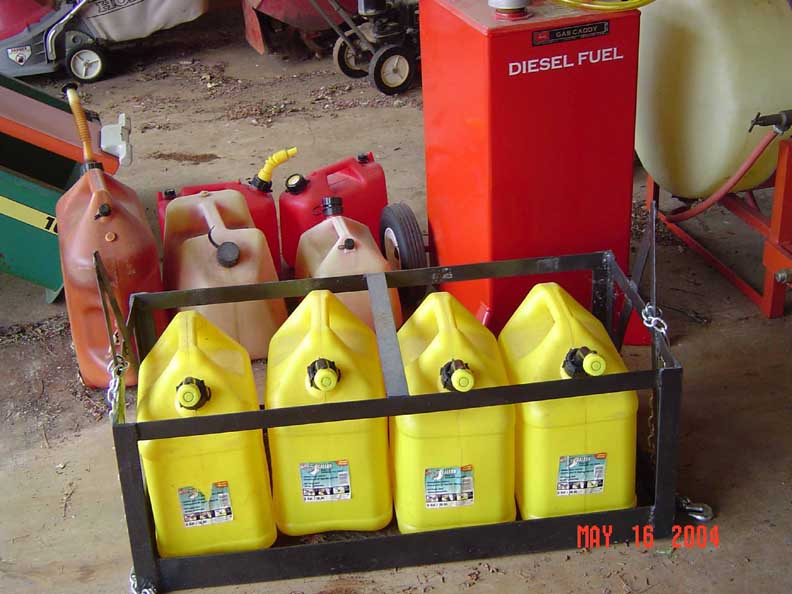

You've got my sympathy, I was in the same position over a year ago. My back was giving me so much trouble that I couldn't lift 5 gallon fuel cans to fill the tractor. In the end I actually got a fuel caddy from Northern Tool. It's good but you're right, it was expensive.
That's only part of the problem though, you have to get the fuel into the gas caddy. I built a carrier for 4 x 5 gal fuel cans. It's not pretty but it is effective. The short chains and hooks at either end attach to the lip of the FEL and I use the tractor to load and unload the carrier on to the truck. I use the 2-way pump on the caddy to suck the fuel out of the cans and then to transfer the fuel out of the caddy to the tractor. A cheaper way would be to use a 2-way pump and a 55 or 30 gallon drum. The carrier was made out of pieces of metal I had laying around but using the FEL to do the loading and unloading means that there is no physical lifting involved. My back is a lot better now but this arrangement was a lifesaver at the time.
