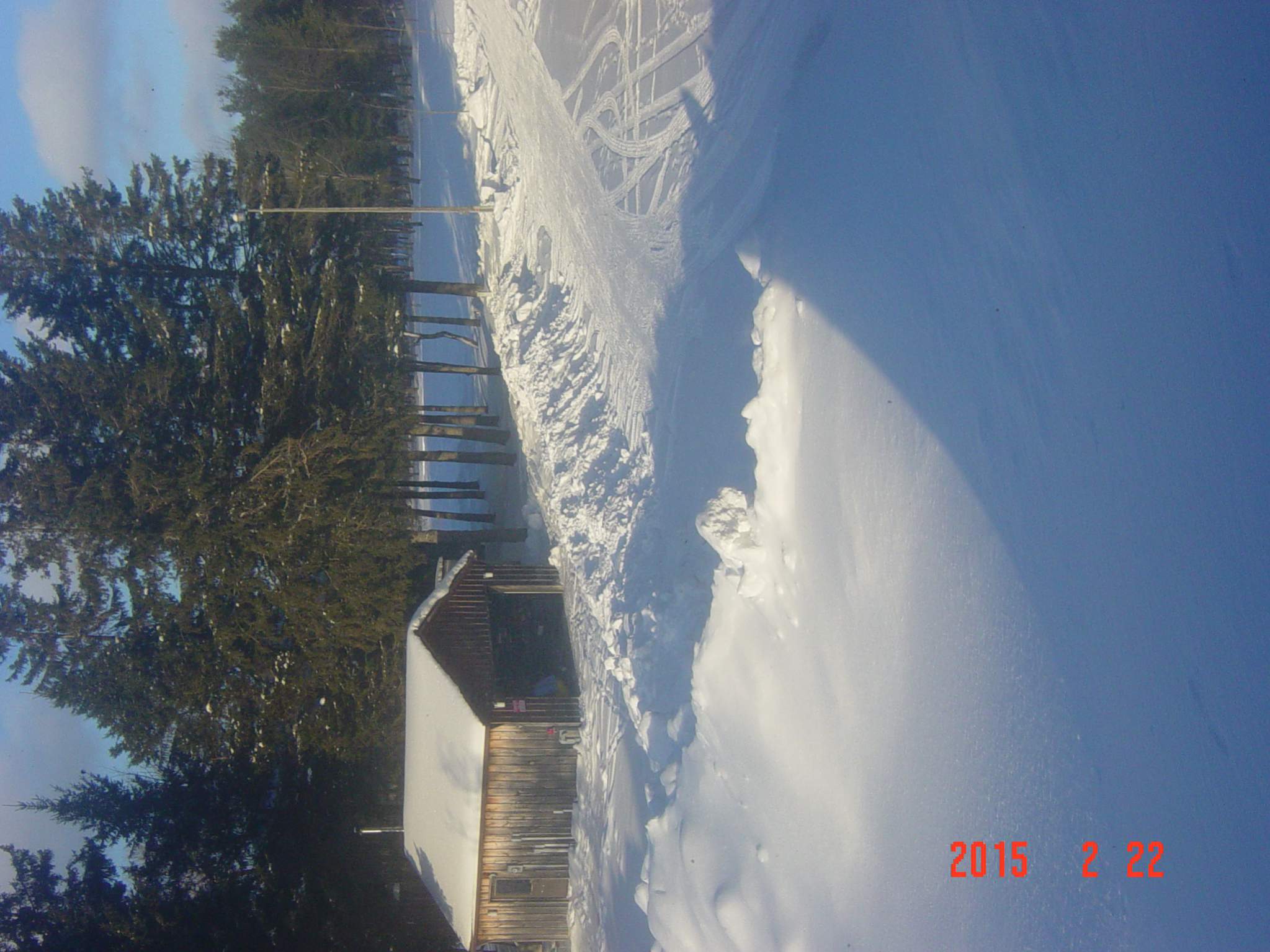

A pic of my attempts to provide some sort of a "warm" snow blankie! A picture may help to set the scene better. It's the mound that runs in front of the garage. I guess the concrete pad extending out from the garage does not help, and I wonder how much of that I should cover. This mound, now denies me use or even easy pedestrian traffic to the garage.
If I knew it would work in a couple of weeks, I could live with that. I might get a garden hose to run from the pump house frost free tap to the house frost free tap, over top of the snow, just to take showers or do laundry, then blow out the hose with air.
The outside temperatures are STILL unusually bitter, and I wonder how much effect that will actually have with the line now covered.

Your snow cover is working against you now;helping to keep it frozen.Only way is with heat;I would tent the area and put some heat on it ;after it thaws a blanket of hay/straw will help insulate the ground.
