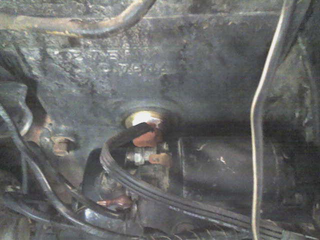

I got my frost plug installed. Now there's one problem...
It leaks!
I took everything apart again down to the frost plug and loosened the bolt and moved it around again to make sure it was in place. I tightened it back up and the leak seemed to stop. Then after I started the tractor it leaked again.
So here are my questions...
After a frost plug heater is installed, is it a bad idea to take it back out again to look at it? I don't know if the wings inside will bend back the right way or what.
Is RTV a bad idea in an application like this?
I'm pretty sure that I got the right size. I measured it four different ways and came up with 1 9/16" or 40 mm every time. It was a pretty tight fit getting it in too. I put clean antifreeze on the O-ring before I installed it.
What could have gone wrong? What can I do to fix it?

The o-ring actually makes the seal. the heater should fit snug in the hole and you need to lubricate it before you push it home. I would recheck the o-ring to see if it might have been damaged if it is still leaking.

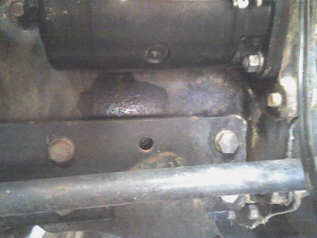

Here are the pics.
I still haven't taken anything apart yet. I decided to pull the tractor into the garage to make it easier to work on. I had to clean the garage before I could pull it in.
Hopefully today after I get off work I can get back into it.

Just out of curiousity, did you use some light emery paper on the inside of the hole before installing the plug ? There could possibly be some crud or a small amount of rust that is causing that weeping condition.

I agree with the other post, that you will have to remove it totally and use emery paper to smooth out the bore of the frost plug hole. You should also smooth out the chamfer (tapered edge) going into the bore. It needs to be as smooth as a baby's butt or it will cut/slice a piece of that o-ring off (leaving a flat spot that won't seal). I believe that this may have already happened. Take a really good look at that o-ring if you plan to reuse it. One more thing; if your block heater has the wingnut style that goes inside the block and an allen-head machine screw to tighten it up, then see if there is another smaller wingnut piece of metal that fits inside the bigger wingnut. "Kimshot" block heaters use this style and I know from experience that the "two piece wingnut style" must be inside one another or they can blow out when hot and under pressure from the cooling system. Also, If the big wingnut is bent(concave) you need to straighten it before reinstallation. I hope this helps and I haven't confused you too much.
/ Frost Plug Heater Installation Question #12
Your best bet is to remove the block heater, but a wire brush in your drill and clean the bore and chamfered edgeof all rust and paint. Replace your o-ring, lub it with liquid soap and reinstall into block. Make sure you index the heat correctly so as not to have your heat element contacting the block and tighten the screw. There is no need to use any sealer and using it can cause a leak in the future. I have had to repair several over the years due to RTV being used on the o-ring and it kept the o-ring from contacting the block.

Can you see exactly where the leak is? Is it possible that the heater itself is leaking and not the area that you are trying to seal?
I can't imagine that as many times as you have installed it that it would still leak.

It's hard to see what's leaking down in there. Things are so tight that I can hardly see the heater when everything is put back together. Thanks for the tip, though. I hadn't thought of that. There could be some kind of leak out the tightening screw or something like that.

If I shut her down and take the starter out (done it three times now) everything back there is all damp and I still can't tell where the leak is coming from.
I think I've got it now, though.
Last night I tore into it again. This time the double wing nut mechanism bound up as I was taking it out. That made it tough to get out, but in the end it was a good thing since I got a look at what had been happening.
It appears that the first three times I re-installed the heater I didn't get the wing nut mechanism all lined up right and when I tightened her back down, the inside wing nut got out of alignment with the outside wing nut. The result was that the outside wing nut never really cinched up tight against the wall of the engine block.
I've already polished the inside surface of the frost plug hole, but I wiped it down real good with a rag last night to make sure there was no grit stuck in there. I put a new O-ring on, put blue RTV between outside of the block and the lip of the block heater (not on the O-ring itself), and I put RTV around the place where the bolt passes through the heater. I re-bent the double wing nut mechanism to look like it does when it first came out of the package. When I got it all tightened down this time it really felt solid. I decided to let it sit for a day for the sealant to cure before re-filling the radiator.
