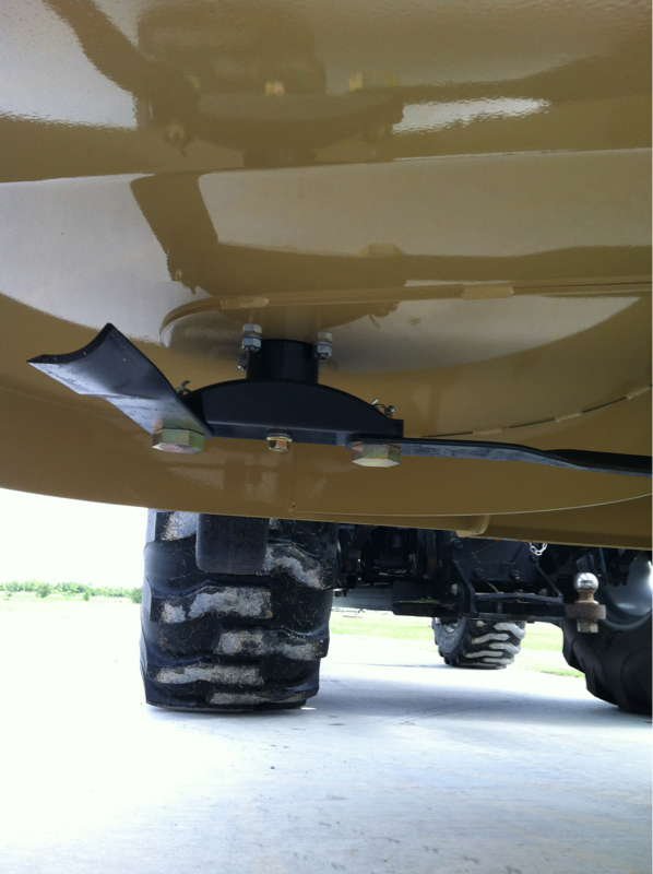

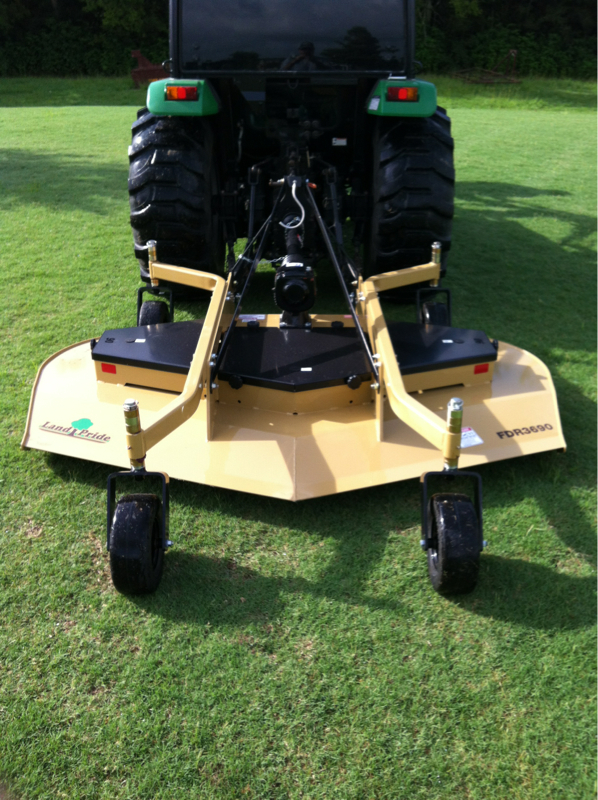

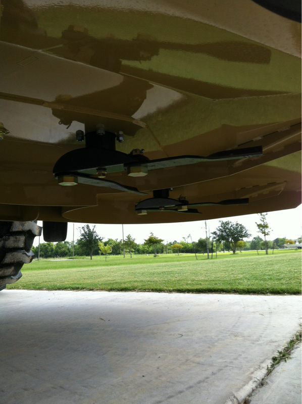

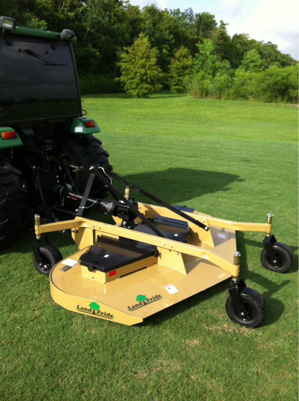

   / Frontier GM2072R discharge #5
I have upgraded to a Land Pride FDR3690 finish mower. It cuts good and even in heavy grass it will throw out the cut grass well without wind rowing. It has a swing blade design and baffling to help with a even discharge of crass clippings. Now, my older 72" LP mower will will wind row some, but not too bad.
Nice set up. I did some tweaking to my set up today. Seams better. Thanks
