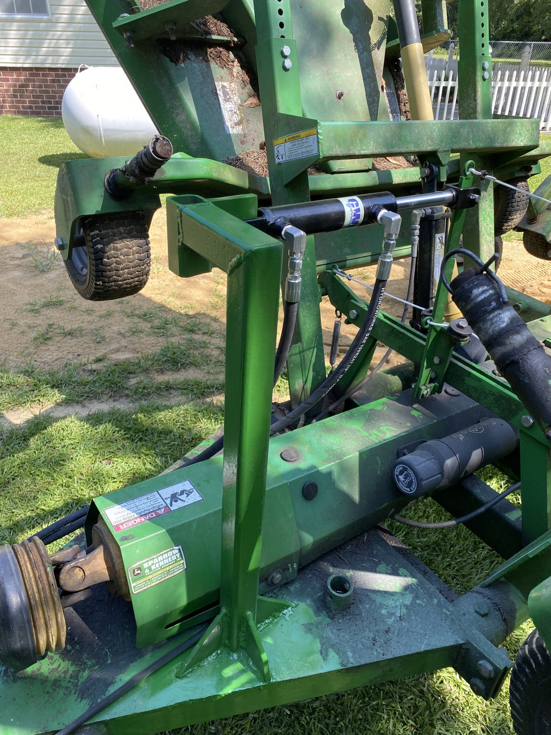

These mowers, or at least mine came with a pull cord to release the 3 decks to let them down. That was quite good as long as I had my 5310 open station. It doesn't work with a cab. I could never find the Bestco kit to install on it and could never even get a pic or drawing of it so I made my own. $100 for the cylinder, $62 for high pressure fittings and $50 for hoses. I have a couple more things to do to it but this is how it turned out. I need to pressure wash this thing.

Nice job, looks good.
