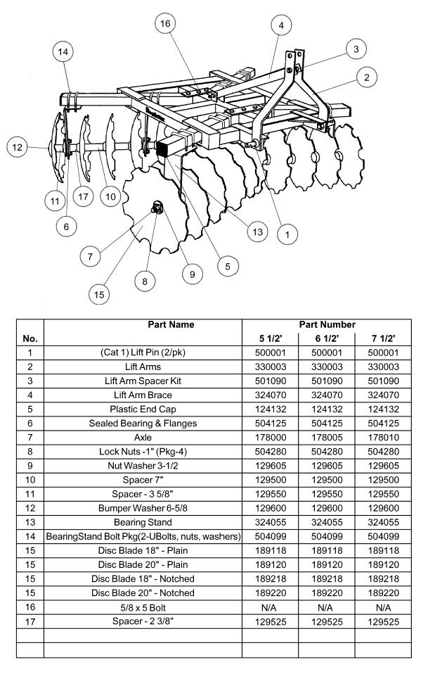

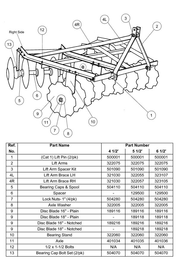

King Kutter has a good online ordering system for parts. I have ordered parts through them and they were very responsive. I have attached their exploded parts views.
http://www.kingkutter.com
Howse has good exploded parts views online but I have found ordering parts through them to be a nightmare.
http://www.howseimplement.com/html/ltr_series.html
http://www.howseimplement.com/html/disc_harrow.html
