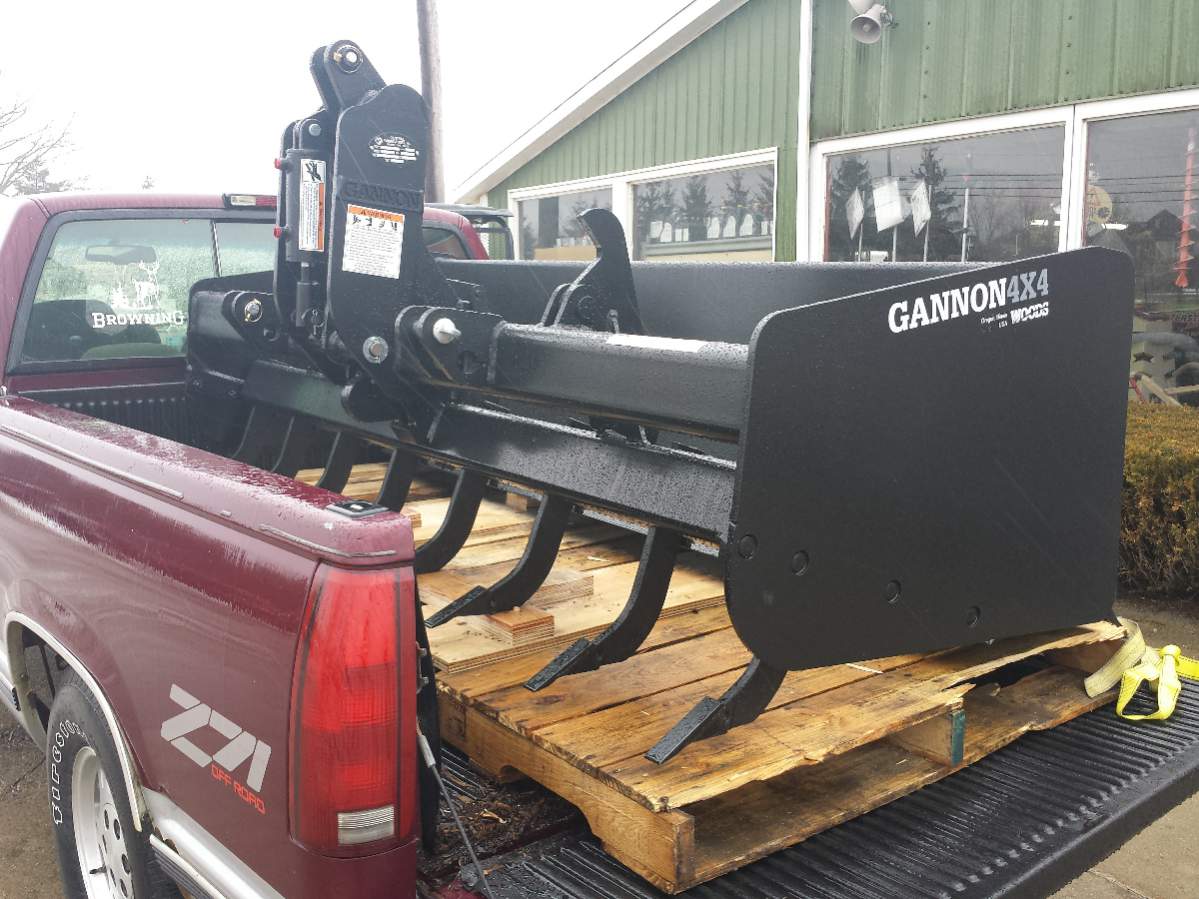

I personally like gannon it weighs more and cost less than the land pride. And has replaceable side plates. The volume of dirt that the bigger scrappers hold is amazing. Its even more amazing how quickly it fills up a small one would require lots of patience. You'll have no trouble with the blade just bouncing along on hard pack clay like my neighbor does with his light dity scrapper. I only need the shanks for busting up roots or soil. I know money is usually the constraint.
