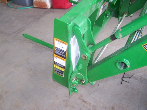

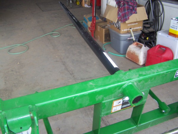

I like the forks dd, hope they work out for ya, as I am hoping the same results for the Frontier bale spear that I just got. Very nice fit and looks to be good quality. #AL1202E from JD.
I have a local farmer who will scale down his 1/2 ton bales down to 5-600lbs so I can handle them, (I'm gettin too old and lazy to buck 10 ton of small bales per yr).
Now I got to thinking with this thing.===== How can I make this frame work with some sort of pallet forks?:rolleyes: The spears are just bolted on, and the frame looks similar to the Frontier fork frame. So I am now on the hunt for forks and thinking on how to make the frame work for both.
My thinking is, unbolt spears when not needed, and make some brackets to hold either the U- style forks or the round shaft style. And interchange between the 2 as my needs change. Seeing how hay stacking is only temporary, and the forks are used more often. Also would take up less space for storage and not have to buy another attatchment from Deere, (I'm stingy with my $, and justifying another attatchment to the wife is a different story), we know how that can be;)
Does anyone have any insight or ideas that will assist me with this type of interchangeable idea? Good or bad comments are appreciated.
Thanks fellas, jjmarotz
Btw, if all else fails, I invite yall to a good old jousting competition, hahaha.

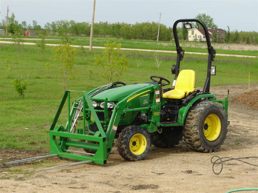

Hello, I don't know how much help it'll be in your case, but here's a pic of a bale fork I have that also works great for moving pallets. Rather than 1 spear and two smaller stabilizers below, it's got to large spears where the pallet forks would normally go. I can't adjust them but most pallets in these areas are all the same size anyway. From a bale stacking perspective, it's really good cuz I can spear closer to the bottom of the large 7-800 lb square and stack them 3 high no problem.

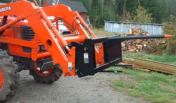

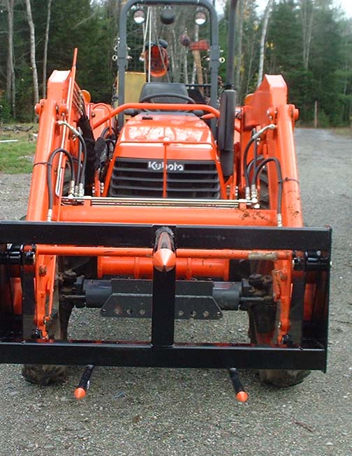

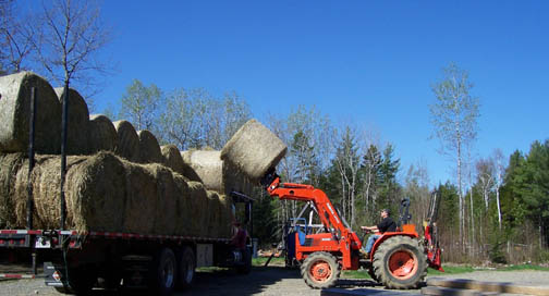

If you have the tools, skill and steel then you can build you own. I bought my Kubota branded FEL bale speer and am very happy with it. They are a little spendy, nearly $600 with MTach brackets. I handle 700 to 800 LBS. dry hay 4x5 round bales and wrapped 4x5 haylage bales that weigh upwards of 1500LBS. No failures, no problems, less than 60 seconds to switch from bucket to speer. If there is any way you can afford an FEL speer you will not regret it.
Good Luck!
Dave
