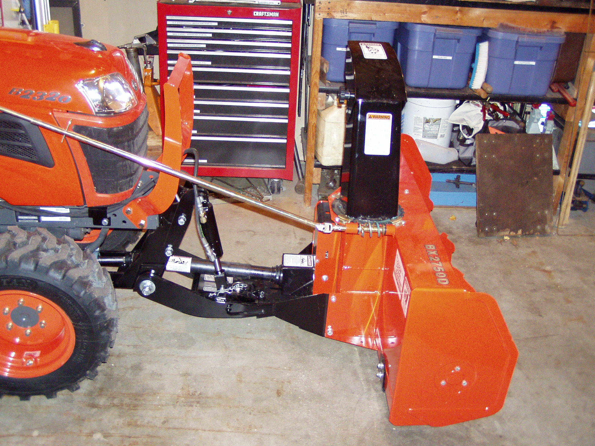

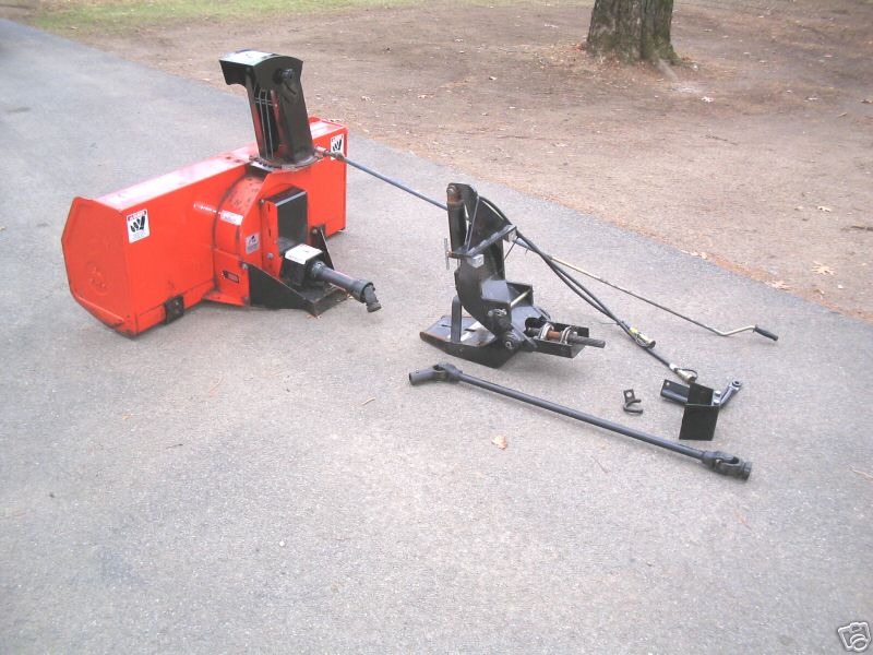

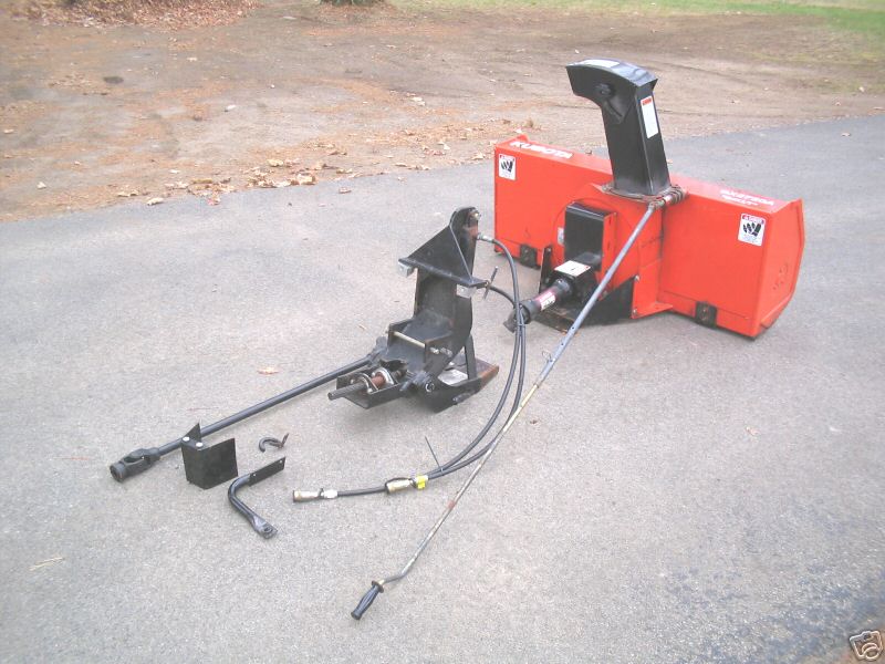

Here are some shots I have collected. Sorry I don't have one myself otherwise I would snap a few shots for you.

Thanks. What does the bracket connect to at the rear of the tractor??
That was my question too looking at the pic's. Looks like the back end of the frame connects to some type of mid hitch???? Having a BX, I can't think of what that back end cross tube connects to on the tractor frame.
   / Fronthitch BX24 #7
That is not the correct front hitch for the BX- it is the hitch for a B2320. Pics #3 and 4 are the BX mount.
There is no subframe mount on the BX version, but you also cannot leave a front brush guard on when you mount it. It hangs on the front, with 2 lower pins and 2 wedge mounts on top to tighten the hitch.
There is a pdf file with a breakdown of parts. PM me with your email address and I will send it to you.
