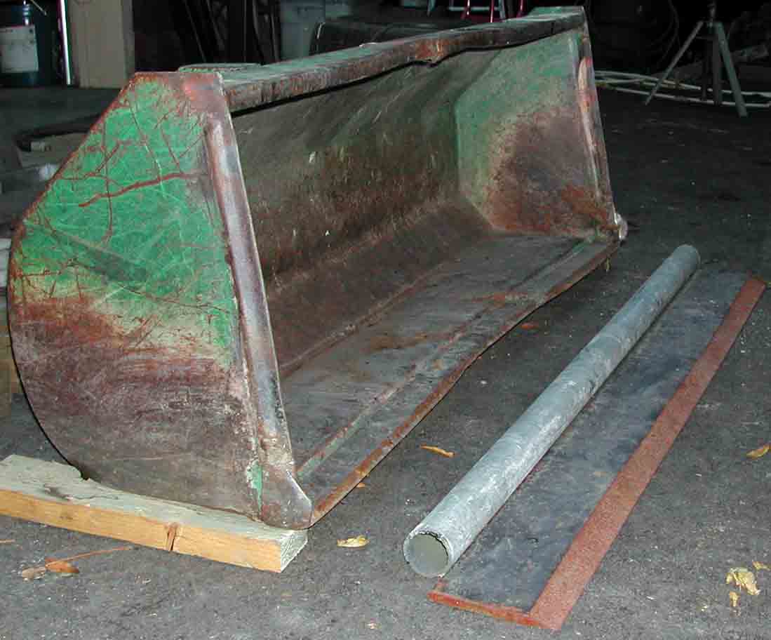

Here is a photo of a JD FEL bkt I refurbed. I shopped around for some
1/2" x 6" x 60" beveled plow steel for the cutting edge. Some tractor
dealers had it but wanted hundreds for a piece! I found some at a steel
disti for about $1/lb. This size is about 60#. I also cut out and
replaced the top lip with some thick-walled pipe, and the bottom
carcass with some 1/8"x10"x60" A36 steel plate.
"Plow steel" is a hot-rolled medium carbon steel with about 120K psi tensile
strength, referred to as C-1055. It is quite weldable, but pre-heating is
helpful for over 1/2" thickness. I stitch-welded mine, alternating side-to-
side with a DC buzz-box and 7018 rod. I did 1-2" stitches.
OTOH, drilling holes in this plate would be no fun, even with cobalt bits.
