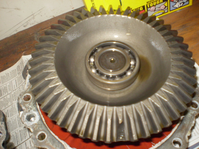

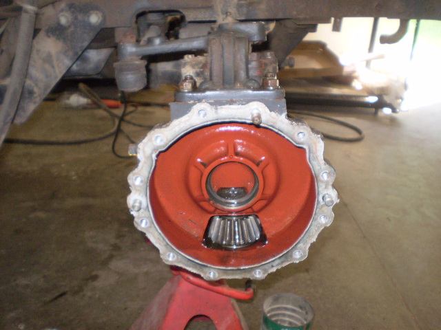

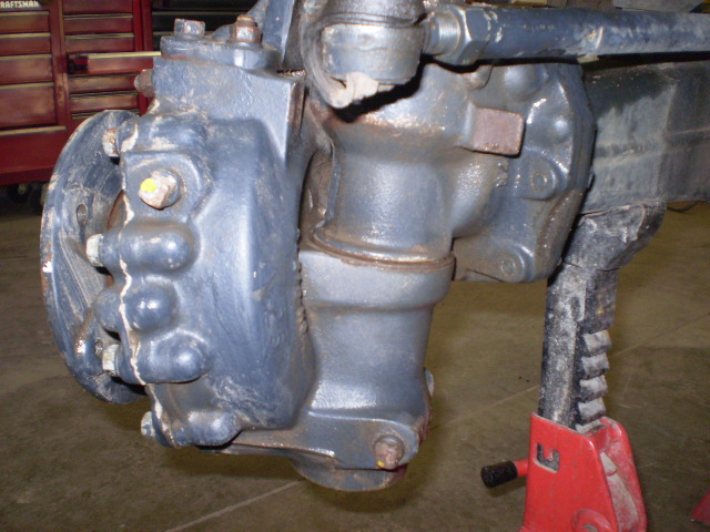

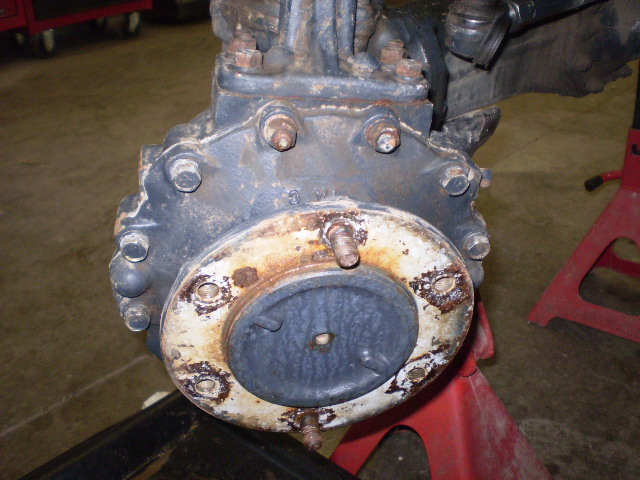

I,m not familiar with that model , Pics of the front end setup would help . I just went through the same exact problem with my TA 250F . If yours is setup like mine I can walk you through it . Hopefully you will have better luck finding parts then I am . :( I removed the the lower spinle & axle gears as well as bot axles & have been using it in 2 WD .
These two pics are the type of hub & spindle assembly on mine .
Heres the link to Mine & some tear down pics . Good luck .

Pics would help as said , I,m assuming your talking about the steering knuckle housing where the hub bearing rests into as in the 2nd pic here ? If so I cant say for sure about welding the missing piece . But I,d would think that any good welder would most likelly be able to repair it , I would check locally myself , You might check a machine shop as well , most have their own good welders . ;)

After seeing those photos I doubt it can be repaired now . It is not the best design Ive seen , not enough meat around the bearing seat to start with . And straight cut gears would not have been my choice , helical cut gears would have been much stronger and without the tendency to force themselves apart which in turn would have levered the bearing out at the bottom breaking the casting .
