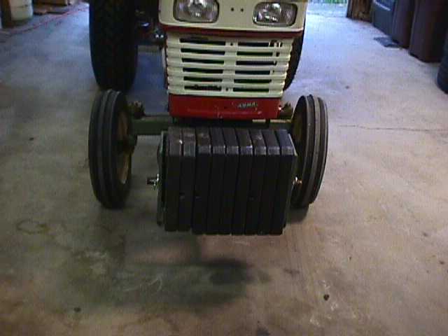

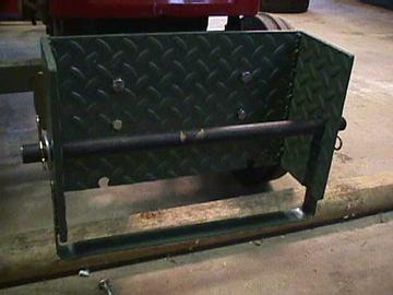

   / front weights #5
I made a bracket that I use to bolt on surplus weights from a weight lifting machine. I have 9 of them hanging there. Along with the bracket and weights it equals 151 lbs. I could try to post pictures when I get home later.
   / front weights #6
Here is the bracket that I welded together to hang the weights from
   / front weights #7
I used a piece of black pipe to slide in the holes in the weights, I can use all 9 of them or as many as I feel i'll need

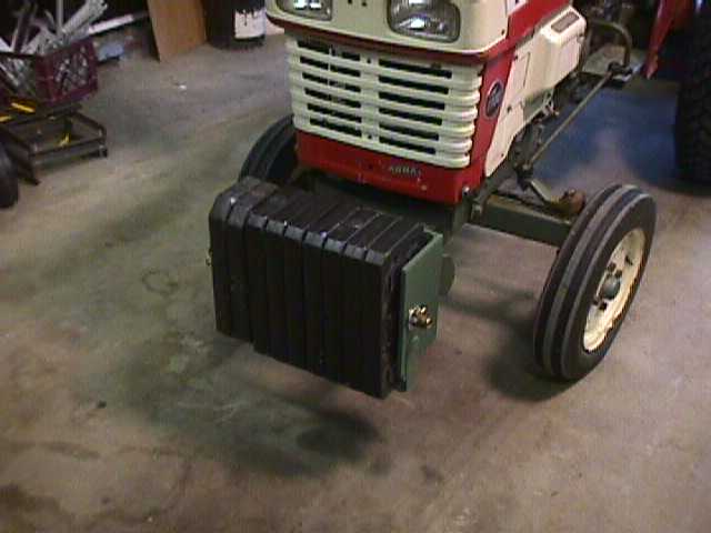

   / front weights #8
Here's another view of the same weights
   / front weights
#9
excellent job.
thanks
this gives me great insight on making one
don
   / front weights #10
That's some great looking fabrication!
Looks factory made!
Jerry W
