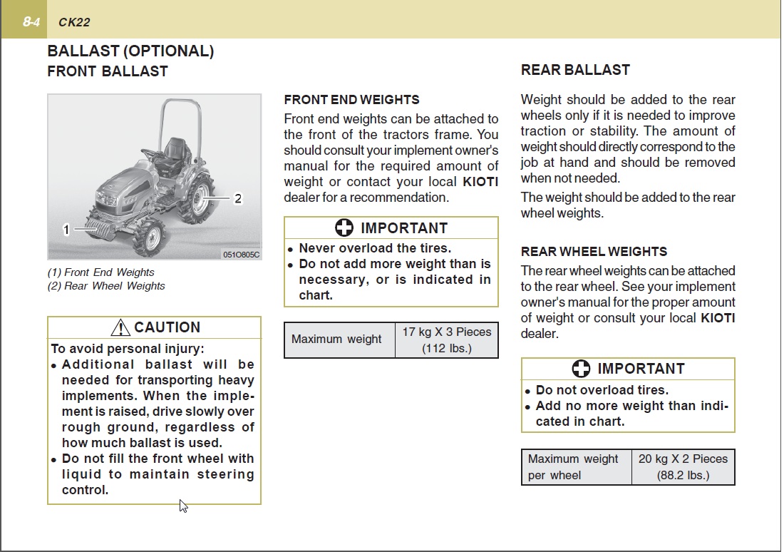

Hi I have a CK20S with a back hoe. My property is quite steep 13% grade in parts of my driveway with many changes in slope direction. Manouvering this terrain with the back hoe attached is a challenge. When possible I load the FEL which makes things much better, but this is not always possible.
My question is, has anyone used front mounted weights when working with the back hoe and if so how much do they help? Also can they be mounted with the brush guard installed?

I was told to load the fronts by my dealer when I inquired about the floating front end. I cannot imagine that it is a warranty problem. [...]
I've attached the page I recall that talked about loading the front tires (text is in the box)... Interpret as you see fit. (This is from CK22 manual, which should be the same as the CK20S.. just a different model number overseas).
I also agree with that post about "backing up the slope being the school solution."... My online searches all more or less verify that this is the recommended approach.
In any case, let's all be safe! :thumbsup: It should be known that the weight and leverage of the backhoe in particular on the CK20 models is both a boon (for ballast) and a possible hazard (when going uphill facing forward).
-Mitch
