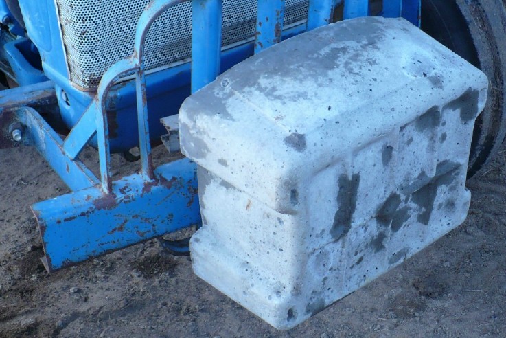

Problem: BIL's old Ford tractor does not have a rail on which to hang weights. We were picking up 1500 lb hay bales and the wheelies were causing the wives additional laundry work.
Solution: An 80 lb weight for $8.
How: (Not an original idea) Pour an 80 lb bag of concrete mix (6,000 PSI) into a well-oiled recycling tub. Push the rebar/ bolts into the wet mix. Let it set, covered and bathed in water, for 28 days. Bolt it to the grille guard. Move hay without fearing for your life. :)

Very nice. The mold looks all fancy like it is factory made. Is 80lbs all you need to couter balance 1500lbs?

Hey, Kid. I guess it works because the hay bale is close to the back wheels and that weight is way out in front of the front wheels.

Remember.. rer wheels ar ethe fulcrum / pivot.. got lots of weight forwrd of that. and not much other than the bale behind it... thus things like the tractor trans, engine and front axle are already built in counterbalances... looking at the distance.. your front weight may be 6-7' away from the fulcrum. rememer what weight does as you move it away.... ever torque a 400# bolt down using a long cheater bar and measly 150# person.. it's mechanical advantage..

I love that idea for a front weight. You could even arrange something on the bottom of the recycle tub to make a permanent smiley face or other design for the weight. The only problem I see is there is a lot of additional stress on the bumper bolts that are mounted through the front axle. You might need to use grade 8 bolts to ensure the bolts do not snap off if you hit a big bump.

Concrete has always been cheap weight, it the front grill guard has the strength to add weight then add as much as you need. If the front tires are almost off the ground no stress on the front end. Otherwise the front end weight is not anymore than an empty front end loader without the bale on the back. A front end loader would add maybe several hundred pounds to the front end.
