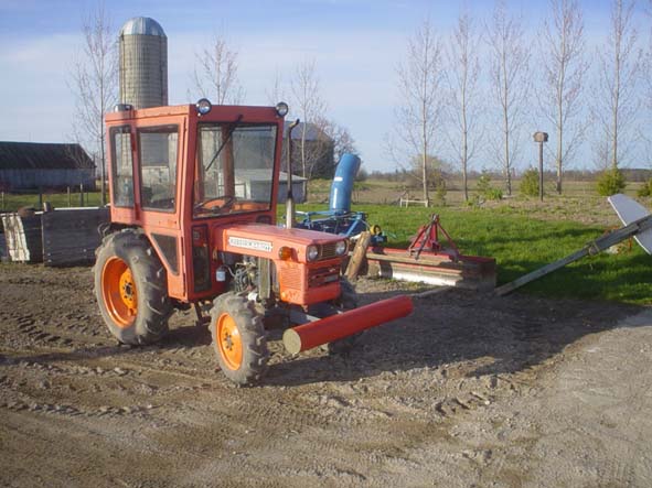

I have been having trouble keeping the front end on the ground I am thinking that this will help.

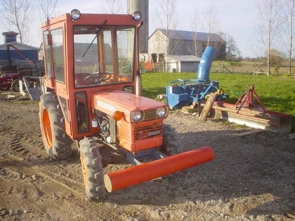

I used 3" angle iron to build a box and then added 48" of 6" well casing to that but it still was not heavy enough so I filled that with concrete. I have no idea how much it weighs but I can not lift it. Any ideas on weight???
