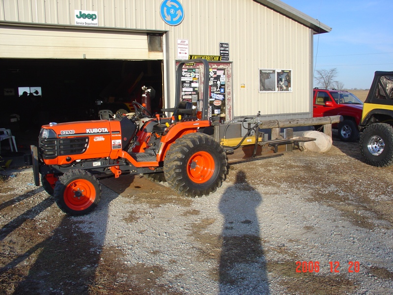

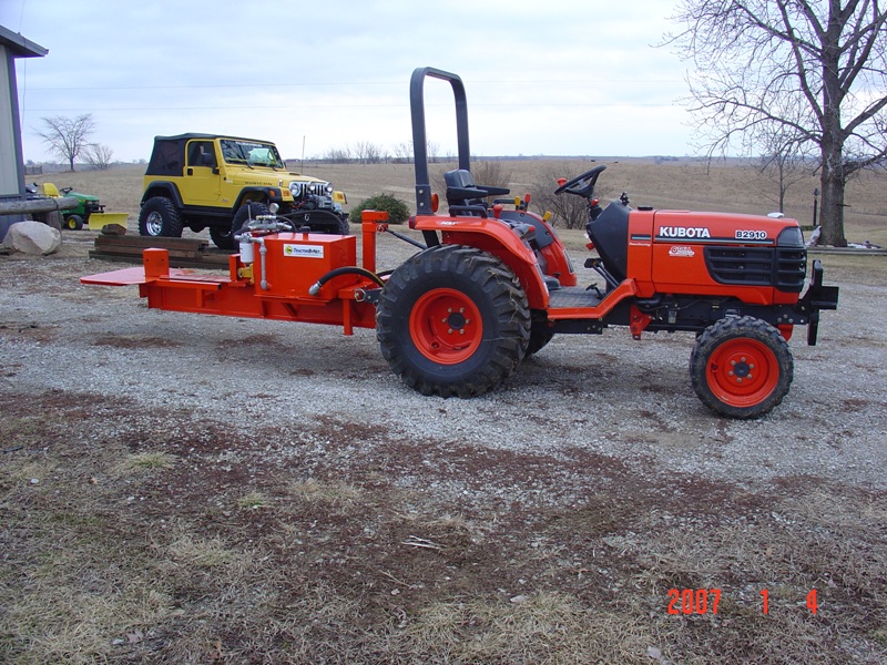

I built a bracket for the front of my Kubota that I can stack suitcase weights on. With the splitter or brush cutter I use two, each weighing 125 lbs. I built it so the weights sit sideways and don't stick out the front much. I don't have a real good picture but you can get the idea. My bracket will hold three weights total, one is installed in the picture. With two weights on the tractor is very stable with a 5' Ford Brush Cutter on the back. Haven't found a need for three yet. :)

I couldn't find a suitcase weight that I thought was priced reasonable. Suddenly weight is expensive if you get it that way :confused:
