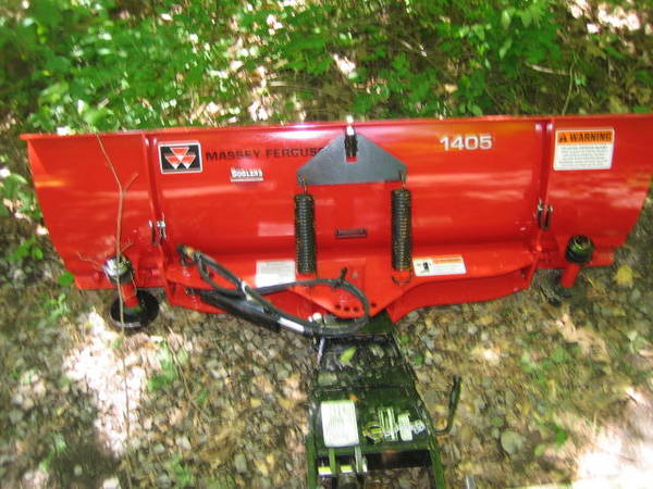

I have a Honda 6522 with Turf's and (I believe) a MF 60" power angle front blade. This is second season it has been used to clear gravel drive / parking area of approx. 12,000 sq.ft. Most snow falls are in 1" - 10" range, but drifting can result in some deeper spots.
I have lots of room on the edges so pushing the snow back enough or high enough has not been a problem yet. Personally I would not want a blade without power angle, nor would I be keen on a rear blower with manual chute adjustment.
My blade looks identical to the attached photo, but without decals.
