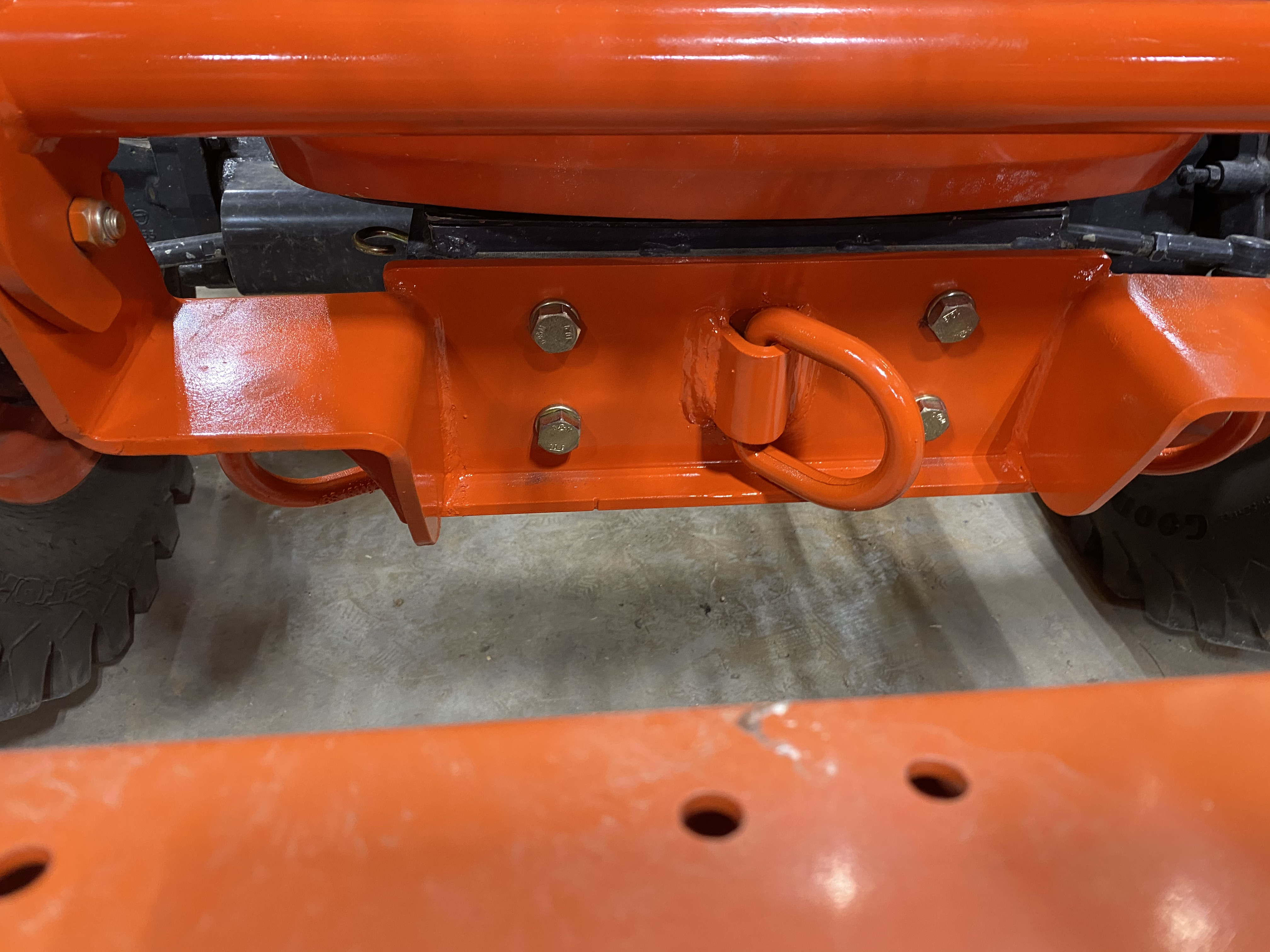

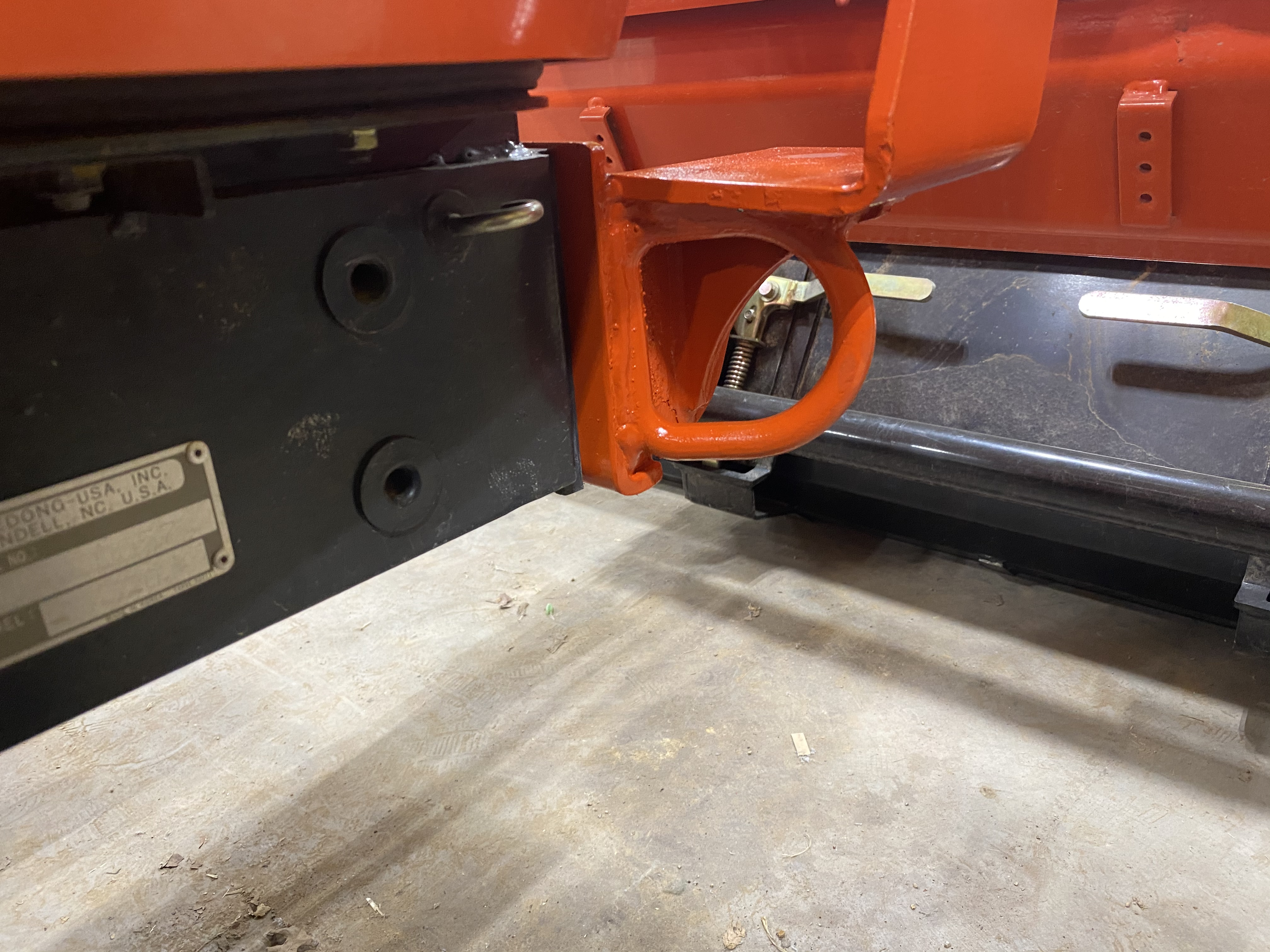

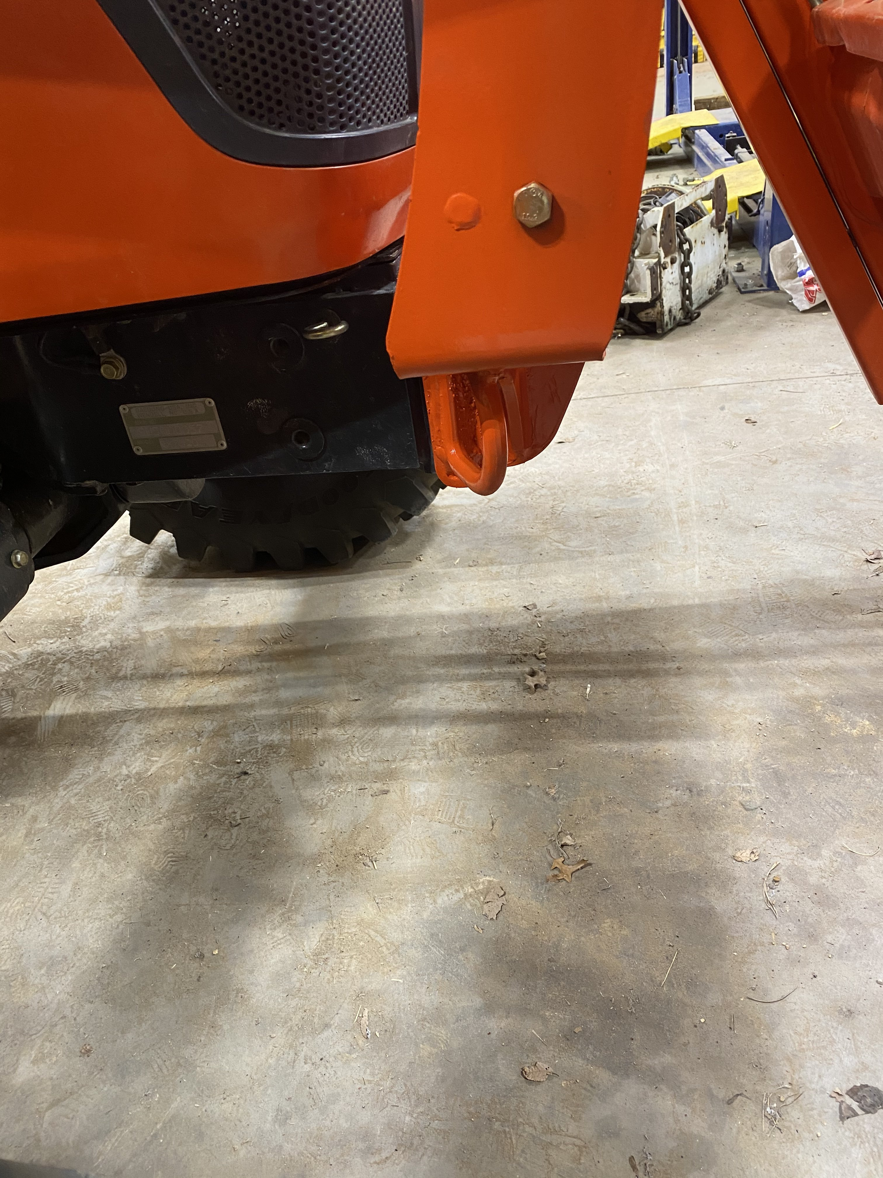

Today I added a front tow hook and a couple tie down points on the front of my RX7320.

Very nice. Did you weld that assembled, or take off first?
   / Front tow hook and tie downs added to RX7320
Took it off. Just four bolts was super easy. I had a helper hold it while I took bolts out.
I had a leftover can of Kubota orange paint I bought from the dealer years ago I used to paint it. It felt wrong but appears to be an exact match.
   / Front tow hook and tie downs added to RX7320 #5
I guess this answers that question lol

The above pictures are Kubota orange. I didn't paint the entire grill just touched up where I welded. I am not a paint aficionado but I can't tell the difference in what I painted and the original. Maybe Chevy engine orange is better but the Kubota orange matched plenty good enough for me.
