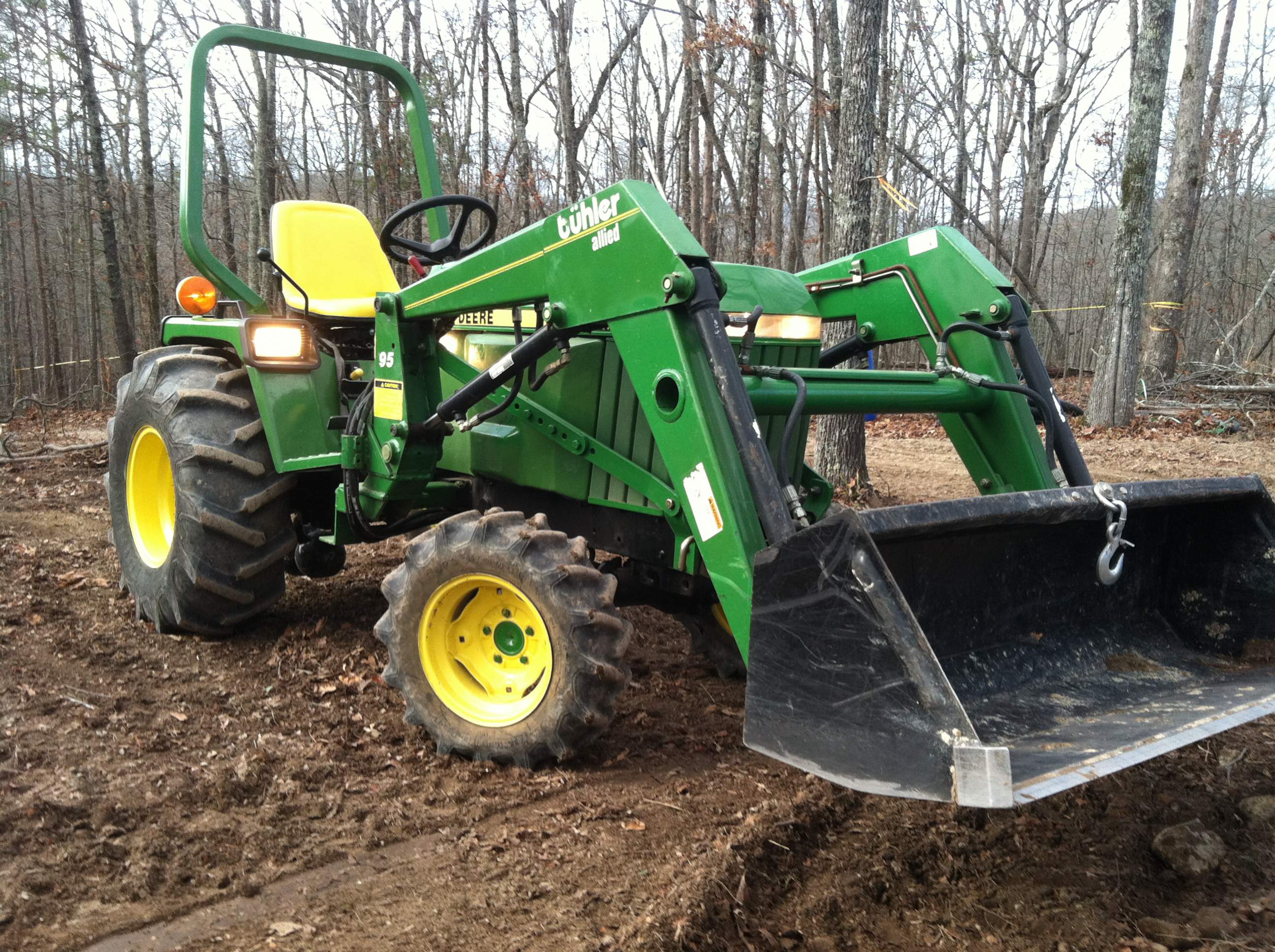

Was the valve stem ripped off the tube? If yes then you probably spun the tire on the rim and this can be caused by to low of pressure or lots of traction available to that tire trying to pull/push the rest of the tractor around.
I didn't see it but that is the impression the tire shop gave me, that the tube or stem had torn. The first time they thought they had nipped it when replacing the tire. When it kept happening they said the tubed stem couldn't take the stress/spin and advised going back to tubeless. Because of the ongoing slow leak problem I was in the habit of keeping the tire inflated above recommended pressure when using the bucket and checking it before each days use.So I don't think that was a problem. Forgetting to get out of 4WD and/or backing out from loading the bucket while on pavement might have contributed to the problem. Never had an issue with the front tire on the other side.

As a former BX2660 owner, I experienced one front tire that would consistently loose psi. This was three years ago and several BX owners were having similar problems on the front. My fix was to use a bead sealer on the rim. I did a lot of heavy FEL work thereafter and never had a leak problem or a tire to roll off. With heavy FEL loads the tire psi is increased. After the initial leak problem was fixed, the tires stayed right where I set them.

With tubeless tires on my Kubota B2710, I tore the valve stem out of the left front tire once while moving (pushing) a big load of brush with forks on the FEL bucket. And the only time I rolled one off the rim was when I forgot the front tires were inflated to the minimum instead of the maximum, and I was using the forks on the FEL bucket to lift a pallet with a full 55 gallon barrel of gasoline out of the bed of my pickup and then turned to take it into the shop and rolled the right front tire off the rim. The ratchet strap around the tire enabled me to easily re-inflate them each time.

I've only had the tire debead once. I let the pressure drop too low and the tire spun on the rim. Just as I saw it spin the tire lost all air. Unlike a car the tractor wheels don't have a lip that holds the tire bead in place like a car so once it starts to go it just slides off.
