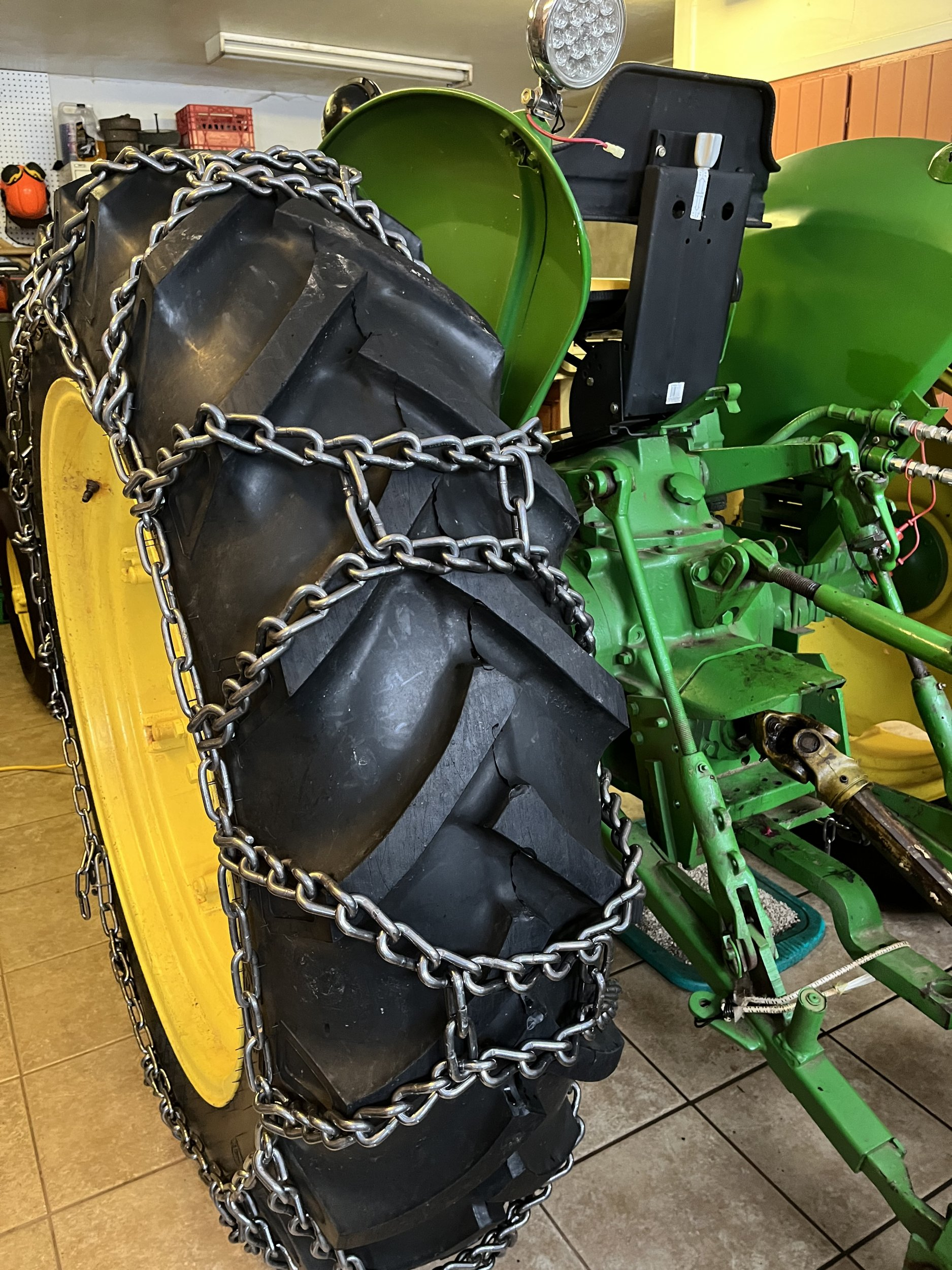

You need to decide what you need and are willing to pay for, the fancy studded and Euro pattern chains cost a lot more than standard chains and I don’t get what people are talking about when it comes to ride with a tractor unless you have a lot of transits on paved roads at higher speeds. These chains cost about $450 a side and give me all the traction I need on the packed snow and ice, no way was I going to pay $1200 a side for hardened studded chains just to use clearing the lane, etc. These chains, like the tractor, will outlast me.

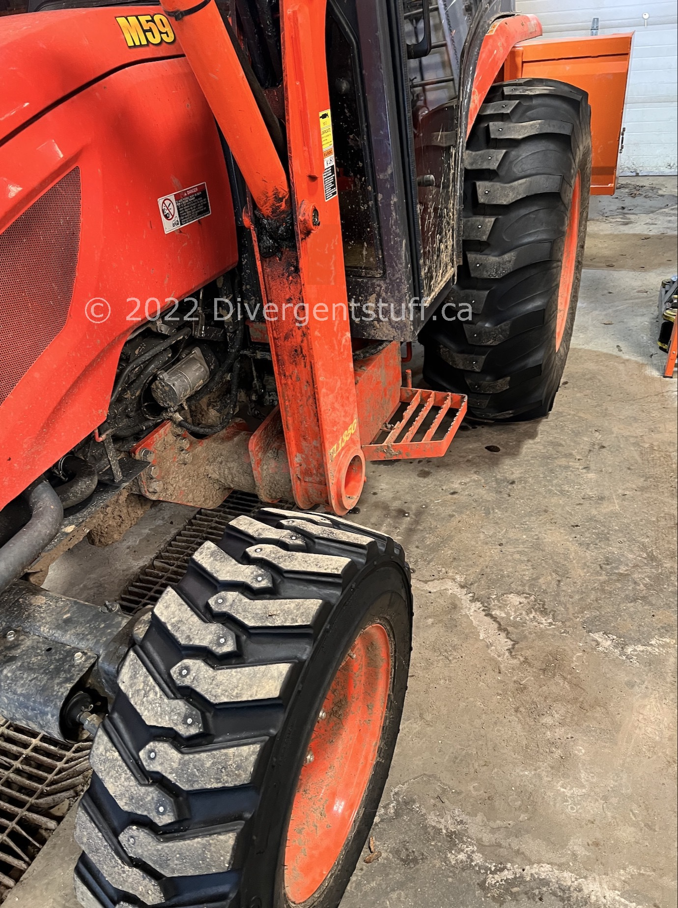

Wow! 3.5-4’ of snow! And mountains! Your in the Nordic euro type chains category.
10-16.5 R4 tires are common skidsteer tires. Some say not for skidsteer use but you have a tractor.
Surprised you don’t need them on the rear also. What do you have on the rear? Backhoe?, blade?,blower?

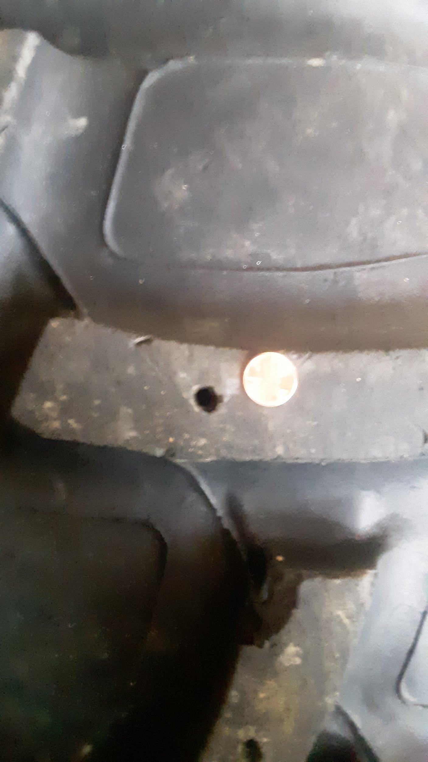

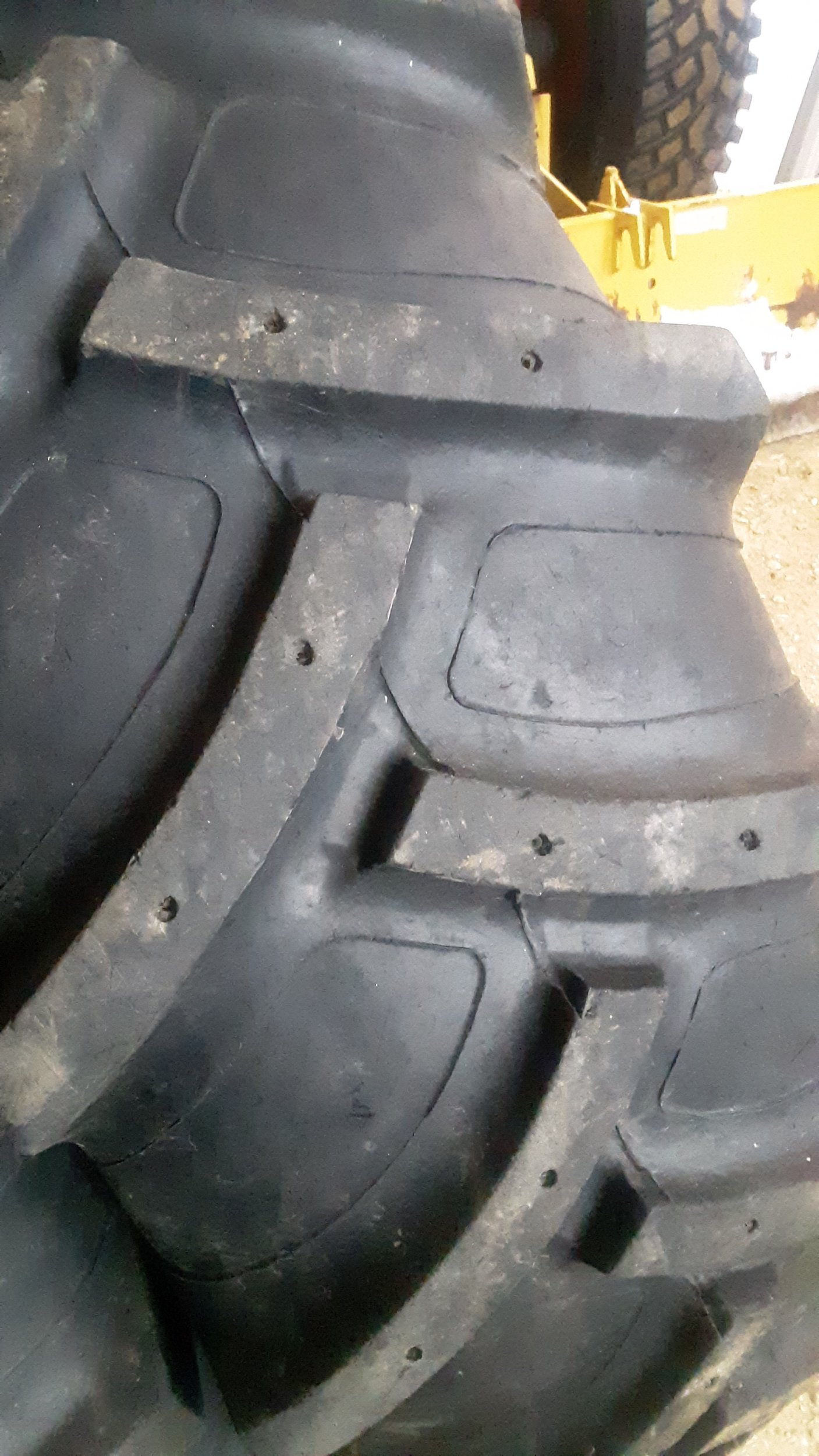

Mike I'd suggest that you leave the studs in permanently. My first year I took them out of the fronts. They leave a pretty big "pocket" that is un usable the next season.
These pictures are my old rear tires that I just replaced. The studs were in them for 5/6 years. Out of the 80 studs in each rear tire, (18.4x30) there were only 2 or 3 missing.

Awesome, thanks for the pics. I'm gonna leave mine in, thats why I went with the low profile studs. We had freezing rain yesterday and 8" of packing snow on top. Just motored on through this morning with very little tire spin. I'm liking these way better than my ladder chains. At least I don't have to worry about the chains walking and breaking something on my steering mechanism.
I only did a single stud in each lug on the center line. I figure I'll just add more studs in the future when these get worn down.
