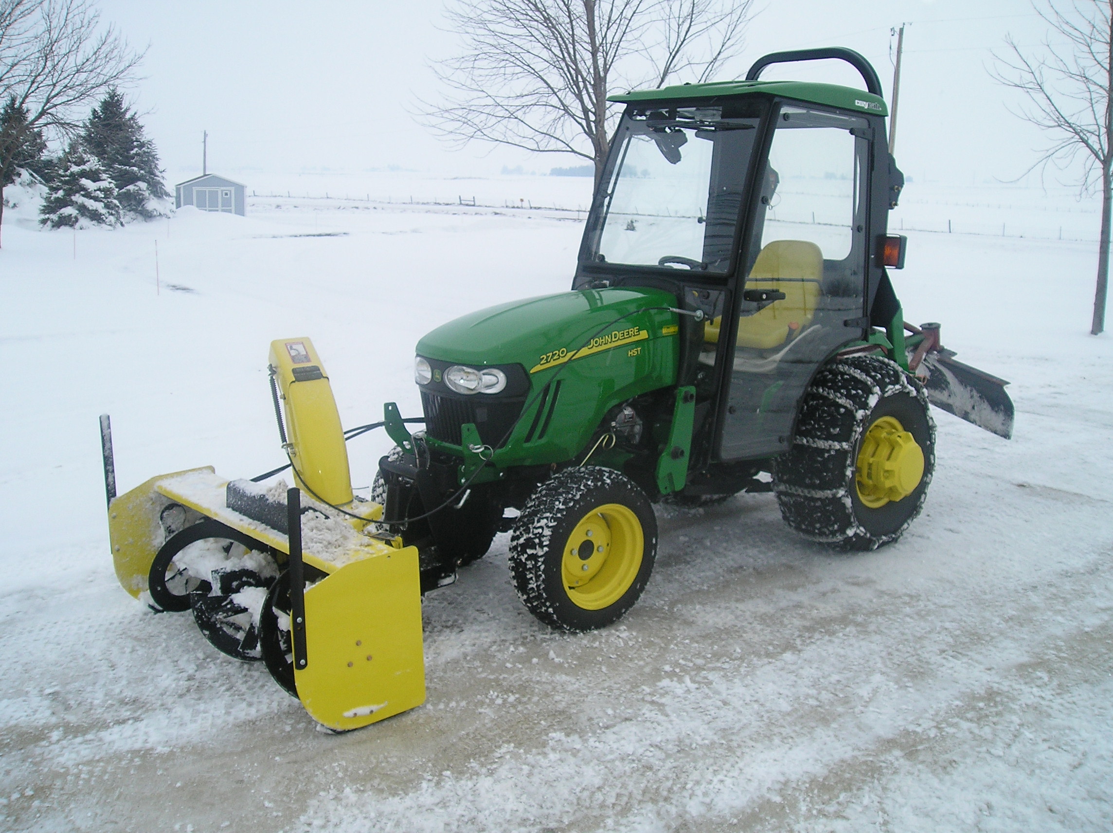

I like your blower/blade idea. I don't have to much of a problem with the blade knocking the sides down, but I seldom get snow banks over knee high. If it does happen, I just make an extra pass to clean it up while steering in an ark to keep the blade away from the snow wall. My blade is 84" and the blower is 54" wide.
My concern is the length of the entire rig when the blade is on. There is a lot of rubber-necking going on while close to buildings and such, so I don't destroy anything.

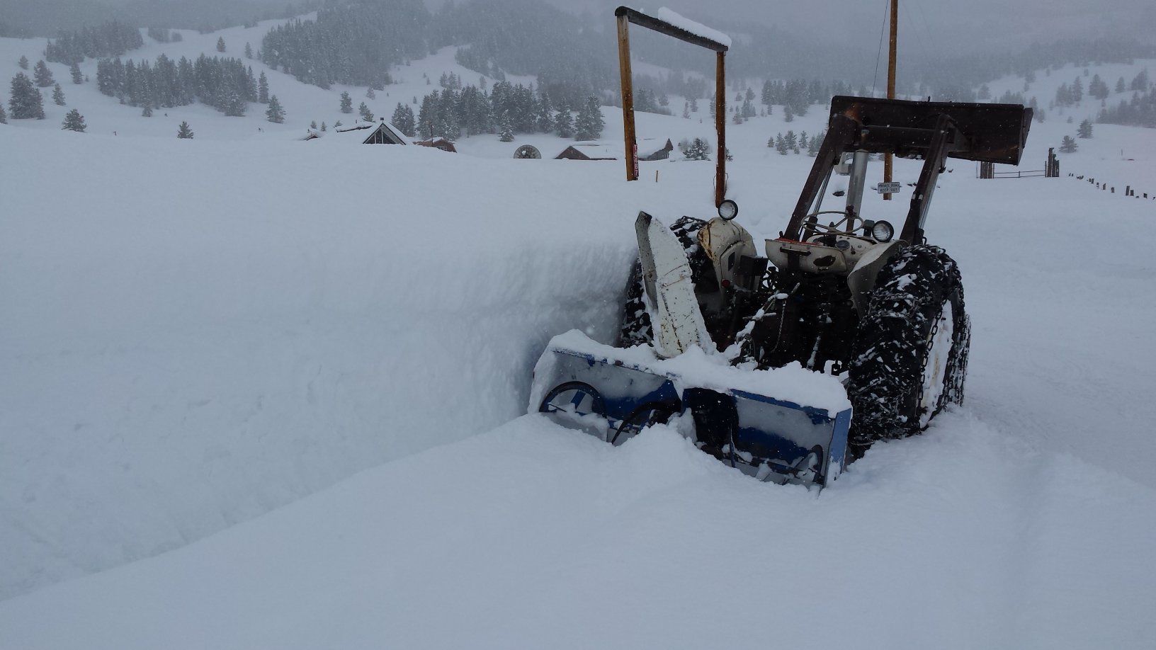

An offset rear blade is exactly what I need! I did not know such a thing existed but it makes perfect sense. That would also help me clean up drifts without burying the blower or rear wheels in the vertical wall of snow I end up with. The picture shows what I am up against by mid winter. Locking the blade parallel to the direction of travel would also be very helpful. Thanks everyone!

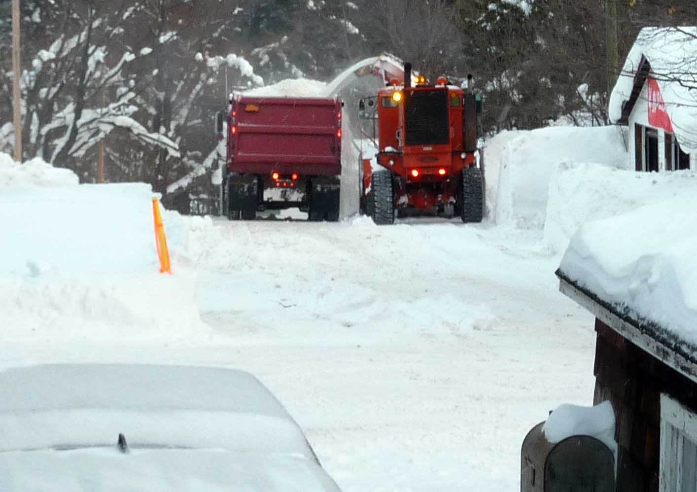

What about a sno-go? :D Photos from last winter taken from our porch. (yes, I'm distracting from the OP question)
