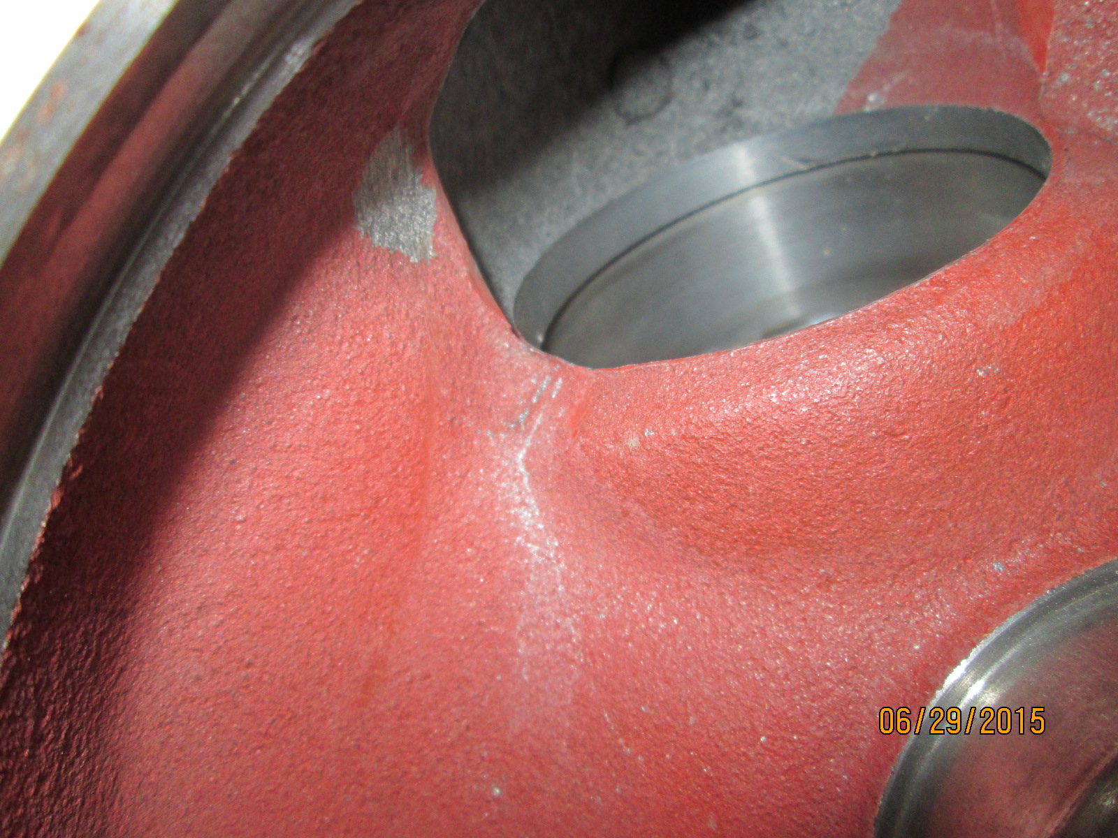

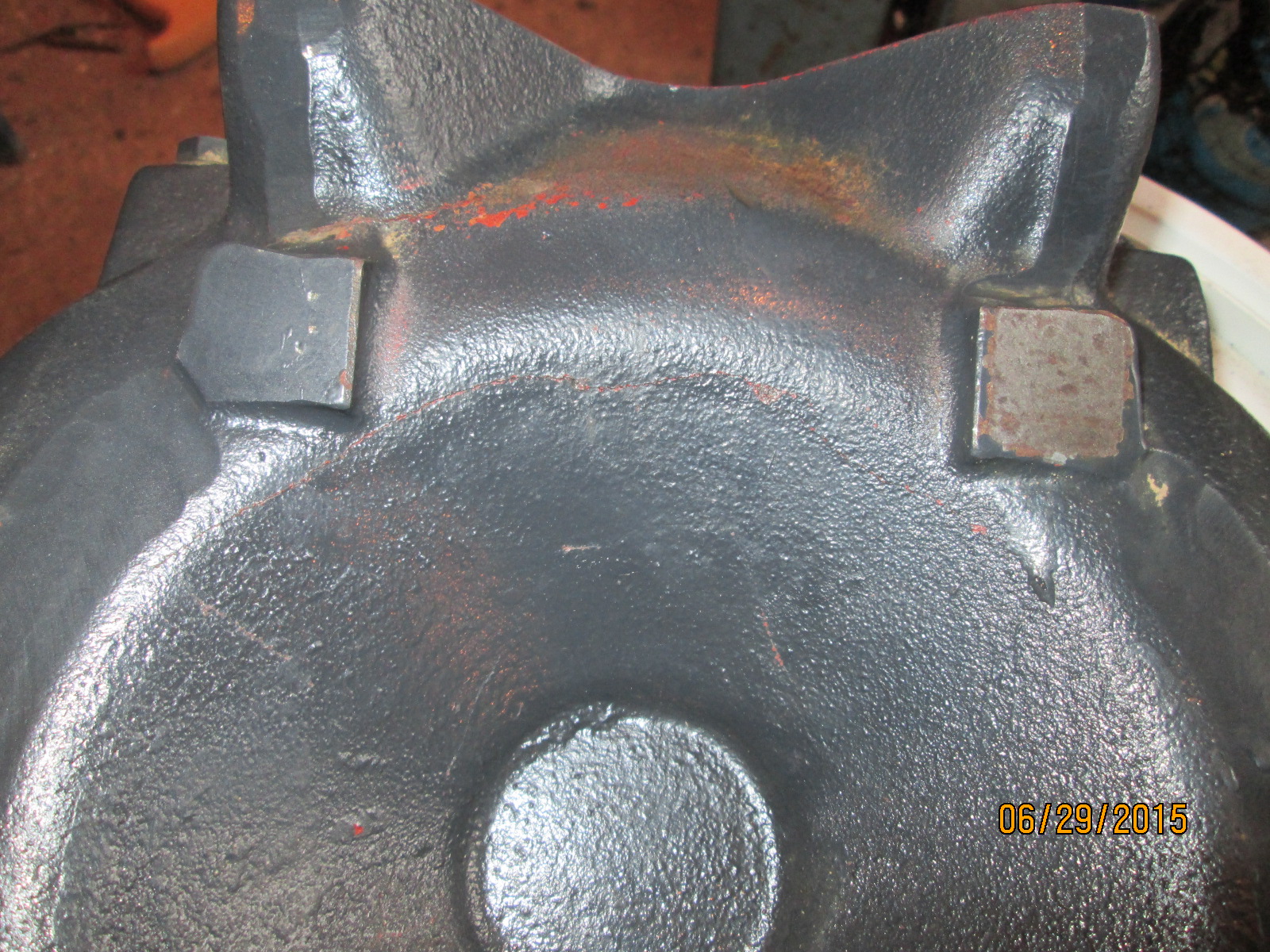

After a better look I see the gear housing is cracked about 1/4 way around.
Not sure how it got cracked as there should be very little pressure on that area

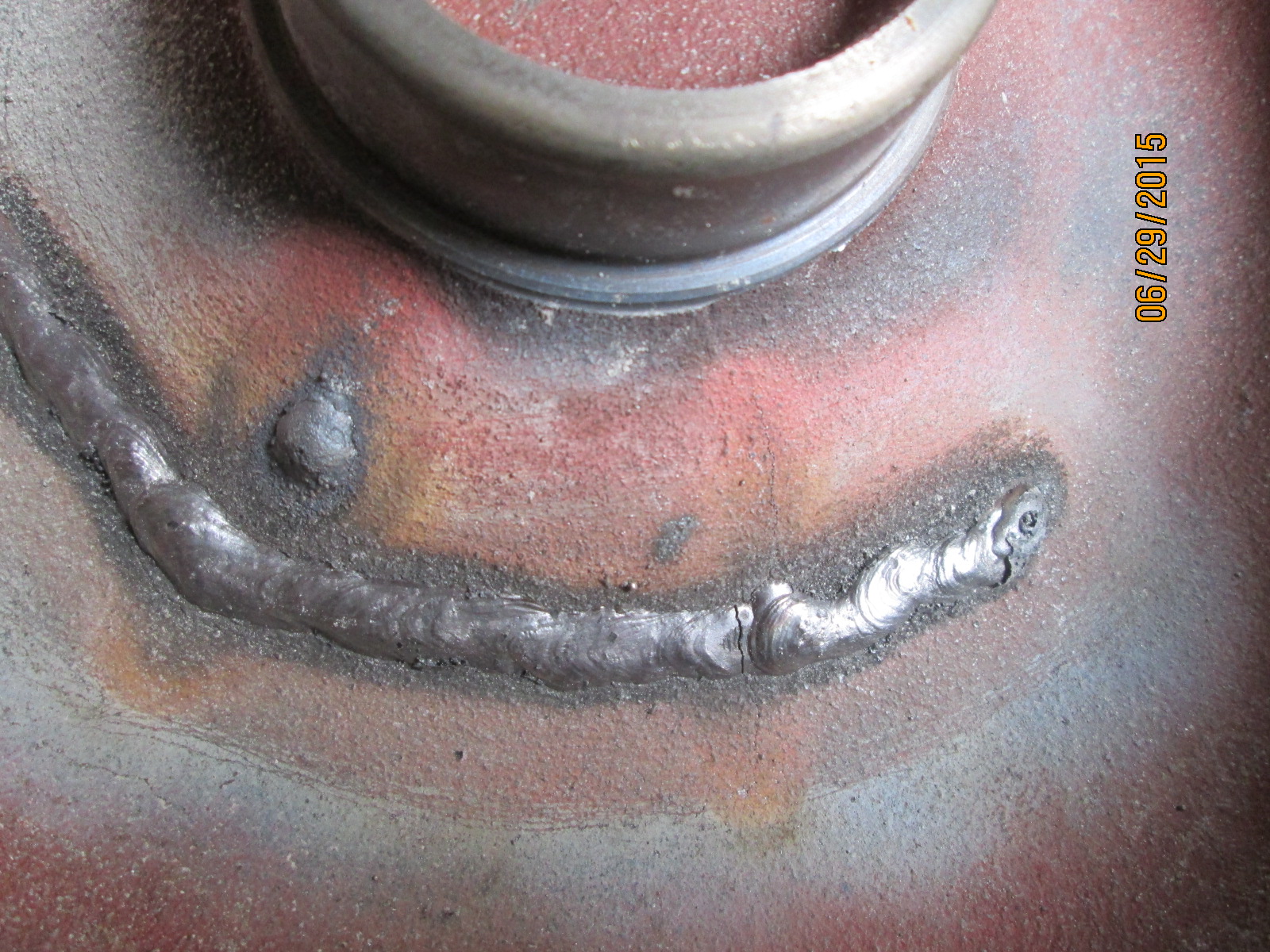

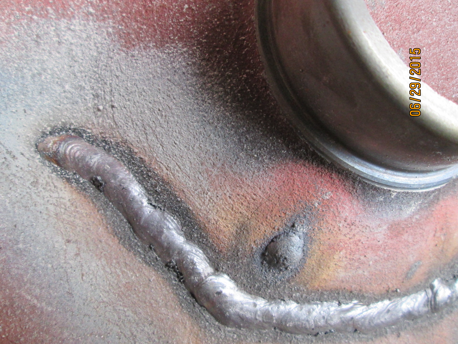

I go to the machine shop to have repaired . $80 Buddy tried his best but as he welded it cracked in another place He didn't charge me as he figured it was going to leak. Called dealer $500 for for a new one . Should be here in 6 days. IMG_0925.JPGIMG_0926.JPGIMG_0927.JPG
