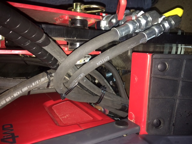

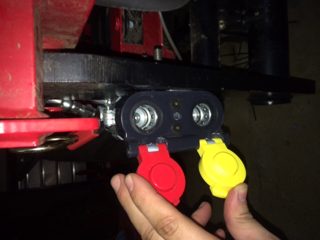

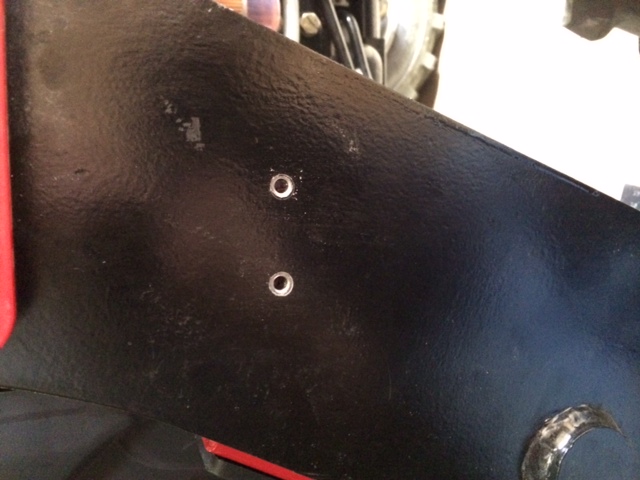

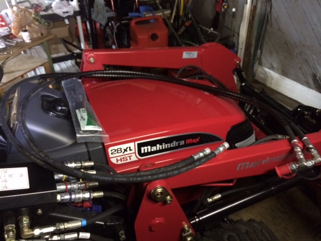

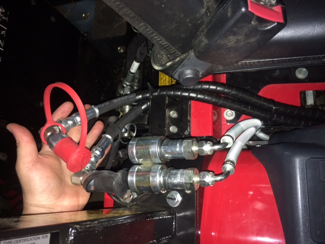

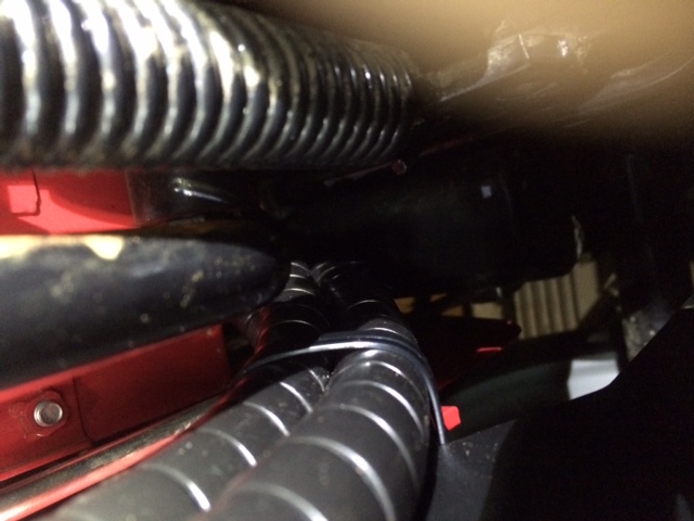

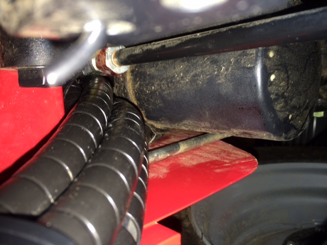

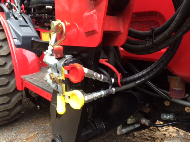

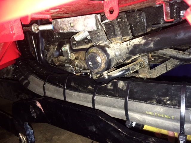

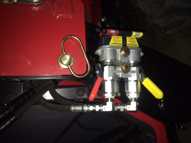

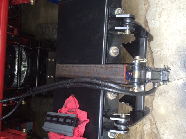

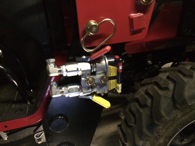

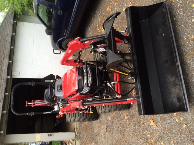

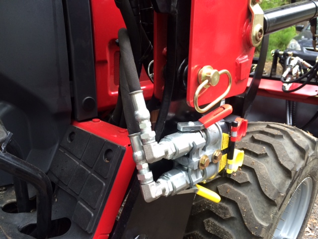

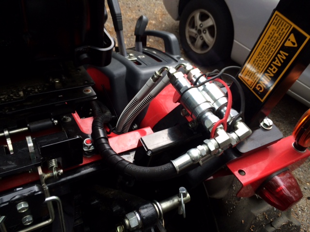

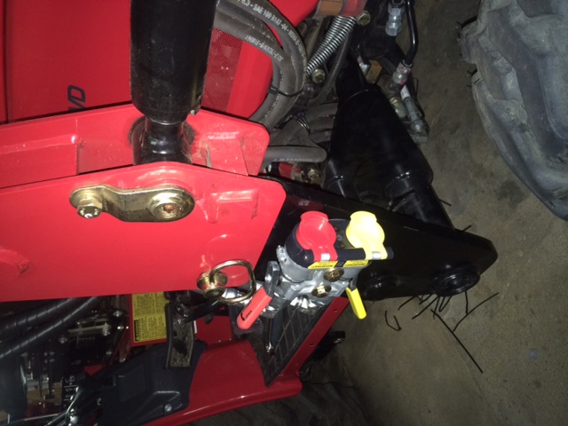

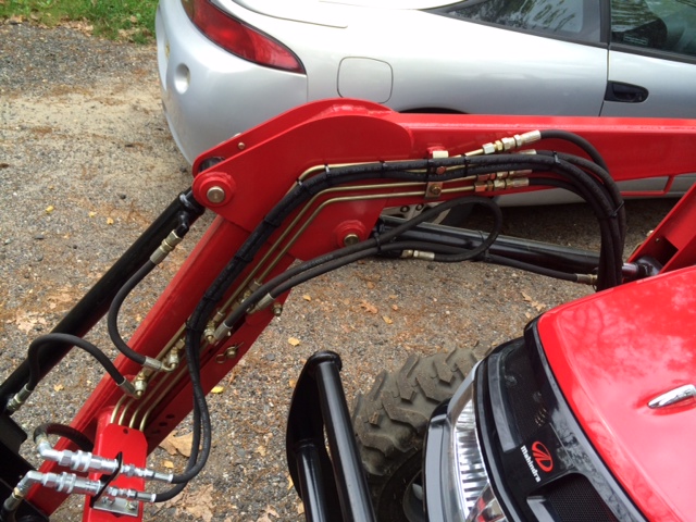

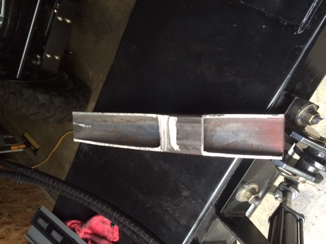

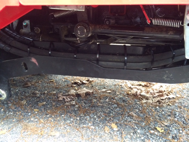

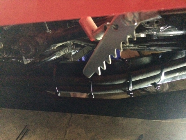

Well decided to go crazy and hack into my new 28XL. While I was at it, I decided to correct a few issues with hose interference under the frame as well as the control column. The valve was a 9502 model from Pioneer (TSC) and many of the fittings and couplers from DHH online. Had the lines built (expensive Eatons) at a shop...would have cost less online, but the wait and shipping....it was a toss up. I wanted to use the factory rear remotes but the option to route them forward to allow for thumb and other future uses later down the road. I decided to spend the extra few bucks and make a factory looking setup done right that I can rely on using ORB fittings and flares where I could. I did a stress analysis through some modeling software I have at work, the 3/8in. holes (chamfered as well) for the bolts made little difference in strength. In fact, the loader frame's design and load characteristics far exceed (better than 2 times the max lift) anything you would be brave enough to raise even with double the lift cylinder displacement. Bottom line, it looks and works great. More pics to come, Shot some underneath to show clearance on the 3/8 lines on both sides of the frame brace. Yes, my lovely lady was laying in the dirt with me routing lines, wrapping the line saver, and generally keeping me from losing my mind. Gotta love a girl that likes to work and get dirty, but cleans up nice;)

photo 15.JPGphoto 14.JPGphoto 13.JPGphoto 12.JPGphoto 11.JPGphoto 10.JPGphoto 9.JPGphoto 8.JPGphoto 7.JPGphoto 6.JPGphoto 1.JPGphoto 2.JPGphoto 3.JPGphoto 4.JPGphoto 5.JPG

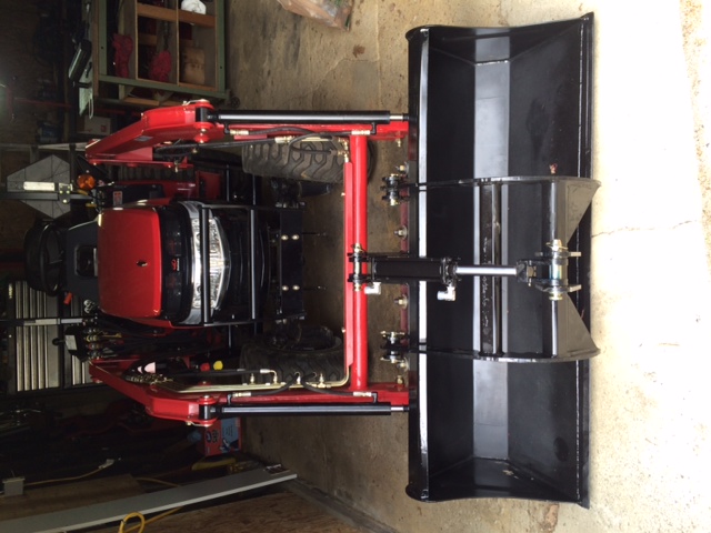

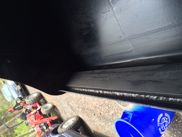

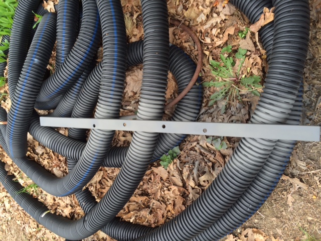

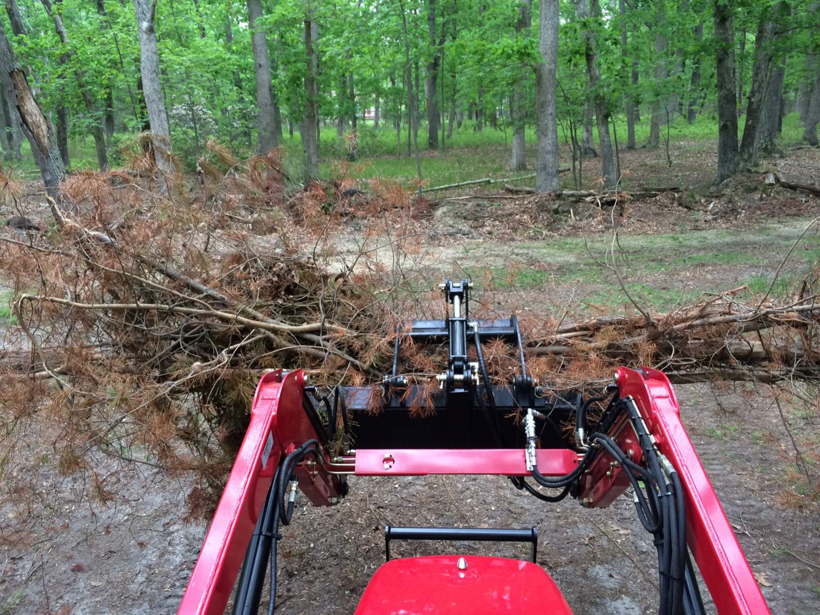

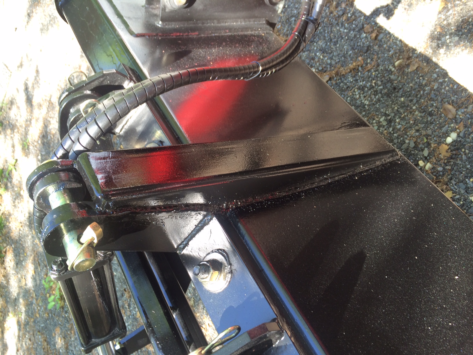

Added 1/4 channel to the underside of the bucket top. Finish drilled the mount holes, used 5/8 grade 8 flange bolts and assoc. hardware and RTV to keep the water and dirt out. I used weld-thru primer inside and out and a few nice coats of enamel. Just need to add the QD's at the crossmember on the loader and some short lines to the grapple cylinders.

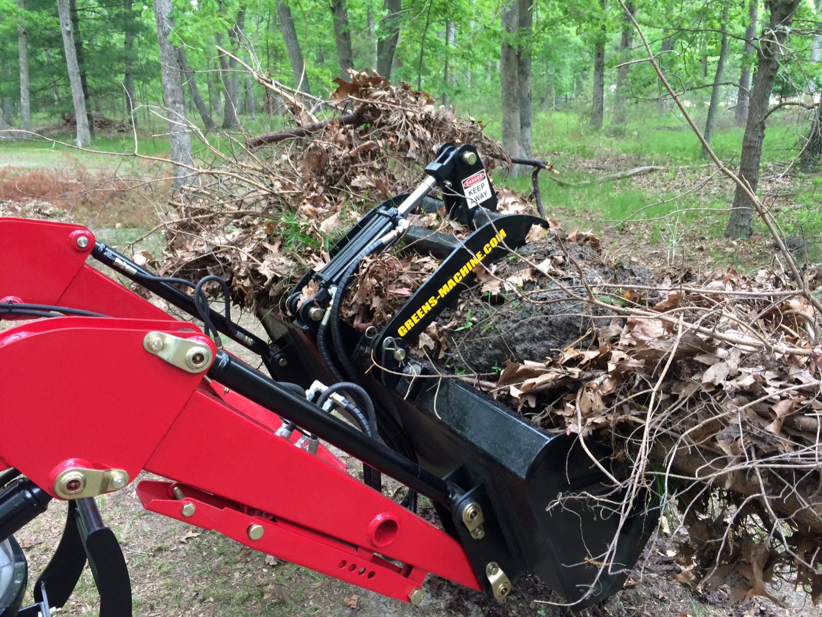

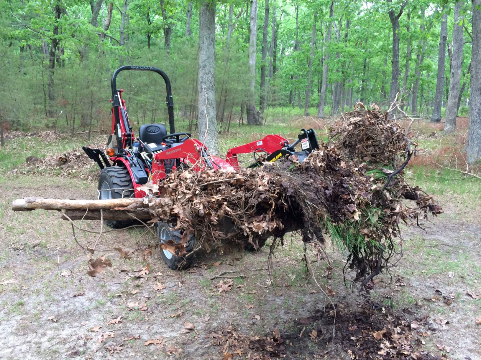

Finished the Grapple, works great! Enjoy

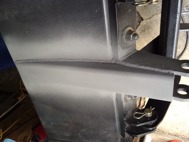

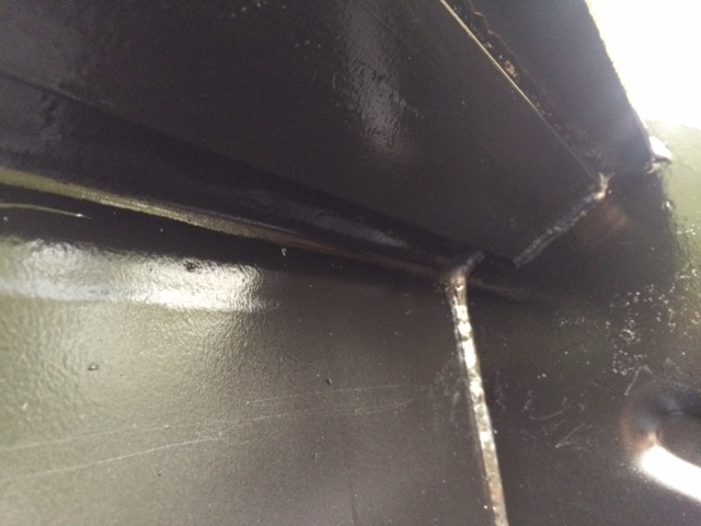

Added a few more pieces of metal. Still had a bit of bucket flex, solved it permanently with some 3x2 1/4 wall. It's fully boxed, primed and painted. Now to add lights and other mods;)
