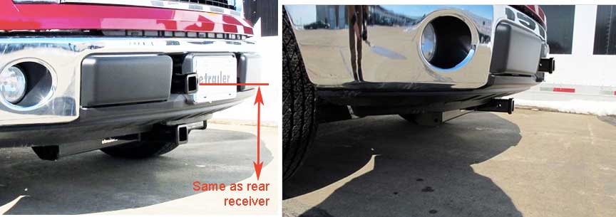

I plan to add a front receiver hitch to my pickup. I found one from CURT that does not satisfy me. It's too low, and too far under the bumper. For me it would be always full of dirt. I sure as heck wouldn't drive with a receiver-mounted winch in the CURT unit.
I used photoshop and put the receiver where I want it, except about 8 inches off center. Pretty sure I can get structure to the frame.
This pic is from the CURT website, but I photoshopped another receiver higher where I want it (equal to height of the REAR receiver).

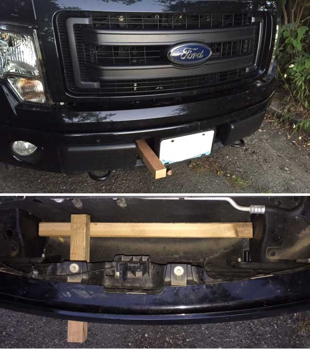

I mocked up the structure behind the bumper with 2" x 2" cedar. Not sure how I'd get it in there if it was welded, I think it has to bolt together.
434910d1438320657-front-receiver-hitch-f-150-a-f150front_hitch_mockup-jpg
Has anybody seen a good way to do this on an F-150? Any other comments about front-mounted receivers?

I haven't looked closely at that area of my truck but looking at your pictures, I think I would make up some plate to bolt to the inside of the frame rails and then weld the cross piece of 2 inch tube to those plates then bolt it to the frame rails. If a one piece receiver can't be made to go in place, then weld some plate in the middle of the cross piece to bolt the 2 inch receiver piece at a 90 degree angle.
Just thinking out loud here.
   / Front receiver hitch on F-150
#9
GP that's in general what I will do. Trying to think of a way to use existing holes on frame rails,& not welding on the frame. Probably will use the towhook bolts on the frame bottom but they won't be sufficient. Getting some support at top of the frame will be necessary but haven't decided how yet. I might drill the frame though. May have to build "nut-holders" to extend to access existing holes.
   / Front receiver hitch on F-150 #10
I just went out and looked
My bumper is a little different so I could have the receiver centered. Anyway it looks like you could make 2 "L" shaped brackets, attach to the bottom of the frame rails where the tow hooks are and run the other leg of the L up the inside of the frame rail. Drill for bolts through the side of the frame rail.
You could bolt the tow hooks right back on, sandwich in the bottom of the L bracket between the hooks and frame rail, as mentioned by TMGT.
I haven't determined yet whether or not a complete one piece receiver can be put into position to be bolted on the rails. May have to have the actual receiver portion bolted as previously mentioned.
