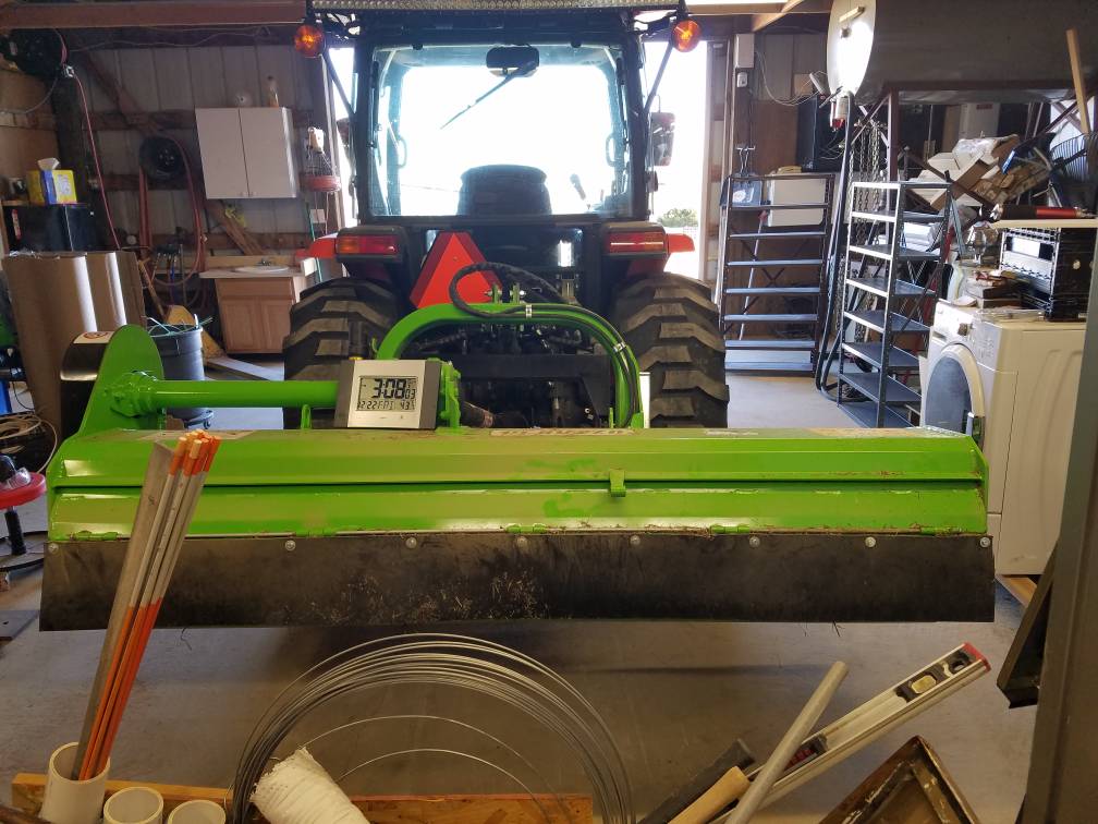

Technically my flail can be mounted in front. Just need a different bracket, probably some caster wheels for the front & a different gearbox cover.
A boom mount mower would be cool, but I barely have enough power as it is. Most of not all boom mount mowers are hydraulically driven. And as tractors dont have enough hydraulics, which means running a PTO driven pump to get enough hydraulic power. I suppose you could use a center PTO for that & the rear PTO for the other flail. But CUTs aren't going to have enough power for that. And you'd probably be better off with a crankshaft mounted pump in that scenario than a center PTO anyway.
