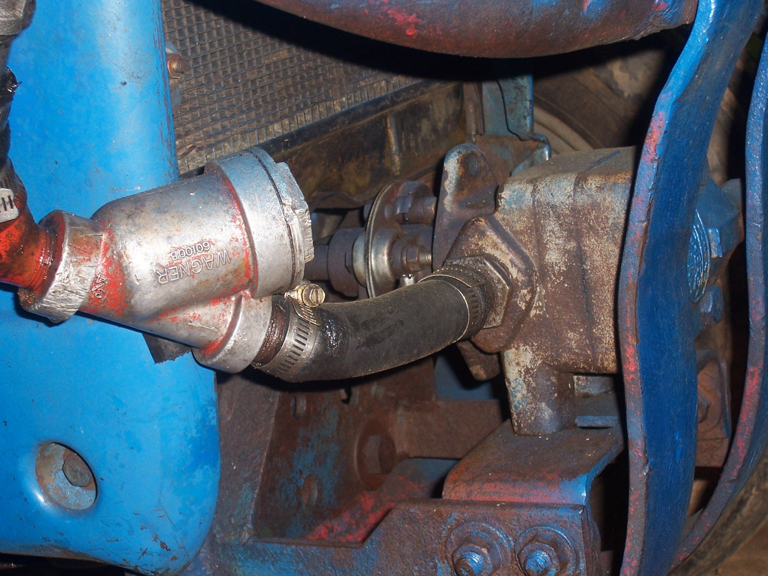

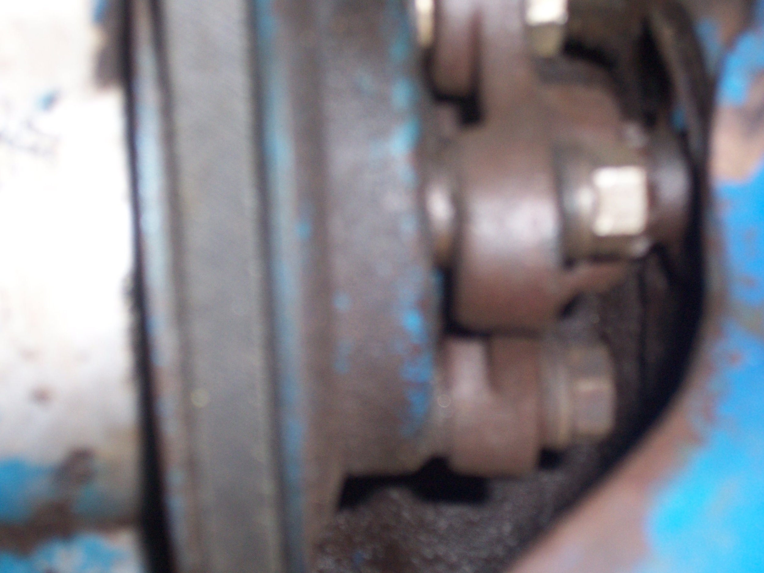

I run a Aux. Hyd. pump off the crank shaft pulley for a FEL.. On a old ford. If your blower is Belt driven a straight shaft should be easy to setup. Bolt a adapter to the Crankshaft pully straight to the blower Etc... Head and neck also so bad they Cert. me. Turning to look behind you is rough. I've thought of a mirror which I've seen factory option on a few old Yanmars!! See this Co. on here often.They have a complete setup I believe. https://www.steinertractor.com/FDS3748-Front-Hydraulic-Pump-Drive-Shaft

   / front pto kit for 186D #8
Not much to it. Wagner early 60's A handful of bolts 6 I believe and removes the whole all the FEL. intact. Same setup as Stiener. Then the Pto. would attach to it. JD. Blower setup Insert the main shaft then Attach the Quick connect Shaft. Then easily off for warm weather season.
