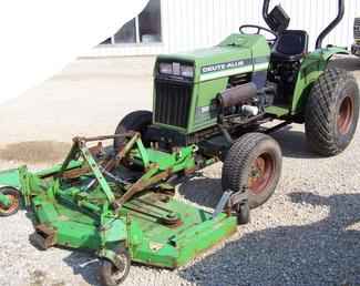

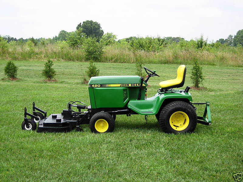

A front mount mower like one of these?

Yes just like that. I have one I made for my Bolens and like it so well I want to do the same with my B7800. The deck on the Bolens is just about had it. That JD sure looks like a clean set up. Lee
