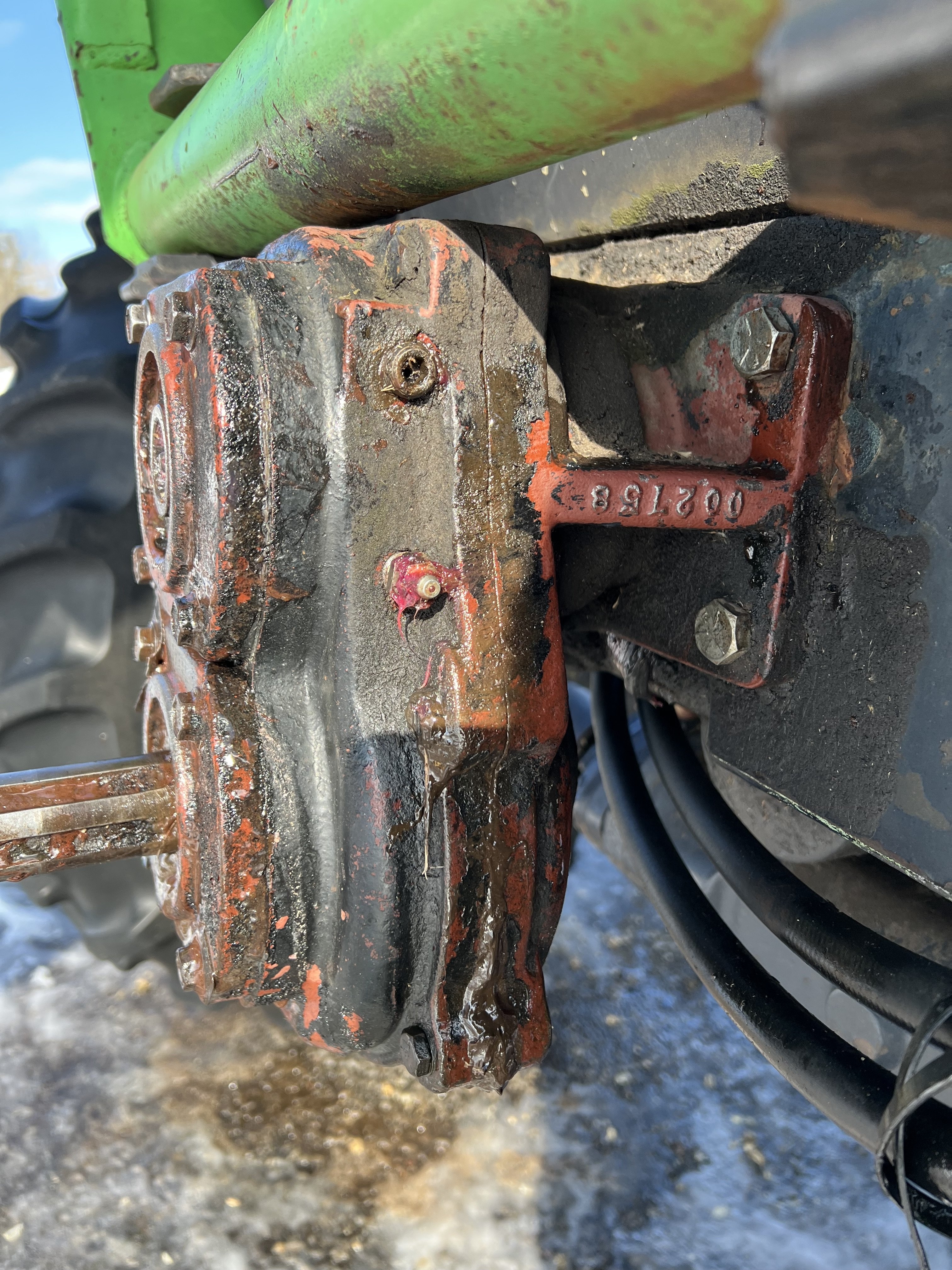

Deutz 6260
I have a Deutz 6260 tractor that has a front pro drive box. The gears in the box are damaged and Im wondering if anyone would have any idea who manufactured this PTO drive, or where I can get any parts ie gears for this unit. There are no names or logos stamped on the box except the numbers 002758. Photo attachedView attachment 2606027

I would start looking on the web for parts tractors, that front PTO may have been an option that was not common.
   / Front PTO drive #4
Looks these folks might be able to help, at least a starting place.

Thanks for your suggestions. followed up but no luck so far.
The bearings went month ago and I was able to find some to fit.
Now the gears broke some of their teeth & froze up the whole thing.
I just found a machine shop near me who will make me a couple new gears, unfortunately I think that’s the only option left.
Love my tractor it’s like a tank, saved me lots headaches over the 30 years I’ve had it. I sure subscribe to the - take care of your equipment and it will take care of you- Once again, I appreciated your suggestions. Take care!

Everything breaks and given enough time/money it can be fixed. I hope the machine continuous to serve you well.

Any chance of getting some "off the shelf" gears and then just have a machinist handle the bore? Should bring the cost down some, hopefully.
Seals and bearings should be able to be found easily on any bearing suppliers or similar.
