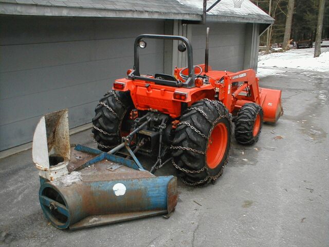

   / Front or Rear mounted snowblower? #7
Figured I'd throw this in to gum up the conversation. It is a rear-mount, pull-forward.
It works great - it's plow edges lift the snow even though the tractor has just driven over it.
This one was made by Snow Machines - others of similar design have been made by Erskine. Pronovost also makes a rear-mount pull forward model.
My neighbor has a 2500' driveway - his banks got too big to push back with his snowplow. With this rig I drove along with the FEL about 1' off the ground but sticking into the snowbank - the snow spreads down under the tractor and the blower comes along and launches it into the woods. Very effective.

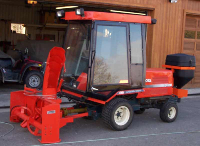

   / Front or Rear mounted snowblower? #8
I purposely bought a tractor with a front mount snowblower. This lets me mount a salt spreader on the back.
