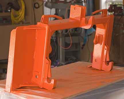

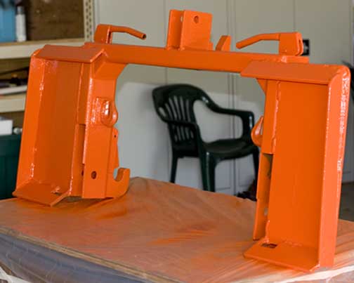

You really need to post some pics of all this, you lost me wayyyyy back in your descriptions. One thing I will say, pushing snow is extremely hard on equipment. With that in mind, you have your tractor pushing against your loader mounts, which are pushing against you homemade carryall mounts, which are pushing against your homemade blade mounts. Doesn't sound very good to me. Now when you angle the blade your throw in a whole new set of pressures.
Is your bucket quicktach??? I'm including a picture I saved of a great idea from someone here on TBN. I wish I could remember who built it and give them credit. Maybe they will see this and claim it.

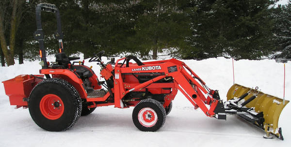

Yes, my bucket is a QA type. The guy who made the item in the pictures is apparently intending to use some rear mount equipment on the front of his tractor, too. Hanging the normal 3 point framework out there in front of the loader arms would seem to put it w-a-a-a-a-y out front though.
Again, I in no way want to take credit for these designs, but I'm including a couple more pictures I have found on TBN. These are very good ideas in my opinion for pushing snow with a loader frame.

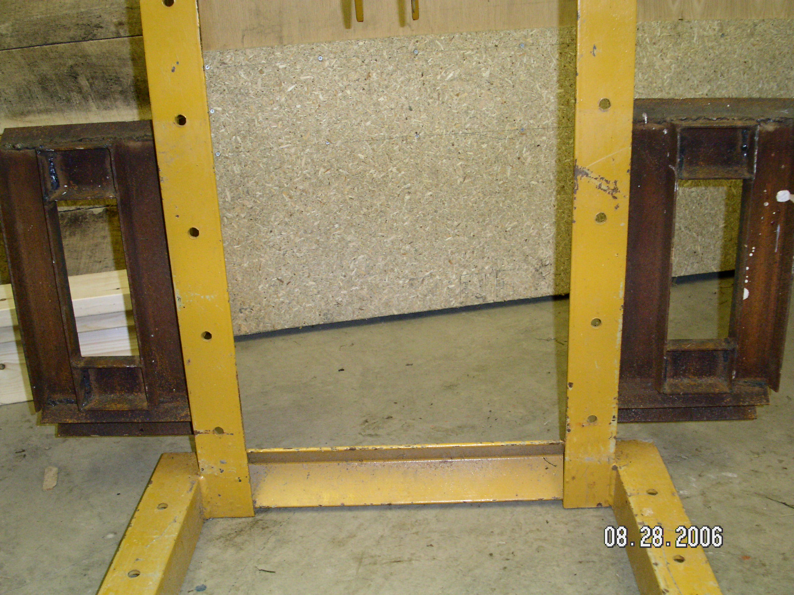

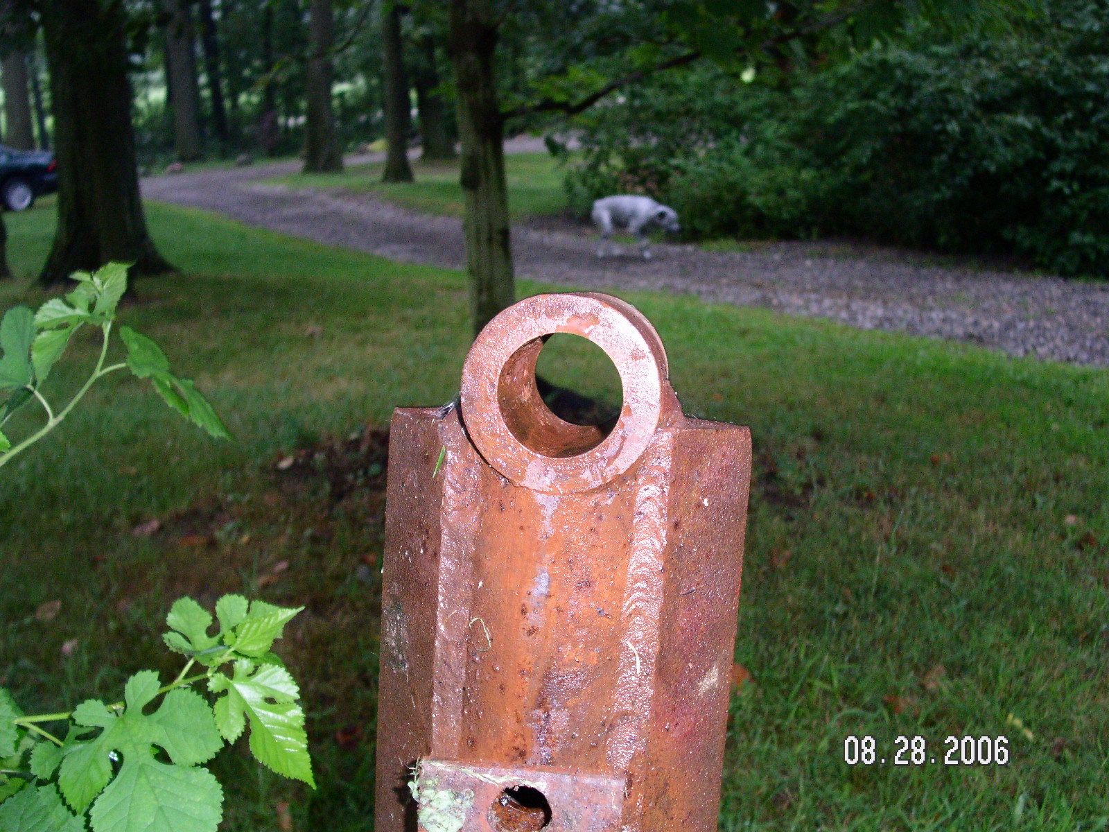

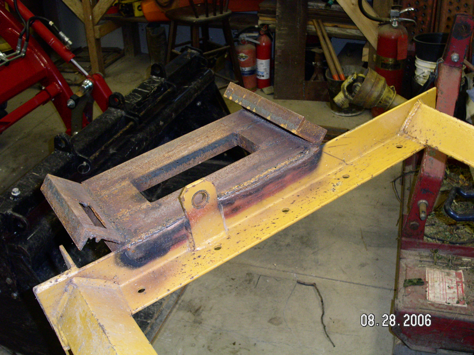

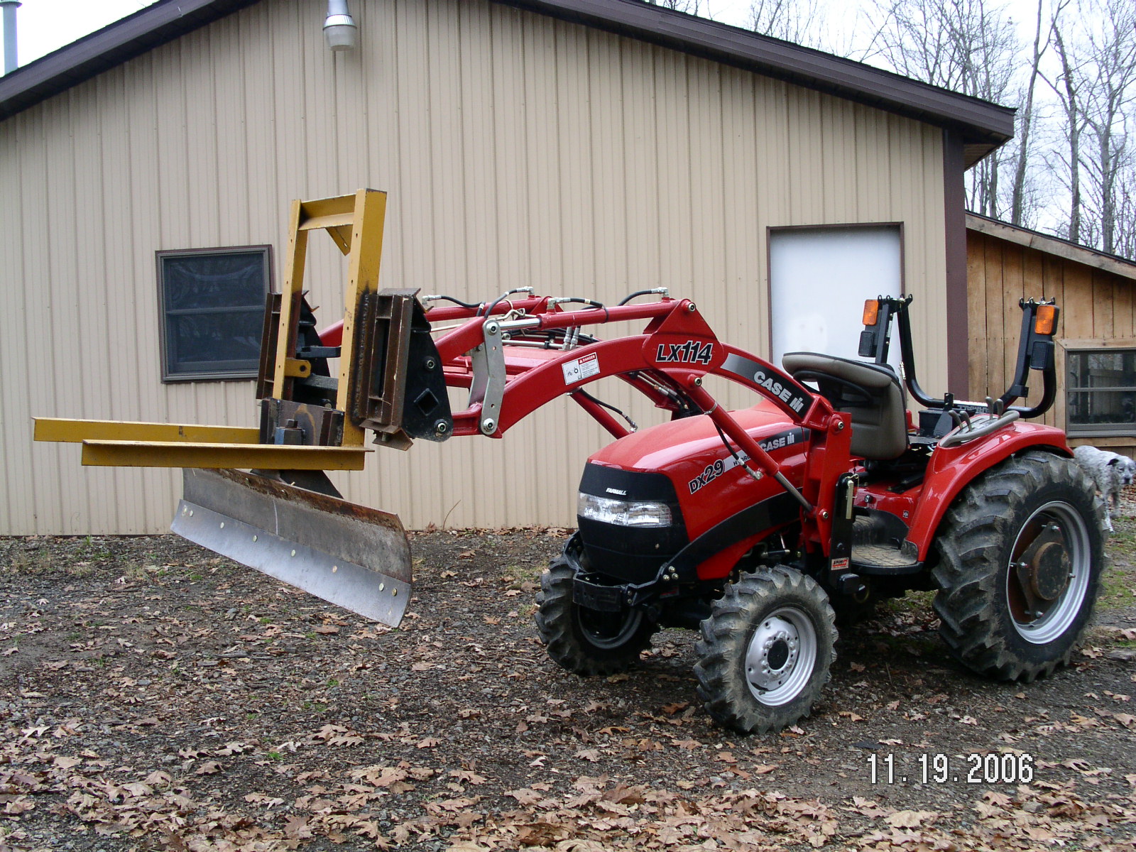

Okay, here are some pictures of what I'm planning to do.
The first one shows the attachment of the blade to the 3 point framework. The cylinder shown is 3" in diameter, 4" tall. The hole is 1 3/4". The blade pulls against this point and pivots in the hole.
The next two show the side plates I've made up and connected to my carry-all. They're made from 3" channel steel, are approximately 16 inches tall and 11 inches wide. They fit the QA plates on my loader arms perfectly. The angles at the top and bottom are 45 degrees, which I believe is an industry standard.
The final pic shows the carry-all frame with QA plates attached. The crossmember at the bottom will be just behind a 1/2" thick x 8" tall section I plan to install. The piece of angle iron showing will be backed by a full width box section made up from more 3" channel.
The outsourced piece that will be the actual mounting point for the blade will be 4" tall, 3" front to back, and at least 3" wide. It will fit in the center of the 1/2" plate in front of the bottom crossmember. I can have it made about as wide as I want, but the original application was only 3" wide. I may just weld some more channel side to side from this piece to the arms of the frame.
As I see it the weakest spot will be where the QA plates are welded to the frame. The welds are not pretty, but I'm pretty sure they have enough depth. Each side has about 40 lineal inches of weld holding it in place. I could place another section (or two, three, or four) of 3" channel across the front of the whole rig if you guys think it's needed to keep the plates from bending forward when I push this rig through the snow.

Good morning Sir.
After reading your post number of times also looking at the pics I think I know what your trying to do.
As stated in a post pushing snow w/loader arms can put strain on...more so if the if its a heavy wet snow.
Do you plan on plowing much w/your blade at 45 degrees?...I feel more comfortable having two pressure points (plow frame & corner of bucket) instead of one when plowing at 45 degrees w/full blade of snow.
"me to mount my 6' rear blade to it."...does your snow plow blade have trip springs,for theres almost nothing worst than hitting frozen object etc very hard on equipment while pushing snow.
Not knowing what kind of tractor rear thread you have,maybe a good set of tire chains well help when pushing a full blade of snow??
Do keep us updated...very interesting.

I will probably always have the blade angled to one side or the other. I have Ag tires on the tractor. The point about the spring mounts is well taken and will bear some thought. The driveway shouldn't have large obstacles in it.
My loader can be set so the bucket "flops" or is not held in position by hydraulic pressure. This may or may not work in lieu of springs with the blade mounted. I shall see.
It has been my experience in plowing snow with this blade mounted as a rear 3 point blade that there is plenty of traction and power most of the time. When we do get deep snow, and I had my Kubota B7100, the tractor would tend to be pushed sideways as I drove along dragging the snow. In those situations, I simply used the front bucket to pick the stuff up and move it. I have also mounted the blade from the Cadet to a bolt on arrangement in the bucket of the Kubota with great success, but that blade is only 3 feet wide. It was also very hard to see the blade hanging way out there in front of the bucket. As a consequence of that fact, I did hit something and broke the mounting system, although I don't remember the exact nature of the damage. The blade still works, though.
I have found that my little Cadet 109 with a 12 horse engine and chains will handily move our amounts of snow with a front mounted blade. It worked so much better than the Kubota that I used the Cadet most of the time.
Since getting the new tractor (DX29 with QA loader bucket), it occurred to me that I could relatively easily convert my carry-all to function as a mounting point for the blade section of my 3 point rear blade. By building it this way, I can remove one nut, reinstall the 6' blade on the back of the tractor, then put the bucket back on the front if the snow gets serious.
