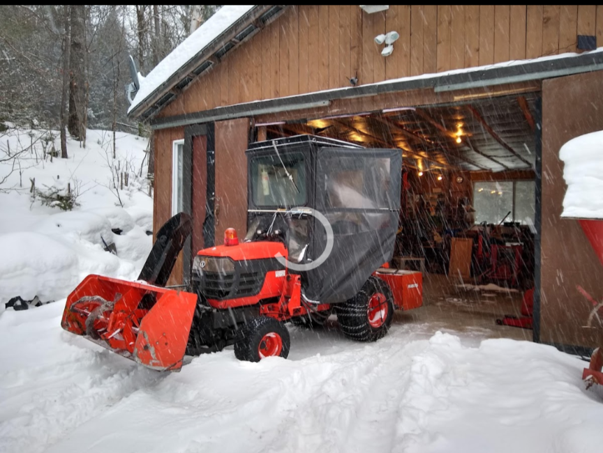

I bought a 2750d new and for 10 years have run it on my 2001 bx2200. It is barely robust enough for my application but I just repair as I go etc. is the 2781a better? Stronger, thicker steel, no chain to stretch, and will it slide onto the same mounting system? There's one for sale near me and I was thinking of buying it and selling my unit. Also is there a reasonably priced replacement chute control system out there,? Thanks!
   / Front mount snowthrower (B2781A, B2782) #9
B2781A is a much beefier unit.
However it does have a #50 chain that doesn't require much adjustment.
The subframe is not exactly the same,but imagine it could be made to work.
The OE parts most likely exist to mount that blower to a BX.
Chute rotation-some operators mount power window motors for the purpose.
Good Luck!
