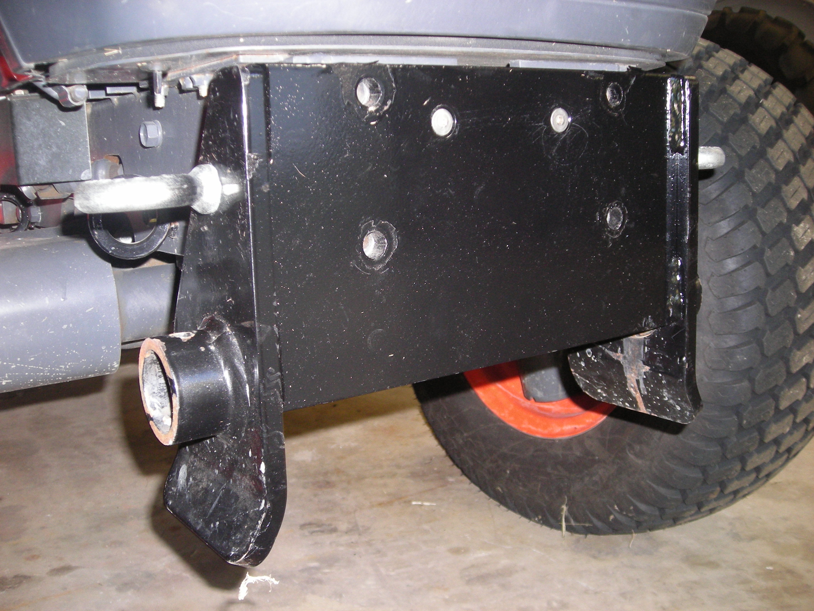

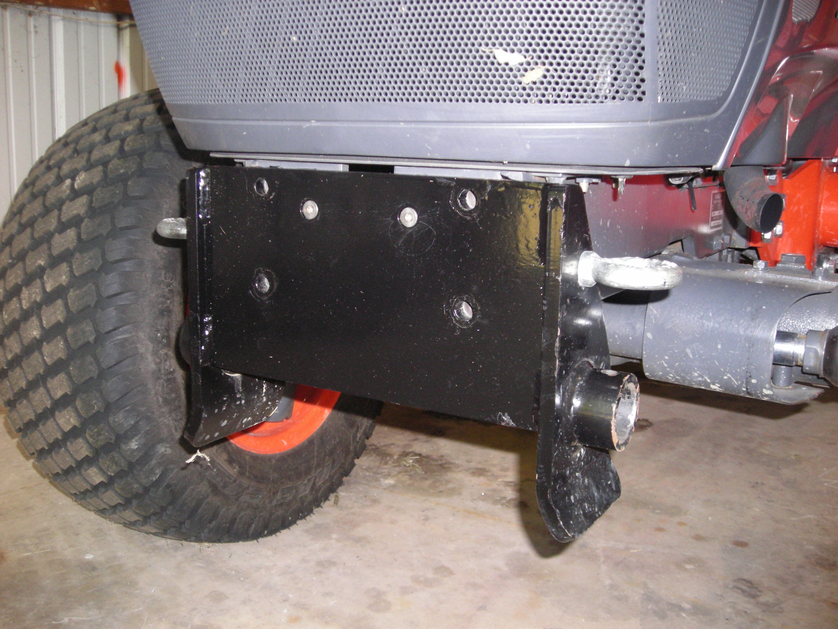

We are talking L series versus B series. My subframe is full length of tractor, have to remove drawbar, 2 mid pins, and 2 front pins. Not as easy as one would think. The up and down cylinder is double acting with seal off connectors, if it leaks down, you got problems. Philip.
   / Front mount snow blower questions #10
The front mount for the subframe mounts to the same place as the grill guard so you can only have one or the other.QUOTE]
Thanks for the reply. I can mount my front bracket and grill guard at same time (don't have pic though). If you look closely at pic, I mounted bracket (with tractor/trailer tie downs) with counter sunk screws so I do not have to fight bracket when I mount grill guard (personally, I do not like looks of grill guard, usually only have it on when I am doing loader work that could be damaging). If I only have bracket on, I put bolts into bracket. Philip.
