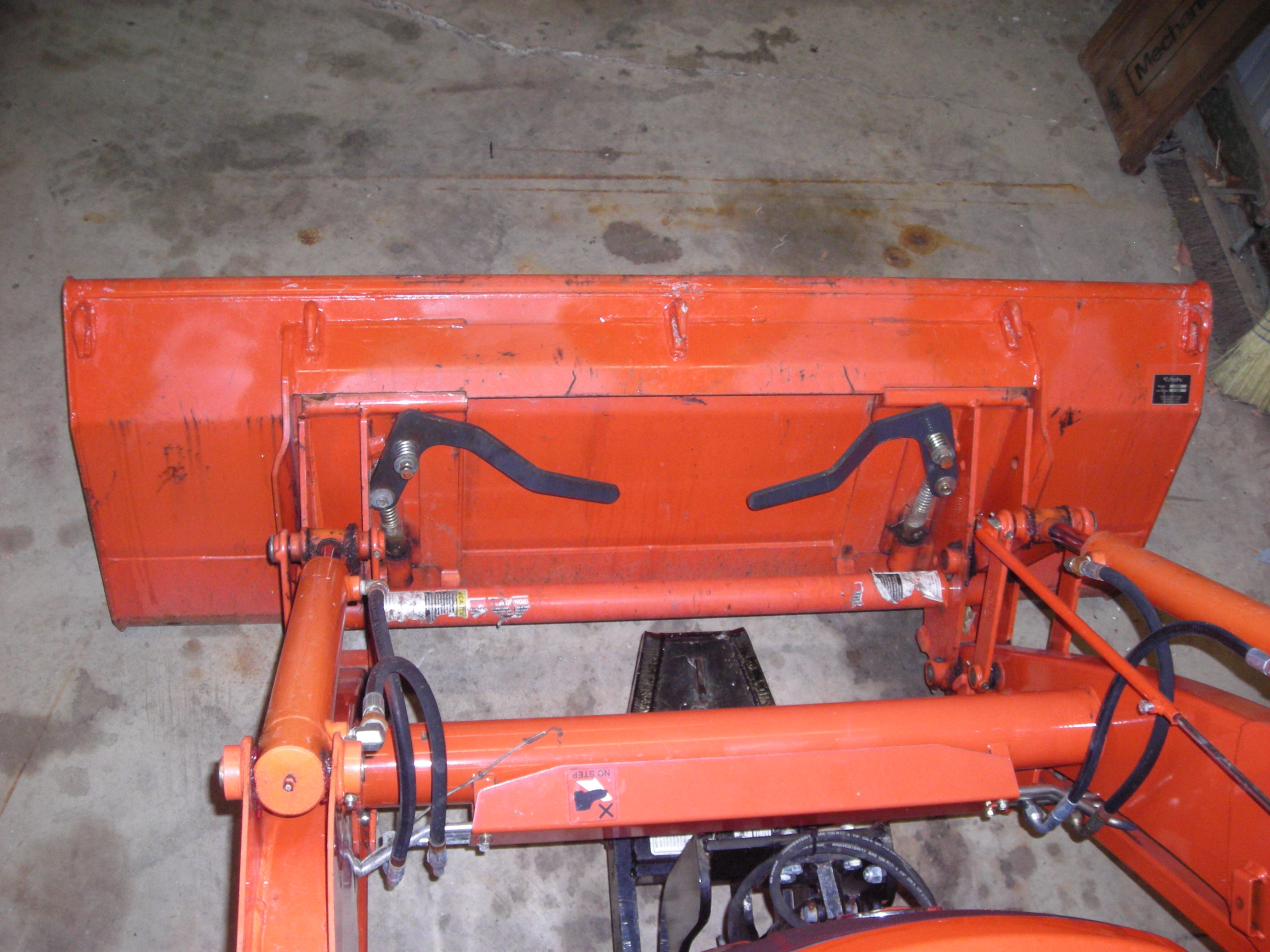

I have only owned my B3200 with FEL and front mount Kubota snow blower for 1year. Last year was a joke for snow fall in Upstate NY. I saw picture of FEL and blower mount on at same time! Can you mount and use the FEL with the blower mount attached?

So you want to drop the blower, but leave the quick hitch on when you install the loader?
If its like the quick hitch for the BX2660 and the loader for the B7500, you should be able to. I would try connecting the loader with a "Spotter" to watch for interference.

Yes, that's exactly the question. With the hydraulic lines reattached to the FEL, and the quick attach for the blower left on, is there enough room to fit and operate the FEL? I don't have a garage, and lying on cold/ wet winter soil or gravel to get under and line- up, attach and unattach the mid mount PTO, especially in the early evening darkness just isn't much fun! I have work to do that needs the FEL, but now that the Kubota is snow ready, I dread changing the attachment!

Okay, think I got ya. Leave quick hitch on without blower. Have full function of FEL. Remove complete FEL assembly, then just mount blower. That varies model by model. On my L3940, the quick hitch interfers with my bucket. Another guy on here has a L4240, he can leave his quick hitch on, and have full use of his FEL. Might also depend if you have quick attach bucket on FEL. Good luck. Philip.

While I can leave the sub frame on the front of the sub frame quickly becomes kind of an issue. It doesn't interfere with the loader but it sticks out so while doing loader work you can't get anywhere near as close to a pile of snow or dirt. If you are using the FEL to pile snow it will dig into the pile. My suggestion is to get use to putting the sub frame on. My first time doing it was an hour or so but yesterday I did it for the 4th time and I bet it took 5 to 10 minutes at most.

I have a B7500 and found the same problem with the subframe installed and using the FEL I was able to damage two of the hydraulic lines attached to the support arm of the FEL. Turned out that the hydraulic fitting on the subframe lift was just at the right position to hit the two FEL lines. I replaced the lines and the first time I used the bucket is when I found out what damaged the first set. I was lucky enough to not destroy the second set.
I attempted to use the blower with the FEL still attached, but just did not like the setup. I had a feeling that the bucket could come down and hit the blower chute. PLus the bucket is high enough to blocking vision while driving. The same two hydraulic lines to lift the buck are used to lift the snowblower.

Crazyal is who I was thinking of! Look closely at his picture. He has subrame for his blower mounted, and his FEL. You can just see the end of his quick hitch sticking out from the front of his tractor. He can do that with his L4240, I cannot with my L3940. I mounted both of mine too, but at some angles, there is some interference between my bucket to my quick hitch. Philip.

Our quick hitches are the same. I think the difference is in my LA724 loader versus his larger (longer) LA854 loader. Philip.
