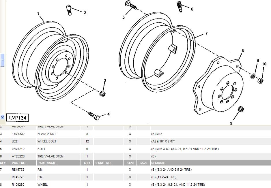

Does someone know the front lug nut size on a John Deere 5420 front wheel?

Here is what jdparts shows for the 5420. Does it look like what you have, and answer the question?

That is what I am looking for, thanks! Do you have a link to the john deere parts? Cant see the lower #s
   / Front lug nut size #4
Which item numbers are you needing? Item #3, the M18 nut is 14M7332
Appears to be two different rim assemblies shown.
And I can give you the numbers shown. Also, you can go to jdparts and with a free registration, have the same access to any JD model of their full line back into the '30's.
Glad to help you if there is a problem.
