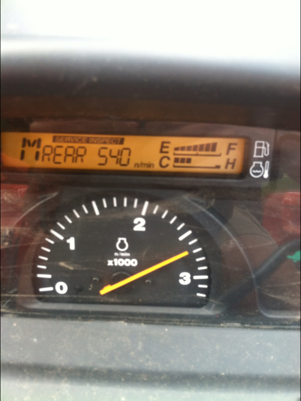

You have to run a full pto rpm to get full flow, but my loader works normally with the tractor just idling. It just operates slowly. There is hardly any difference in the speed at 2200 rpm vs full rpm of 2700. image-3790828102.jpg

You have to run a full pto rpm to get full flow, but my loader works normally with the tractor just idling. It just operates slowly. There is hardly any difference in the speed at 2000 rpm vs full rpm of 2700.
I suspect you have restrictors in the loader.
Logic says that you should have more flow at higher rpm, and therefore more speed
