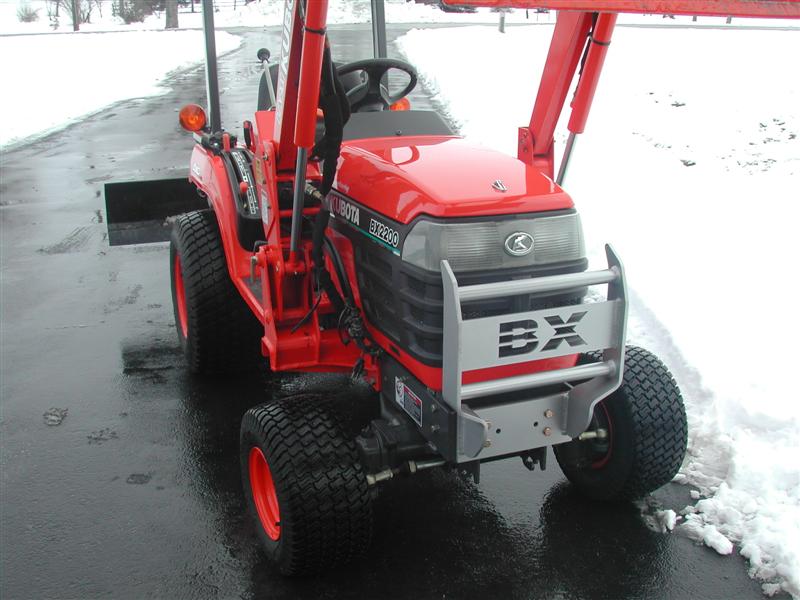

Yup, I did it! /forums/images/graemlins/cool.gif I wasn't the first to do it though, so I can't take credit. Bought The BX22 brush guard and it works fine, with or without the FEL. You can remove the engine cownling with it on as well, even though you have to wiggle it around to do it. I'm very happy with it, I push things around all the time with it! /forums/images/graemlins/grin.gif
