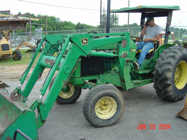

There should be quite a few JD loaders that will fit the 2555. I think the JD 245 self leveling would be the best if you can find one. The 520, 540, 521, 541 and 175 should also fit along with the 522 and 542 already mentioned. Auctions at dealers seem to be the best way to find loaders in my area. The older JD 145, 146, and 148 would also fit with a little work. You may also want to look at the aftermarket like BushHog, Woods, Quickie, and the like. This may be easier in the long run. I will try to post a picture of the JD 245 and I have quite a few pictures of others if you like. PM me if you want some more pictures.
Good luck,
Russ

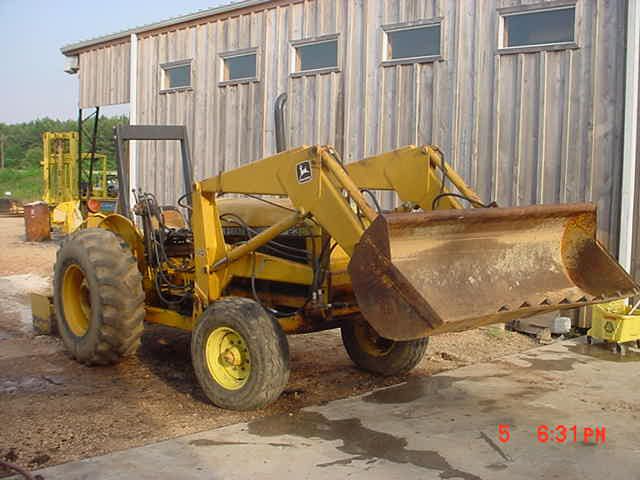

I forget to mention a JD 110 should also fit. I will attach a picture.
Russ
