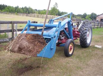

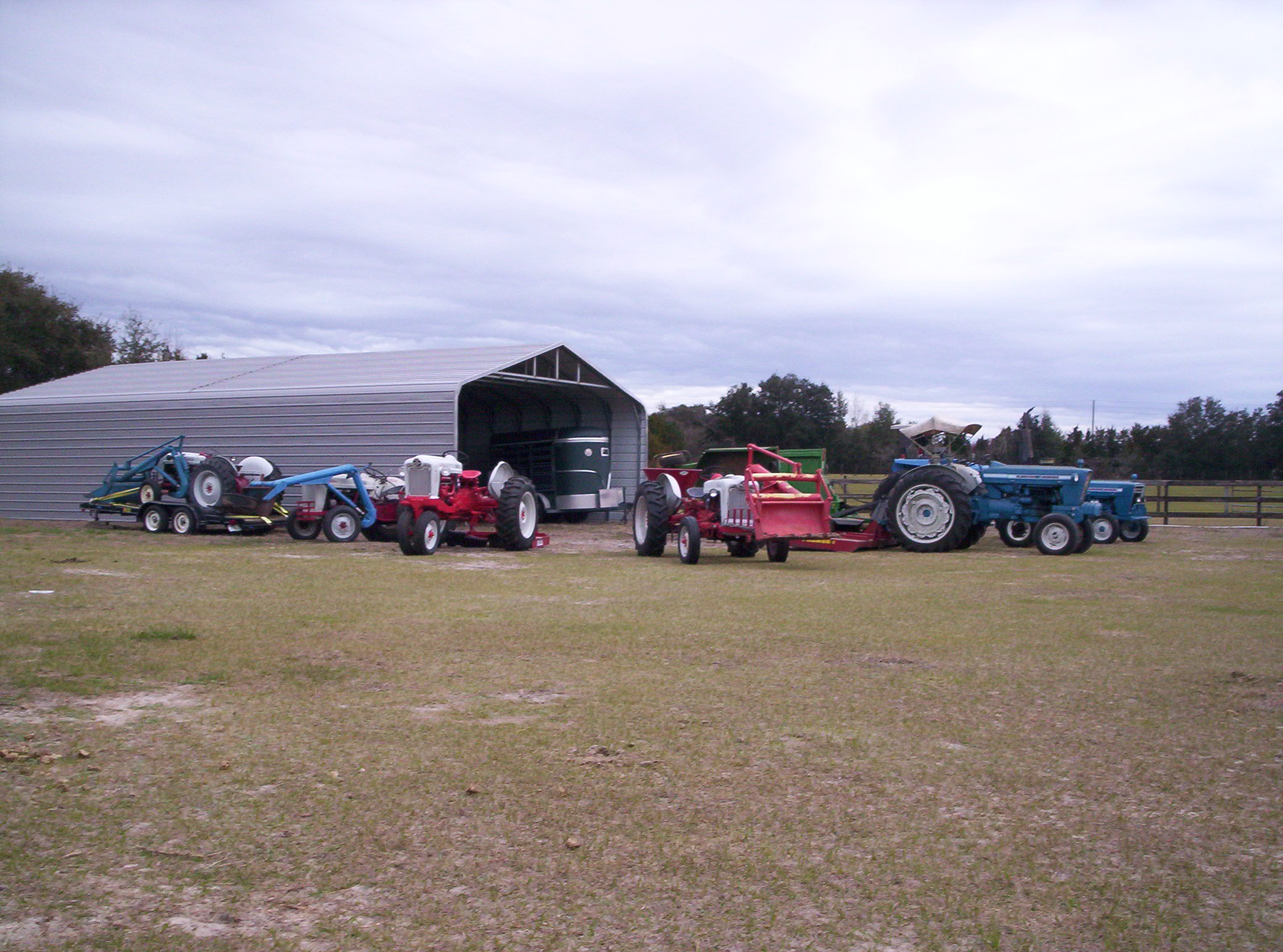

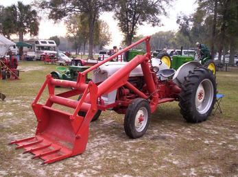

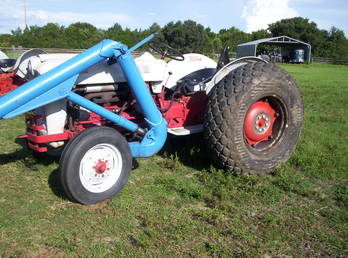

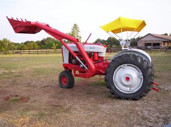

about a quarter of my olf fords have ford 711 or 722 1-arm loaders.
depending ont he model, they have 2500 breakout and 1000# lift to full height, or 3000# breakout / 1200# lift.
I do have a heavier 2 post superior loader for stuff up to 2000#, but did alot on those 1-arm jobs. even moved round hay with them.
they are easy to put on.. can hang one in 15 minutes once the brackets are bolted on.
the trip dump models only need a SA hyds connection and cost about 75-150$.. the full hyd models go for up to 400$ both with brackets.
on the trip dump model, you can remove the plug from the 3x5 cover under the seat.. put in a 90' pipe adapter then run a hose over to the loader.. chain the 3pt arms down tot he axles and put a counterweight back there.. then use the lift control to move the loader.
that's the cheap n easy way. there are other more usefull more expensive ways using a selectrol diverter valve, or power beyond plate, or a top cover remote.. with prices that run 100$ to 200$.. for the valve.. plus extra for hoses and adapters..e tc.
here's a few shots of some of my tractors with different loader configurations.. and some non loader 'family' members.
