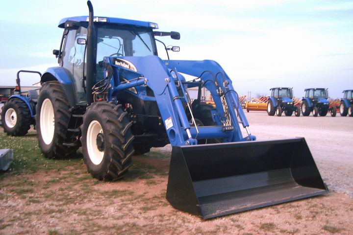

I'm including a picture of a TS100A and 56L loader I took in 2004. That is truly a massive tractor by most of our standards.

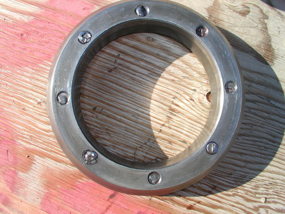

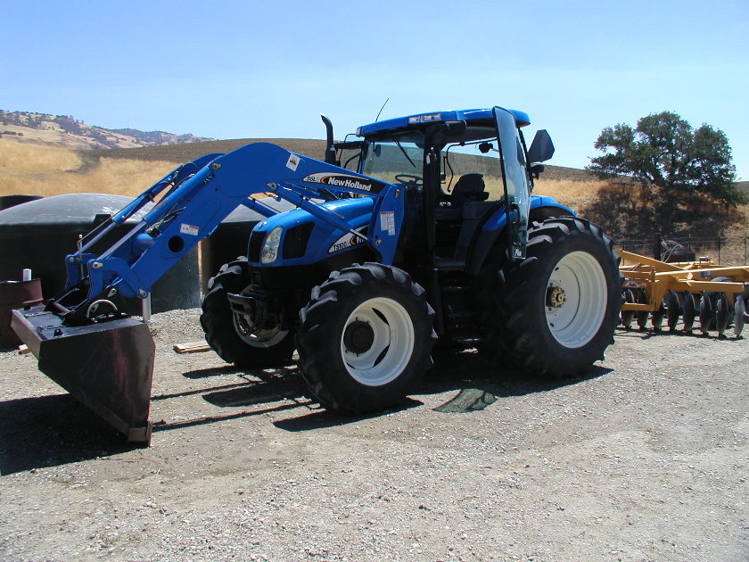

Yes I am very dissappointed with New Holland, to crack 3 hubs on the right front is not right. I took good care of my tractor, when I sold it, it only had 740 hours on it and still looked new. The last time I had it repaired I hired an independent mechanic to work on it, who had worked for the local dealership for several years. He knew of the problems with the front axles and when he was done with the repair he told me to go right in and call that guy that wanted to buy it and get rid of it. Sad but true. Without the frontloader on the machine I might not have had any problems. I remember when I ordered the tractor I told them that I wanted a front loader on it, they asked me if I wanted the light duty or heavy duty one. I told them I wanted the heavy duty one so they were aware I was going to be using the FEL.
Anyway type in "new holland front axle" in your search engine, I use dogpile.com, and you will find a NH media release article. Very interesting, they talk about beefing up the front ends on the 70-96 PTO HP tractors. Hmmm, it sounds to me like that they knew they had a problem. Attached is a pic of my TS100A with the 56LB loader along with the bolts that sheared off in the front differential.
