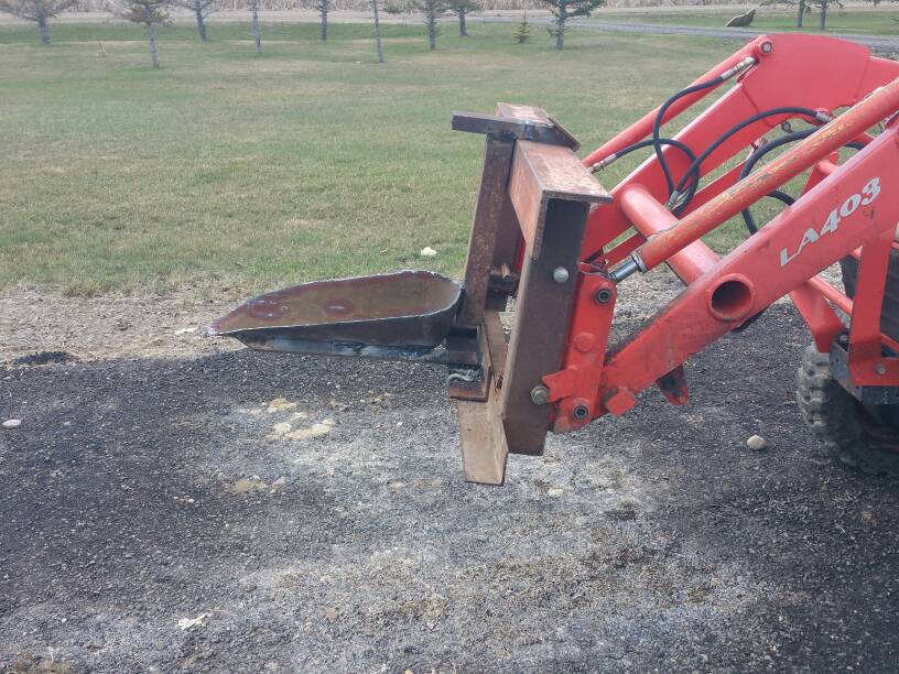

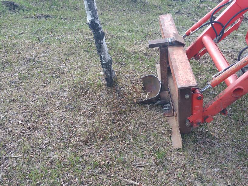

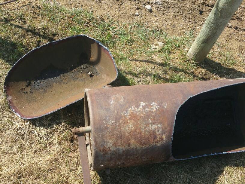

Here is what I made in 5 hours out of scraps I had laying around. I used a drum roller I haven't used in years for the scoop. I also have a homemade attachment I built for forks but I had a lot of difficulty finding strong enough forks. I decided to make the spade detachable. I can easily drive up to it and scoop it up then add the two bolts to keep it in place. I also wanted to make it so I could slide it a foot or so either way if I got into tight conditions. I tried it out on a 20 foot poplar in my pasture and an ant hill
(something I didn't think of head of time) and it worked great. I think it should get enough roots to lift out a four or five foot tree for transplant.
   / Front end loader homemade small tree transplant tool
I'm happy with the results. 20180512_104555.jpeg20180512_161058.jpeg20180512_161553.jpeg
